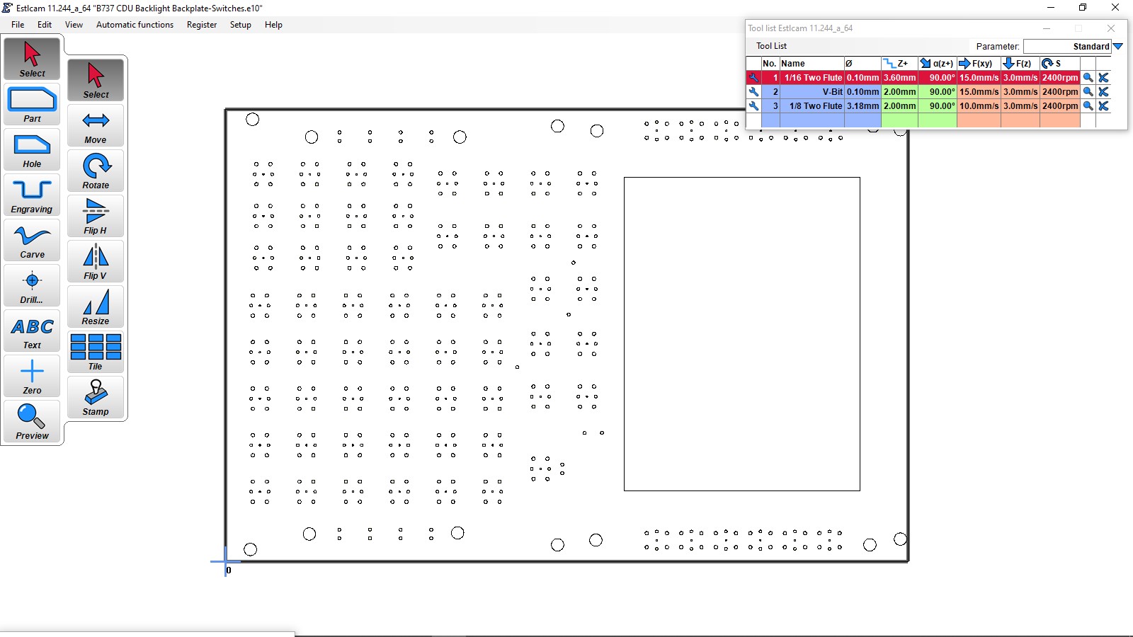

I finally got everything working. I was using the Estlcam Drill option to cut holes in 2mm acrylic using the 1/16" double flute bit.
35 holes). These were to mount lighted tactile switches for a Flight Management Computer. I got one piece done, dropped it and broke it. I started another one today but my last two flute bits broke. I don’t understand why this is happening to a new bit.
I was also having a lot of trouble with the acrylic building up on the bit. I was having to clean it off with an xacto knife. These are the settings I used for the cut.
Maybe it would be better to use a standard 1/16" bit.
