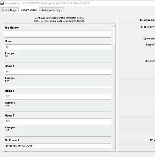

in mill mage would i put the below in the job header ?
G21
G90
G94
G10 L20 P0 X0 Y0 Z0 (set current location to zero, survives reboot)
I’m not familiar with mill mage but I would guess yes. You can put it in the job header, have it generate a program and then open it with notepad to check that it at the top before the program itself.
