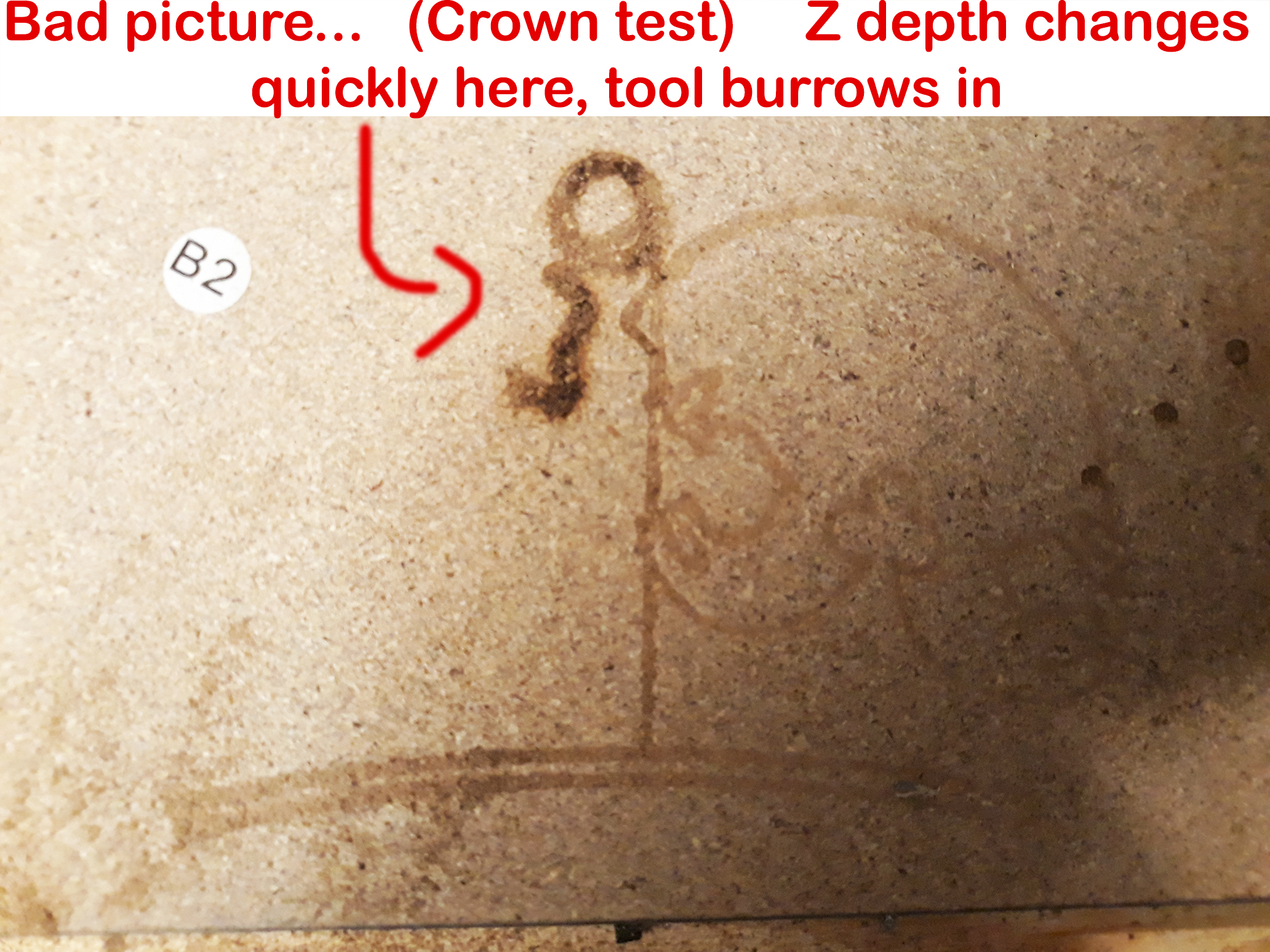

The symptoms:

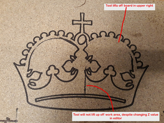

Finished building and wiring my machine, and I have run the crown test with both pen and router a few times. Invariably, when running the crown test file (also tried another test file), the Z axis gradually creeps up or down–sometimes it begins carving/drawing into the air, other times it buries the pen/router into the board. There is also one part of the tool path where the Z axis refuses to lift the tool off the work piece, and just drags a straight line across–see picture.

I spent some real time making sure the machine is square, and have checked to confirm. The behavior is repeatable at all positions withing the 2X2 work area, leading me to believe the issue can’t be due to leveling (picture below to see what I mean).The issue is also repeatable using at least 2 software (bCNC and Universal GCODE Sender) with two separate test files (Ryan’s crown file and another).

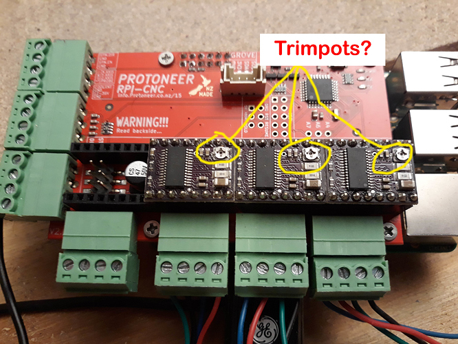

I used to use that controller and I really like it. Make sure your driver’s trim pots are set right. If you don’t have enough current it can cause skipped steps. Too much and the driver can overheat, which will shut it down until it cools off.

  • Setting trim pots on driver… I will look into this. Admittedly, this is my first go at working with RPi or similar boards. Taking an educated guess here, that the adjustment is done with these small screws, circled in yellow? I’ll do some research on how to check and adjust.

Those are drv8825 drivers and you’re trying to adjust the current. That will help if you are trying to find a guide. But basically you want everything powered up and energized. You want to be really careful not to short something, and you want to measure the voltage between the top of the screw and ground. Turn the screw slowly until you get about 0.7V or a tad less, 0.675V. If these aren’t set, it would explain everything.

Also worthy of note that the DRV8825 trimpots are backwards, so to speak, as standard thinking would suggest. Clockwise turns the current down, and counter-clockwise turns it up.
Guys, thank you so much for your advice, I am thrilled to have it working now. I had to adjust the trimpots to 0.67-0.68 as they were all set at like 1.5 ish. Then, went used GRBL set the XYZ steps/mm. They were all at default 250, so X & Y were moving too far, and Z was moving too little. For XY, 200 steps/mm was right on the money. I did some testing and algebra to come up with Z=770, as 800 wasn’t perfect.
