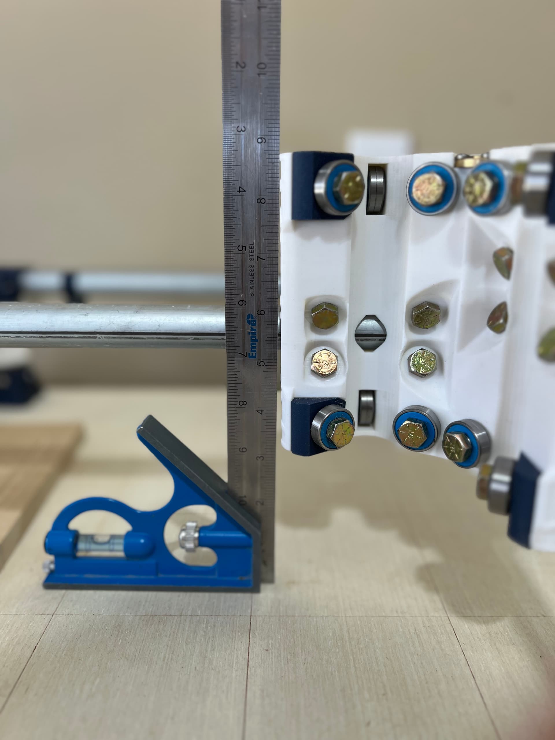

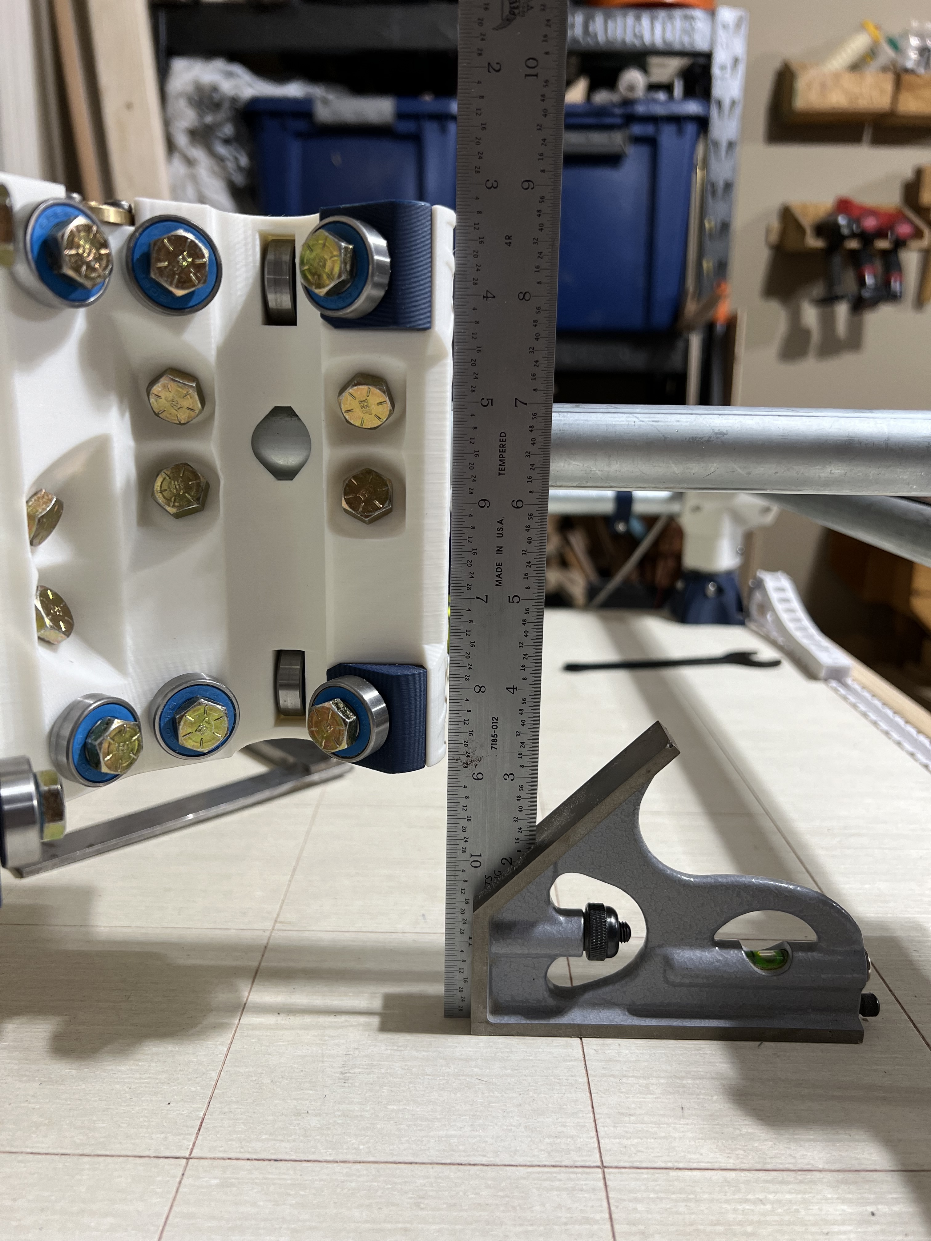

I walked out into the garage today to cut some things on the MPCNC (big thank you to the community! Lots of fun using it so far) after not using it for a month or so. I noticed some significant sag in the z-axis which is no longer anywhere near perpendicular to the bed. I took the core apart and reassembled several times but can’t quite figure out where the problem lies. Even when partially assembled (without the weight of the z rails or router) it’s out more than 1/8" over the length of the core on both the x- and y-axis. This is WAY more than I can reasonably shim in the router mount, etc.
In the attached images the core is solid, all bearings touching but not too tight, no play, moves well in each direction…just nowhere near square to the bed. The machine lives in an unconditioned garage and I live in the southern USA so it can get REAL warm in there. Wondering if the mixture of heat, plus weight of the router caused a bit of creep in some parts? It definitely hasn’t always been like this.
There isn’t anything obviously wrong with any of the printed parts. No cracks in the core clamps, no cracks or warping of the core, etc. I’m kinda at a loss how to troubleshoot next without simply reprinting all the core parts. Which I can do, but as you all know takes a while and a fair amount of filament. I’d rather avoid that if I’m missing something obvious.

I think weight may also play a factor in the process that may cause warping as opposed to sagging or melting. Best way I can think to test the theory is to measure the height at the corners and make sure you’re still level there. Honestly, just removing it from the gantry to see if it sits level on a flat surface might be diagnostic enough.
If all of your other measurements come up, then maybe print a new core (last resort) in order to validate the difference. Like you said, there’s not a whole lot you can shim or adjust out at that level of difference.
As you suggested, I took the core off completely and laid a square on each side. The bottom definitely was not as flat as it was when it was printed. So the core must have warped.
I’d read the same about the PLA transition temperatures and figured it wouldn’t get THAT hot in the garage. So must have just been from the weight.
I used the suggested 70%/30%/70% infill percent. But looking at the saved print file looks like I only used 3 outer walls. Maybe I’ll double the wall count to 6 for the next try?

Put the newly printed core (70% infill all the way through, 6 walls…nearly 500g of material…lol…it’s hefty) and new core clamps on tonight. MUCH better now. Back to what it was like when I built it.
