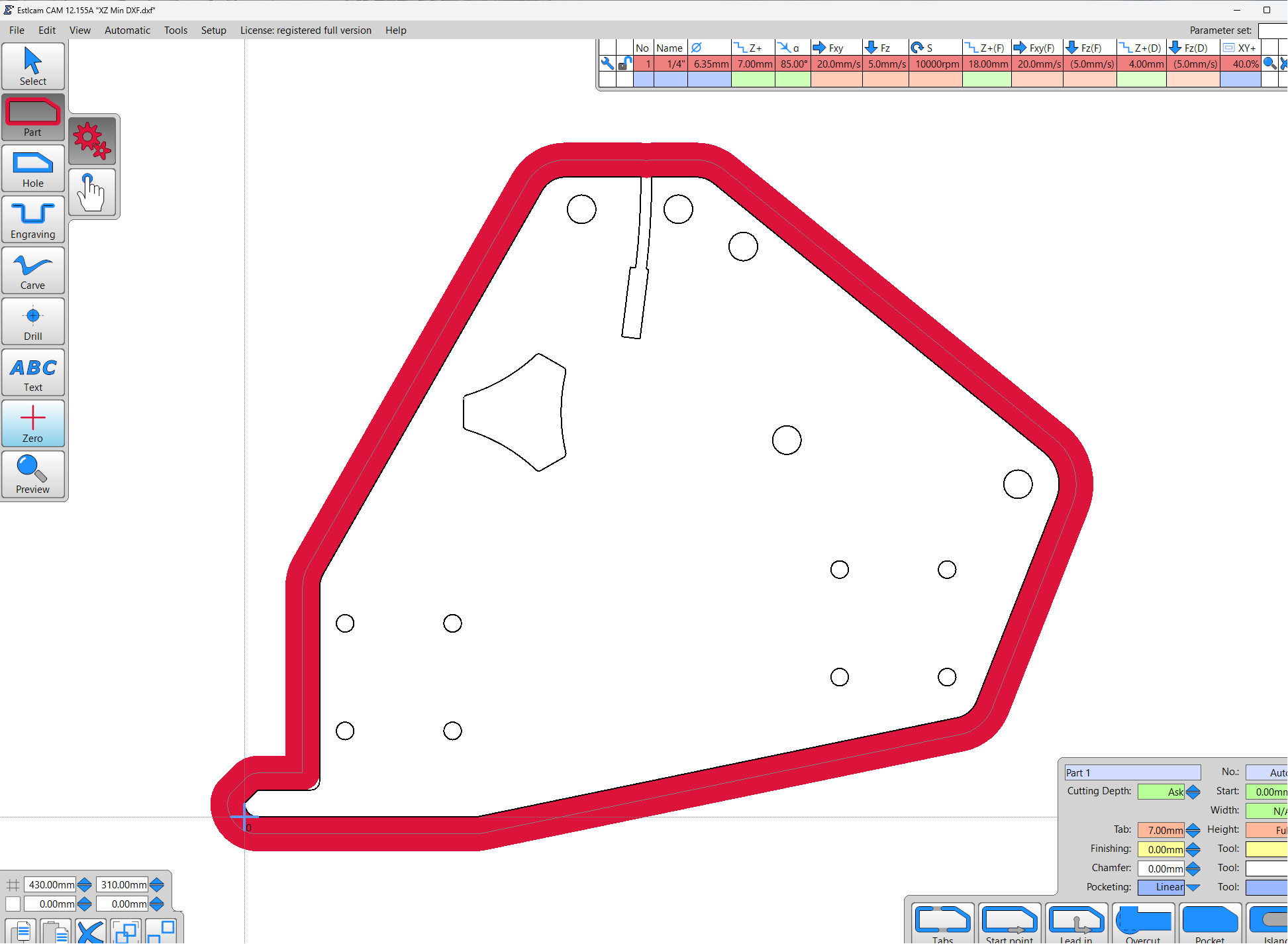

Greetings from Slovenia. Today I wanted to cnc YZ_Plate_Min. I have a problem with the file that I load into artcam 2018 and edit the settings. The g code is not executed because it has dxf errors, which I can’t fix. The problem is in the external lines. Can I get a corrected dxf file? Thanks

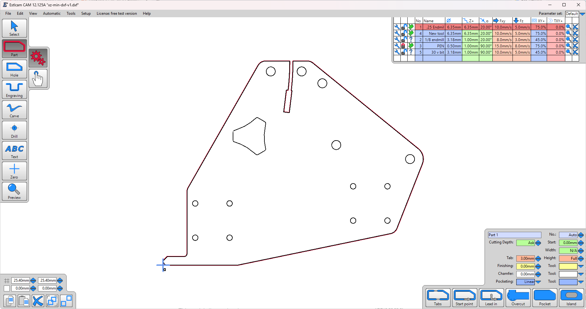

Just generate the goods with Estlcam, it’s free. :slightly_smiling_face:

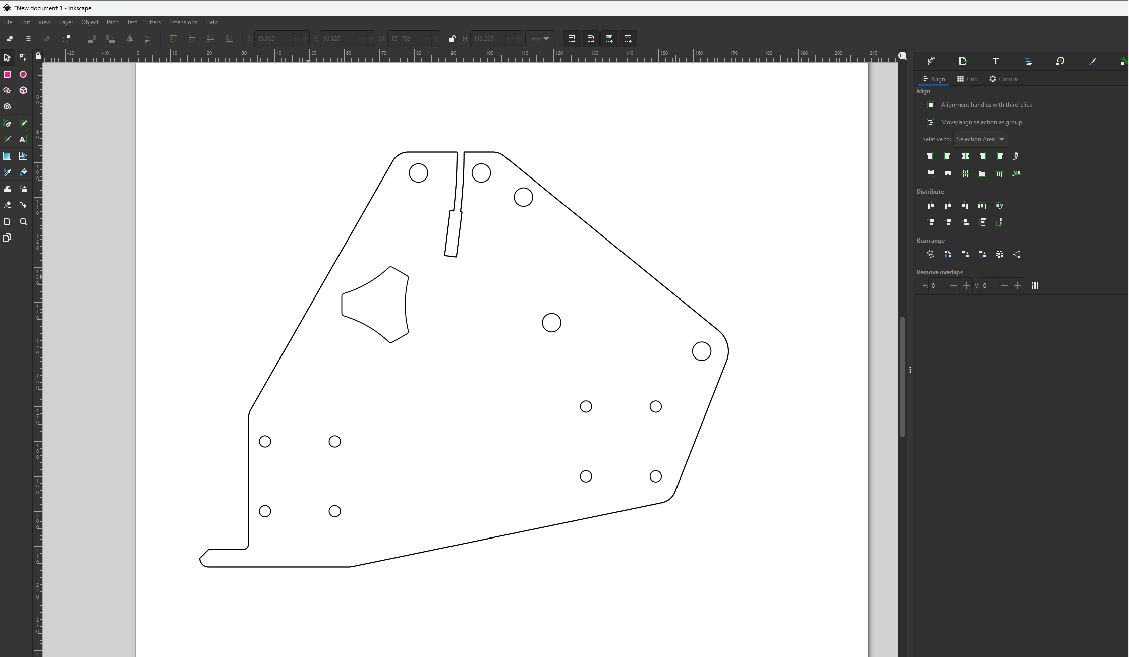

I saved them as an SVG for you. Compare the size to the dxf to make sure they match.
Hopefully this will work.

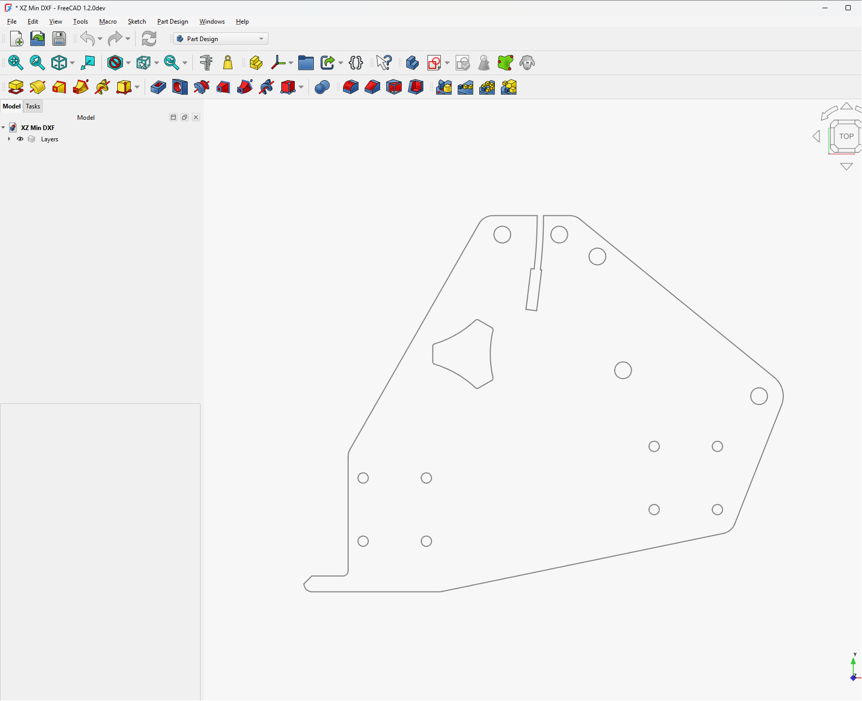

Try importing it into FreeCAD it’ll flag the errors
At least one of the paths isn’t closed

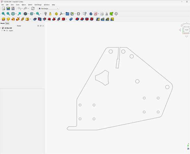

Well shoot I did not have any issue there either,

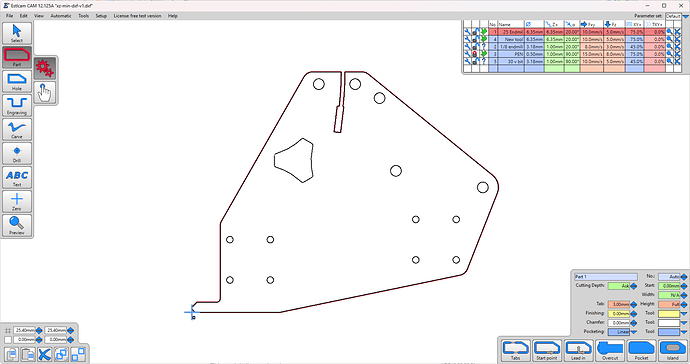

I will upload a new version if you guys can test it. I will label it with “v1”
It’s up on Printable’s if you guys could test I would appreciate it.
Works for me

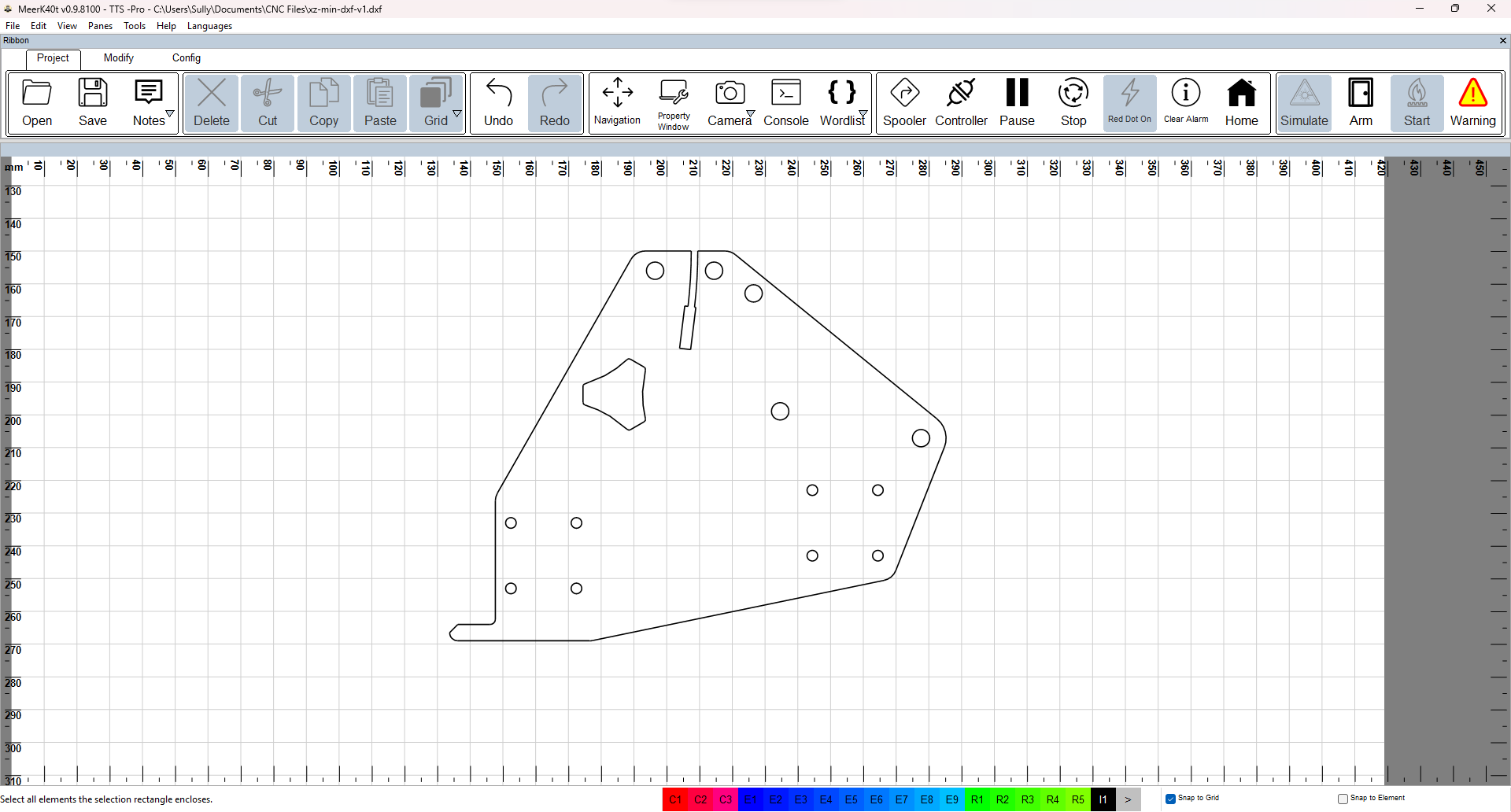

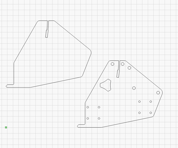

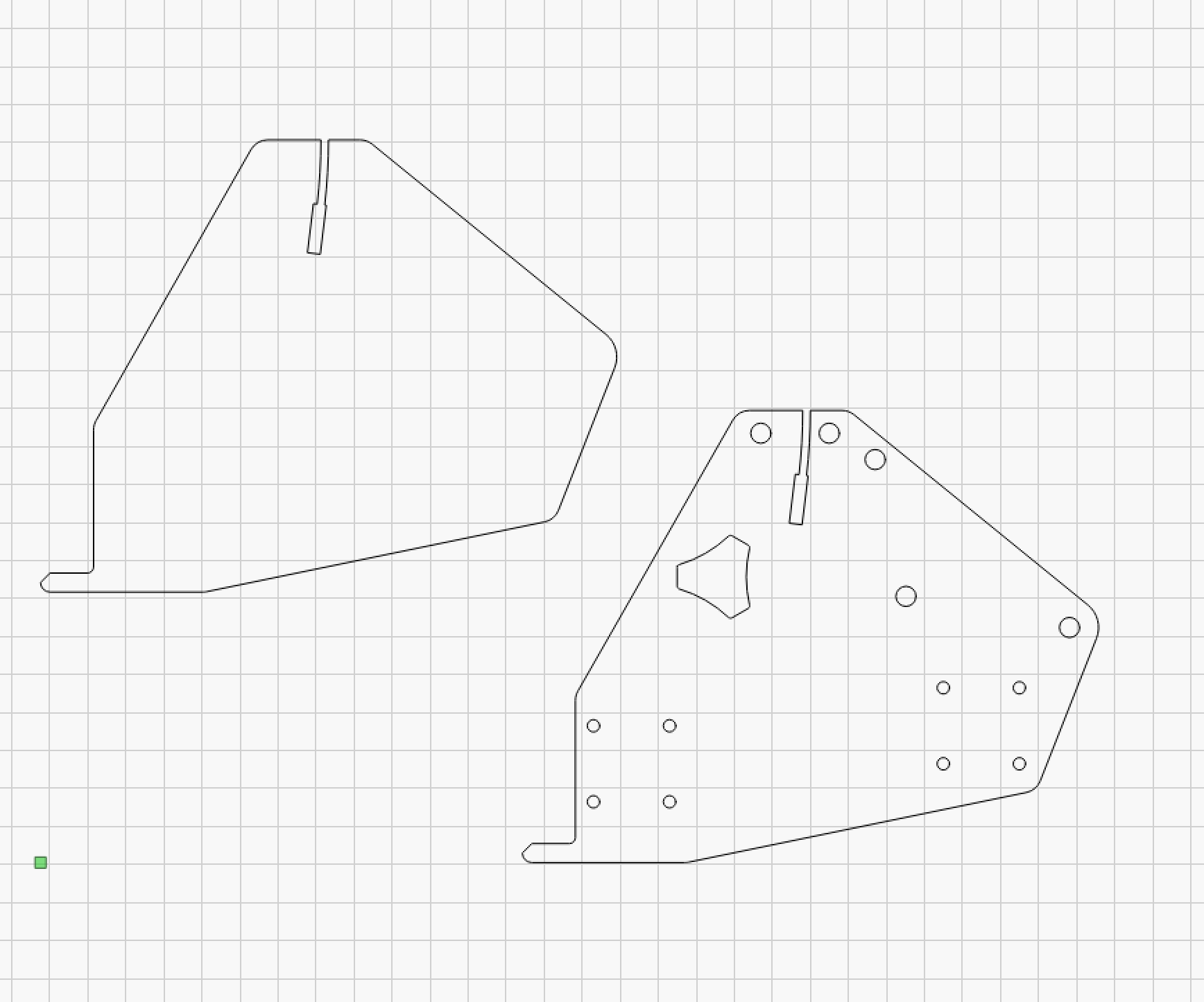

I imported the file from Feb 7, 2025 into Lightburn. When I went to Preview it said there are duplicate shapes. There are 2 outlines in that file.
I just downloaded the new V1 file and it doesn’t have the duplicate.
Thanks everyone!
Duplicate lines, What a bummer of an error.

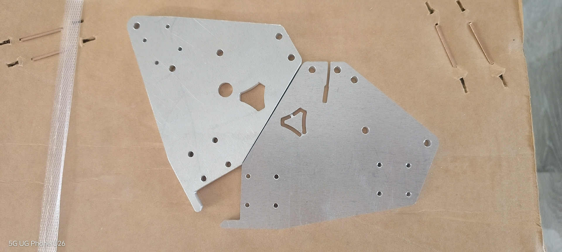

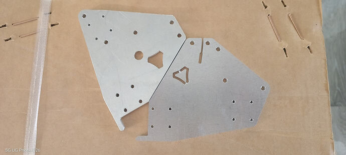

I only managed to make both pieces, the second one I made with estlcam from an old file.
The YZ Plate Max file also has a minor defect, so it would be desirable to fix this as well.
