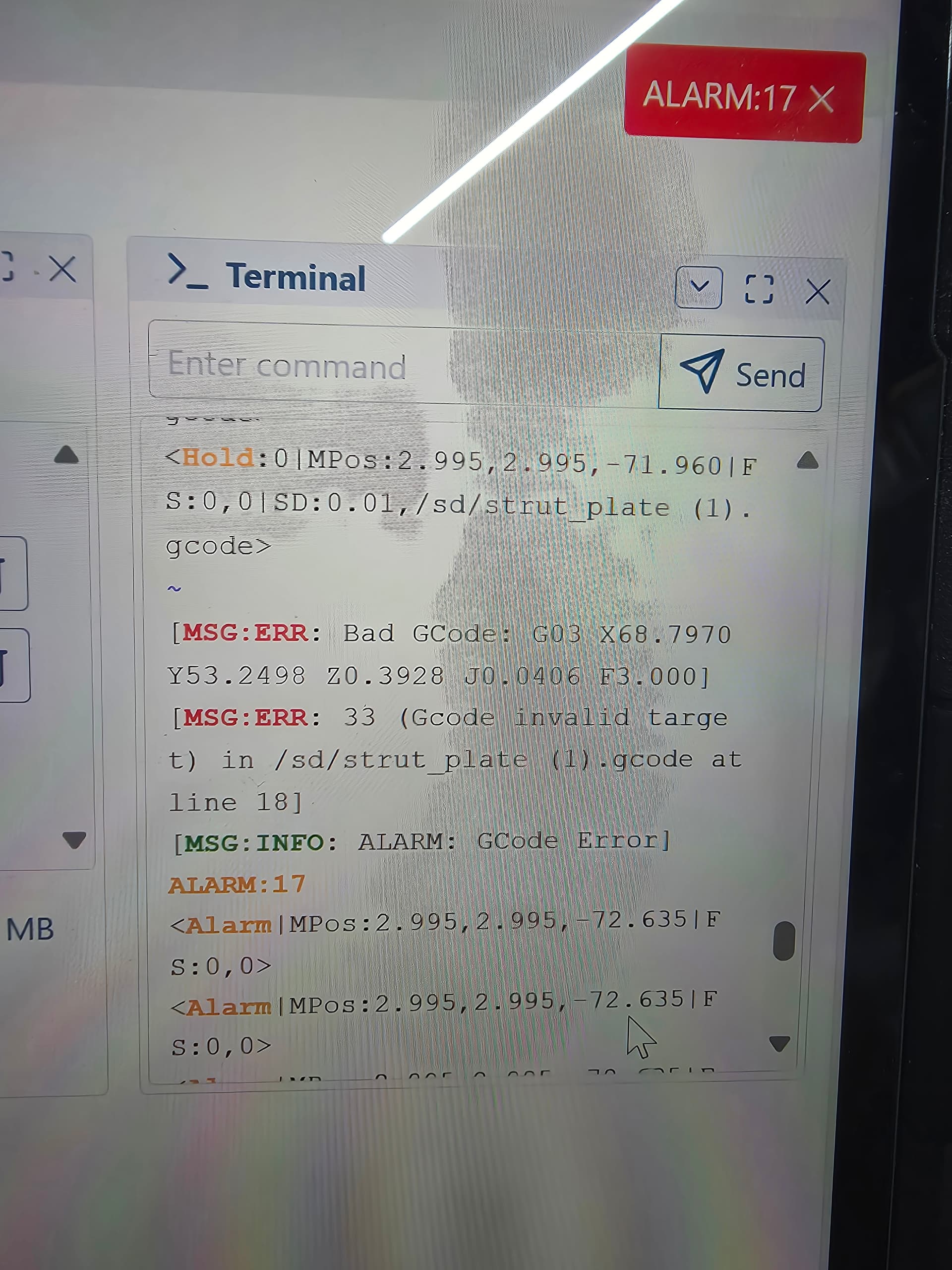

I have gotten to where I’m trying to cut the strut plates out and after using the probe I hit resume and I get this message. Bad Gcode. Alarm 17. Any ideas why this might happen?

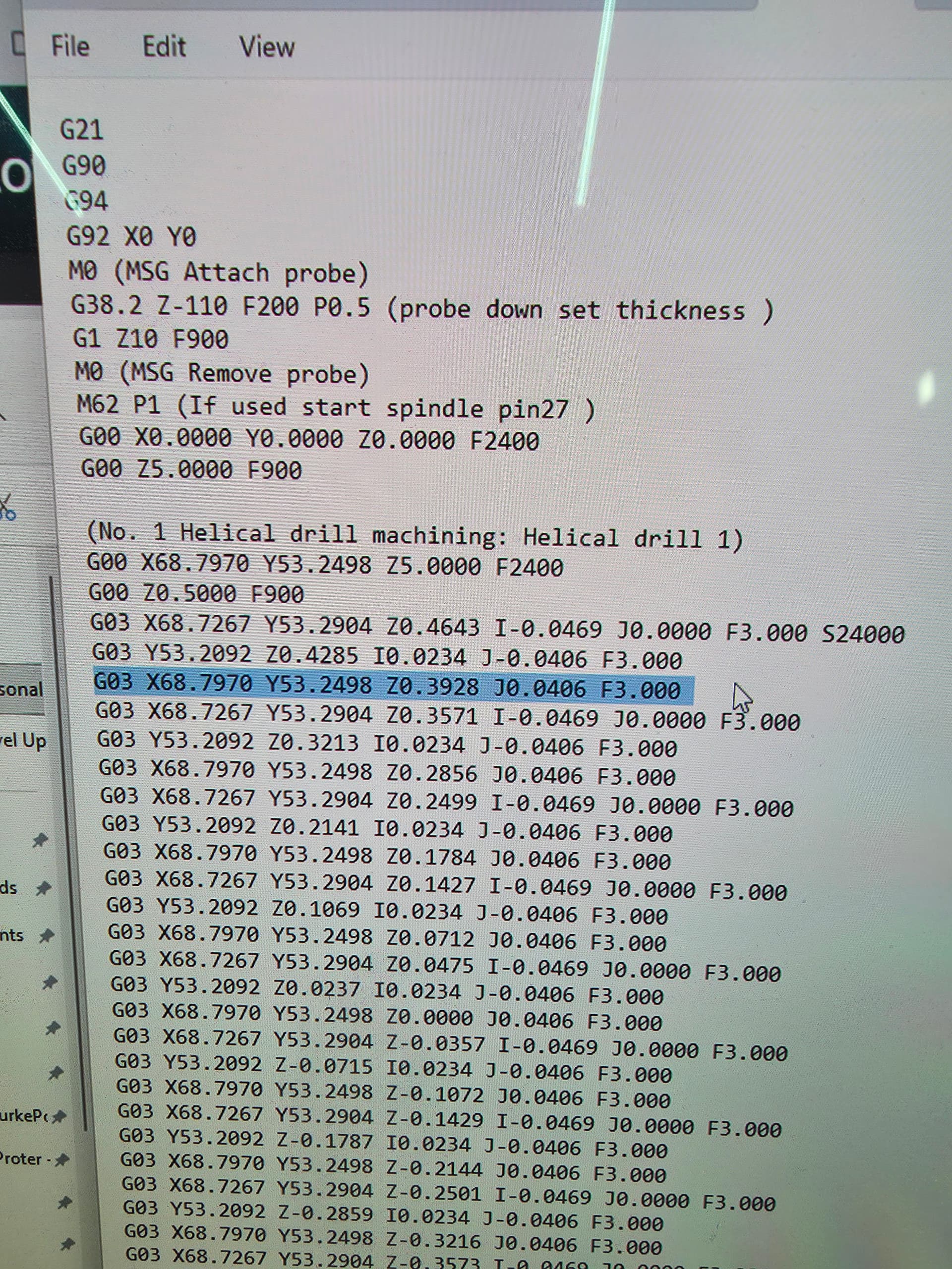

Is it getting stuck on this line? Kind of wierd because its like the 3rd like and the machine faults out immediately after hitting resume for the second time.
Share your gcode file. I’m not convinced that line is the problem.

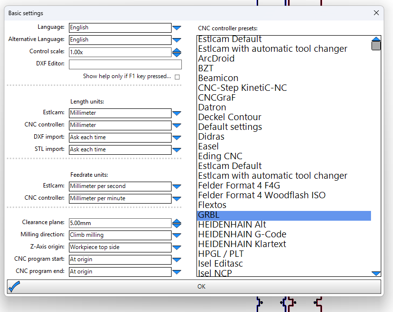

  1. There are feedrates of 3.000 and 8.000 which is in mm/min which is incredibly slow.
In Estlcam, under Setup → Basic settings, I’m assuming you have this wrong:
Specifically, you probably have the CNC controller value set to Millimeters per second instead of minute.
Lol, I plugged this into my gcode preview tool I’m working on. I don’t think you want to wait 16 days for this to finish:
  1. Something about those G03 moves seems off. They are arcs for the circles. There are way too many of them moving an incredibly tiny distance.
I’m not quite sure offhand what’s going on there.

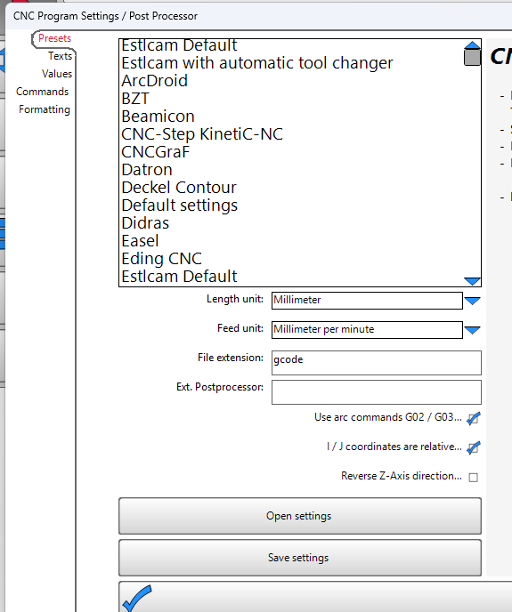

So I fixed the CNC Controller Feedrate from MM/s to MM/Min to match the instructions. Below is a picture of my basic and cnc program settings.

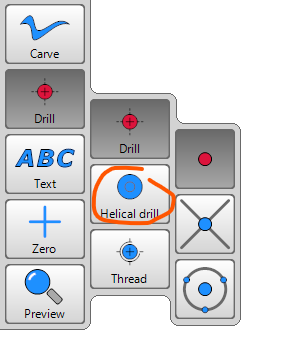

Maybe the G03 moves are for the Helical drill moves that the website said to use for the holes?

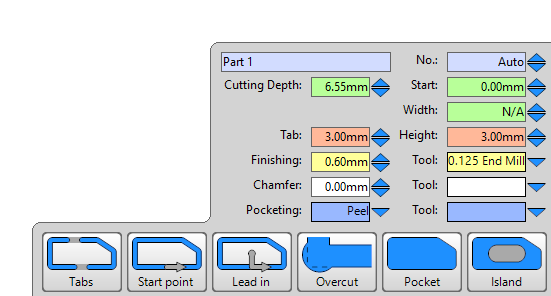

And here is a picture of my path settings. I took your advice on the tabs.
Your endmill is 0.13mm?? That’s a very tiny endmill. You have it named .125 so I assume its a 1/8" which would be 3.175mm
:melting_face: You are right. I put the inches but in mm. Ugh. I was doing this with 3 kids running around my garage…
:rofl: no worries. Glad you posted it before you wasted material :partying_face:
I have asked enough questions already but I was wondering if anything else stood out.
Keep asking. Thats how you learn!
The only other thing I saw was your Z depth per pass. You have that set at 1mm and your total cut depth at 6.55mm. That will leave your last pass at only .55mm. What I usually do is take my total cut depth and divide it so I get equal cuts. If you go at 1.1mm DOC then you will do it in 6 passes instead of 7 and still be at pretty much the same pressure on the machine. I would also make sure you run your router on the slowest setting it has for your speed. Its good to keep it slow since you dont have the struts on yet.
I am still getting the same alarm 17 and error message. Anyone else had this issue?
I just went through all the estlcam basics and everything seems fine. I load it to the sd card and run the gcode. It goes through the probing gcode and then when it goes to cut the first hole it alarms.
Says bad gcode G03 X69.8127 y53.2498 Z-0.6000 J0.9202 F180
MSG:ERR: 33 (Gcode invalid target) in /sd/strut_plate (3).gcode at line 18
