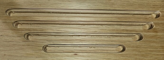

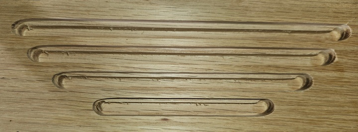

Here is a picture of what I describe. These slots were cut with a 1/4" endmill, total depth of cut 0.4" in two passes (0.25" & 0.15"). The cuts are on the vector lines, with pass #1 from left to right and pass #2 from right to left. The bit does not lift after the first pass, but plunges down for the second pass. You can see a small ridge near the top of each slot because the second pass is slightly lower in the Y-direction. The slot width is larger than the 1/4" that the endmill cuts. I can minimize this effect by taking smaller depth of cut for each pass, slowing the feed rate, and slowing the plunge rate. But this does not eliminate it completely. If this is due to a problem with the core, I don’t know what to focus on. Everything seems pretty tight already. Any ideas would be appreciated.
Is that oak? looking at the pictures; you can see on the right side of the picture that when you switch direction and the bit drops it pulls the bit down (-y ?)and to the left as you look at the picture. As the bit cuts deeper it pulls the bit right and down more. when the bit is at full depth you can see the offset already.
The moment the bit travels left it pull even more down (-y) but now your cutting the full depth and it pulls more.
Bear with me for a moment. When you mill a slot in one direction one side is upcut and the other is conventional. There is a fixed amount of defection.
A nice straight line. At the end of the slot you plunge to your final depth. Going right to left. The forces on the bit now are pushing left and pulling -y. But this causes the full depth of the mill trying to cut as it is pulled into the work. I think you may have your belts a little lose. Both x and y. Or a little play in the bearing.
First thing I would try is to change the cut order. Try cutting .15 first pass and cut the .25 the second pass. See if it changes the offset.
Something I noticed about the picture. the left to right cut is very clean, and the right to left is not. When using oak I have found at times I needed to slow down going against the grain.

Thanks for your comments. I’ve tried tightening the belts and the core clamps. This has had no effect. If I lift on the core, there is no movement. If I lift the router, the only movement is the backlash (?) at the leadscrew nut.
This is oak, but I’ve tried a soft pine and have a similar (but smaller) effect. This is a Whiteside 1/4" Upcut bit. I am plunging 1/4" on the first pass because I was trying to use a compression bit with the upcut portion at the bottom of the bit slightly less than 1/4". I have tried a feedrate as slow as 10 inches/min, but this still shifts the bit a small amount (<1mm).

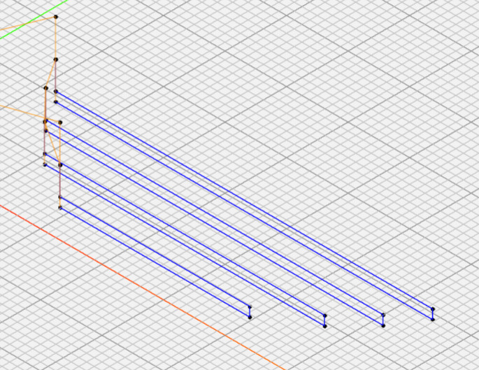

Here’s a gcode preview:
