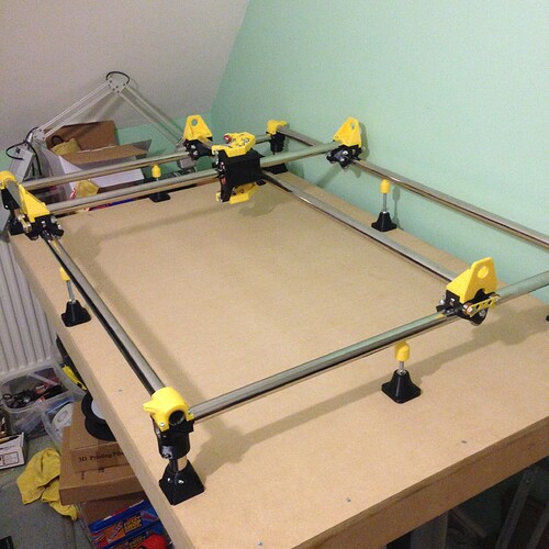

Hi guys. I have been ill recently with the dreaded Cancer but now under going surviellance. Fingers crossed. So over the past few days I decided to give myself a lift and start using my MPCNC. I have come across an issue. The part I’m trying too cut is 584mm x 324mm. When I cut the part out it measures. 590mm x 324mm. Think it was an easy Step/mm calibration needed I carried out the formula need divided by actual then times by steps in Epprom. Redid the cutting and absolutely nothing changed. If I minus 20 of the Y axis Step/mm I consistently get a length of 590mm, I at a loss. Can anyon shed any light on this for me.

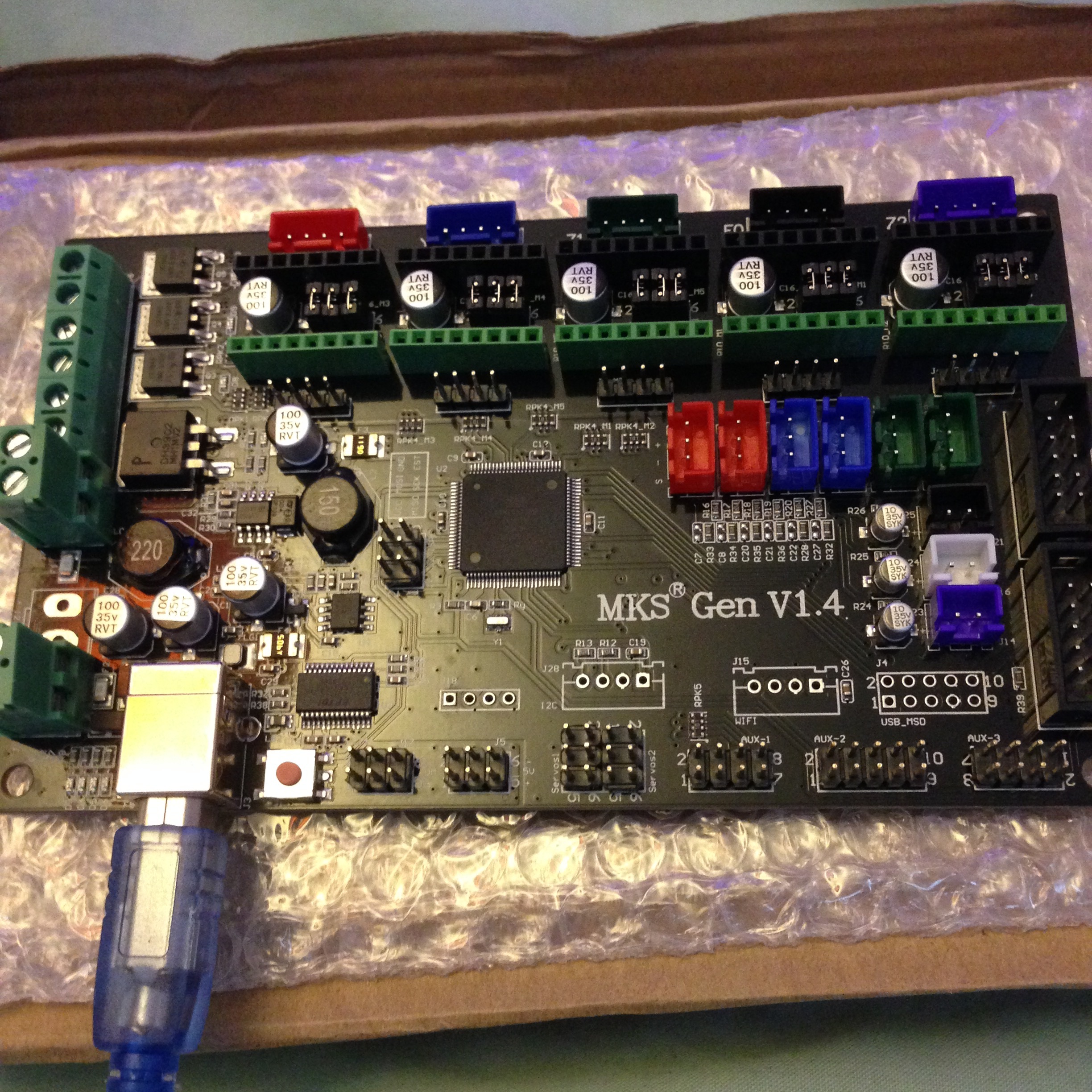

What controller are you using? That way, folks familiar with your board can pitch in to help sort this out.
Hi
Yes everytime I change the Steps/my for the Y axis I save in repetier host and the disconnect the CNC before restarting software and reconnecting, all setting are then checked in Epprom and are saved successfully.
The controller is a MKS Gen v1.4

I built the original version of MPCNC
MKS Gen V1.4 controller
Everything else were the spec requested in the build
