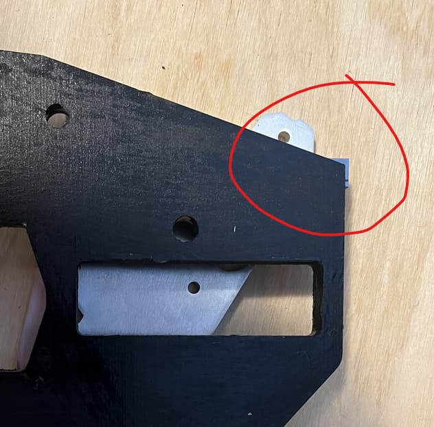

XY / YZ plate mismatch issue?
Weird -the holes appear to be offset by around 6mm give or take. Are both plates the same? I am sure @vicious1 Ryan will be along shortly to sort this out, but in the unlikely event you want to try to drill them yourself in the meantime, you can use one of hte plates as a template but centre the two rows of holes on the opening.
Well your project hasn’t got off to a particularly glorious start, but it’s certainly fixable easily enough…

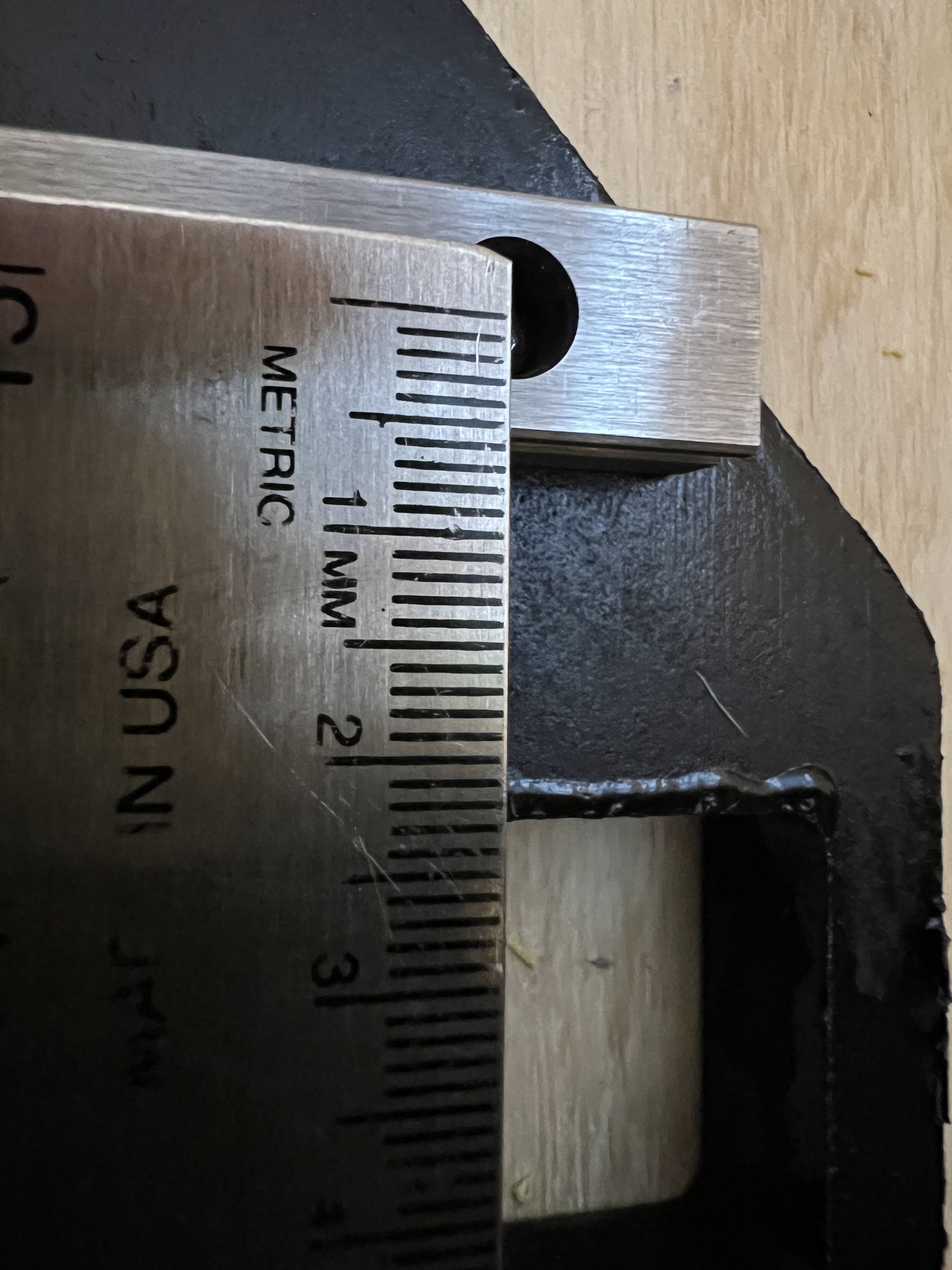

This is the issue the rail corner should line up with the plate corner. It is very hard tell in any other photo as all your pictures have a almost fish eye distortion to them.

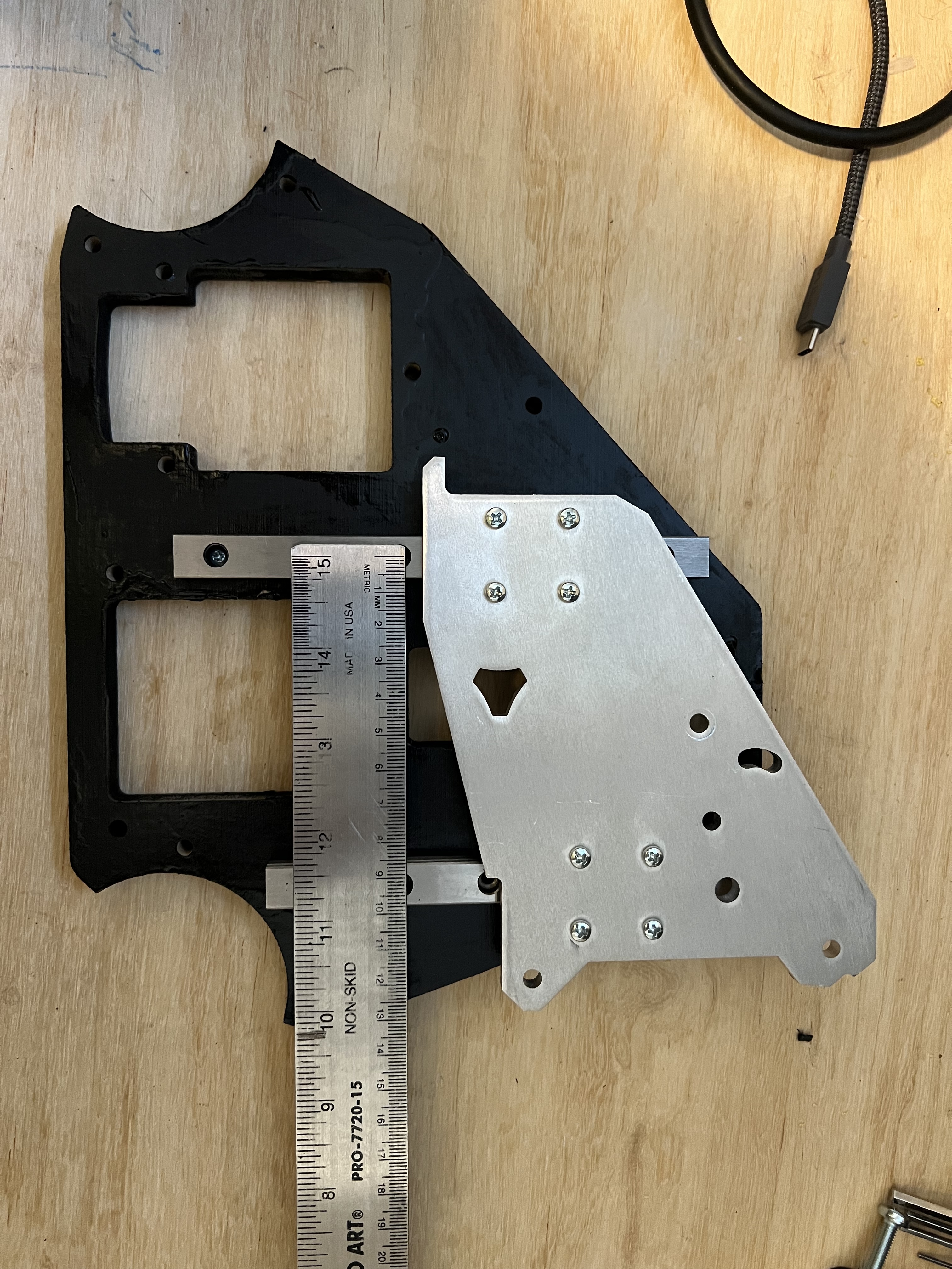

I am at the office today so can’t provide pics of the other plate but can confirm I couldn’t get the fitment to work on that one either. I have been in the manufacturing (NC included) industry for a long time and know sh#t happens unfortunately.

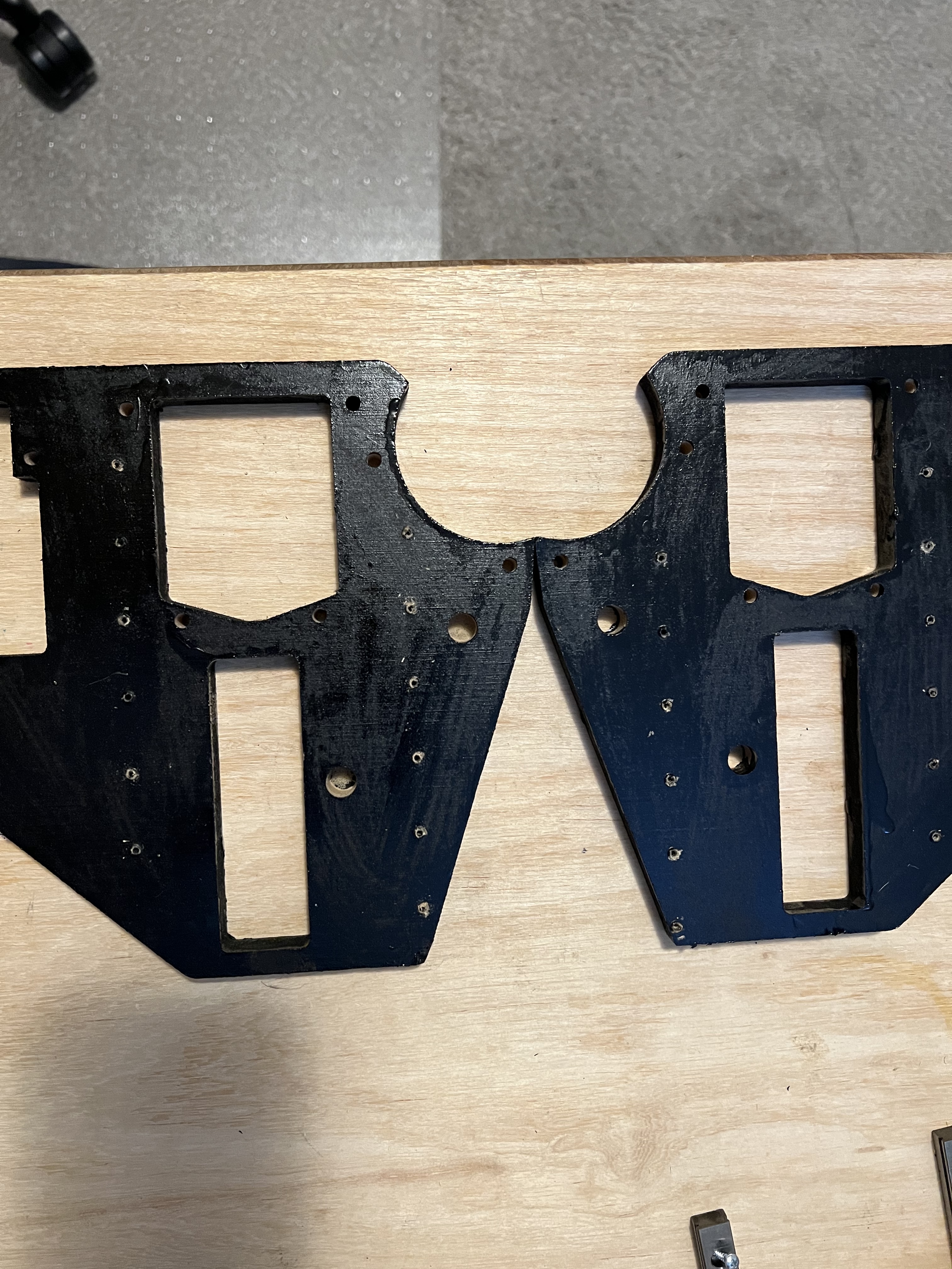

Pictures of the other plate, offset is around 22mm and 38mm from hole center to cutout edges

Can you show me both in the same shot please screw holes up , wide shot so I can see all the edges. Might as well take the rails off. I am trying to figure out exactly what happened so I can figure out if I need to send some emails out. If they are different something really odd happened, if they are the same I know what happened…for the most part.
Here are the pics, 1/16th holes don’t appear to be fully symmetrical in how they are offset/moved.
I’m going to hazard a guess…
These are laid out so that the left and right plates are opposite ends up on the sheet. Ie: the mirrored face is either the top or the bottom.
This then makes some sense.
Both sets of screw homes seem moved towards the back, looks like 3-4mm, and both sides about the same. If they are in line that way while being cut this would be the same offset. The vertical offset would look different in this case as a positive offset on one side would become a negative offset in the other, so this makes sense if they are laid out like this when cutting
