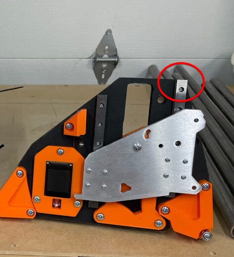

I am building my L3 with purchased parts from the store. I have been double checking the documentation to make sure I have the parts installed correctly but can’t seem to get the Z-drive hole to line up with the hole in the XY plate once everything is mounted on the YZ plates (I had to take the Z-drive post off to mount onto the YZ plates). The more I look at this the more it seems like the 1/16th holes are possibly off?

The Fabian linked topic doesn’t address my issue. If you look at the top down image here, this is the through hole for the Z-drive post…as you can see the holes don’t line up, no way to get the M5 in
Here is a picture with the rail’s unscrew, M5 installed in the Z-drive post, you can see where the rail holes are
Did you purchase your flat plates from the store? If so, have you re-drilled the mounting holes for the rails?
At first glance it appears that the rails are not in the correct place but it’s impossible to tell from the photos because there is considerable parallax error.
First, check that centre of the rails is close to 92mm apart and centred on the opening (about 31 mm from each side). You can check that on both plates to get an idea if that’s where the problem lies.
Maybe some pictures from farther back so we can see better? And maybe the YZ plate without the XZ plate covering it?
It looks like your linear rails are extending past the top of your YZ plate, but I don’t see that in other builds

As said by other members, your YZ plate seems “off”, liké it’s been squeeshed vertically and/or slanted or something…
One of the rails does not look vertical but maybe that’s just the pictures
Print the DXF at 1:1 ratio and compare?

It’s a bit confusing but I don’t think that is the issue - I think there’s a misalignment of the rails.

I think a picture of the entire YZ plate by itself with the rails removed, or at least with the XZ plate not attached so we can see the rails better would help

It’s only been an hour, could you check the following and get back to us? I am pretty sure that the parallax error in the photos is not helping - can you stand back further and try to get them exactly square to the camera perhaps? (After you have checked the dimensions…)

After messing around with everything to check fitment I am fairly certain the rail holes were miss-located.
I will check with a dxf file next, curious about the store’s refund/return/replacement policy
The rail holes are 38mm from one side of the opening and 25mm from the other side of the opening
