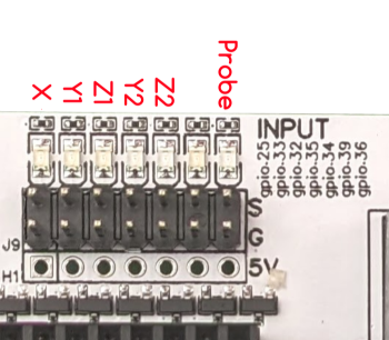

How about this: on the jackpot board, the end stop light should be off until it touches the end point. Like when the Z probe closes, the light goes on. Correct?

(I don’t yet have a Jackpot.) IIRC, the LED should be off normally, then come on when the switch is pressed.

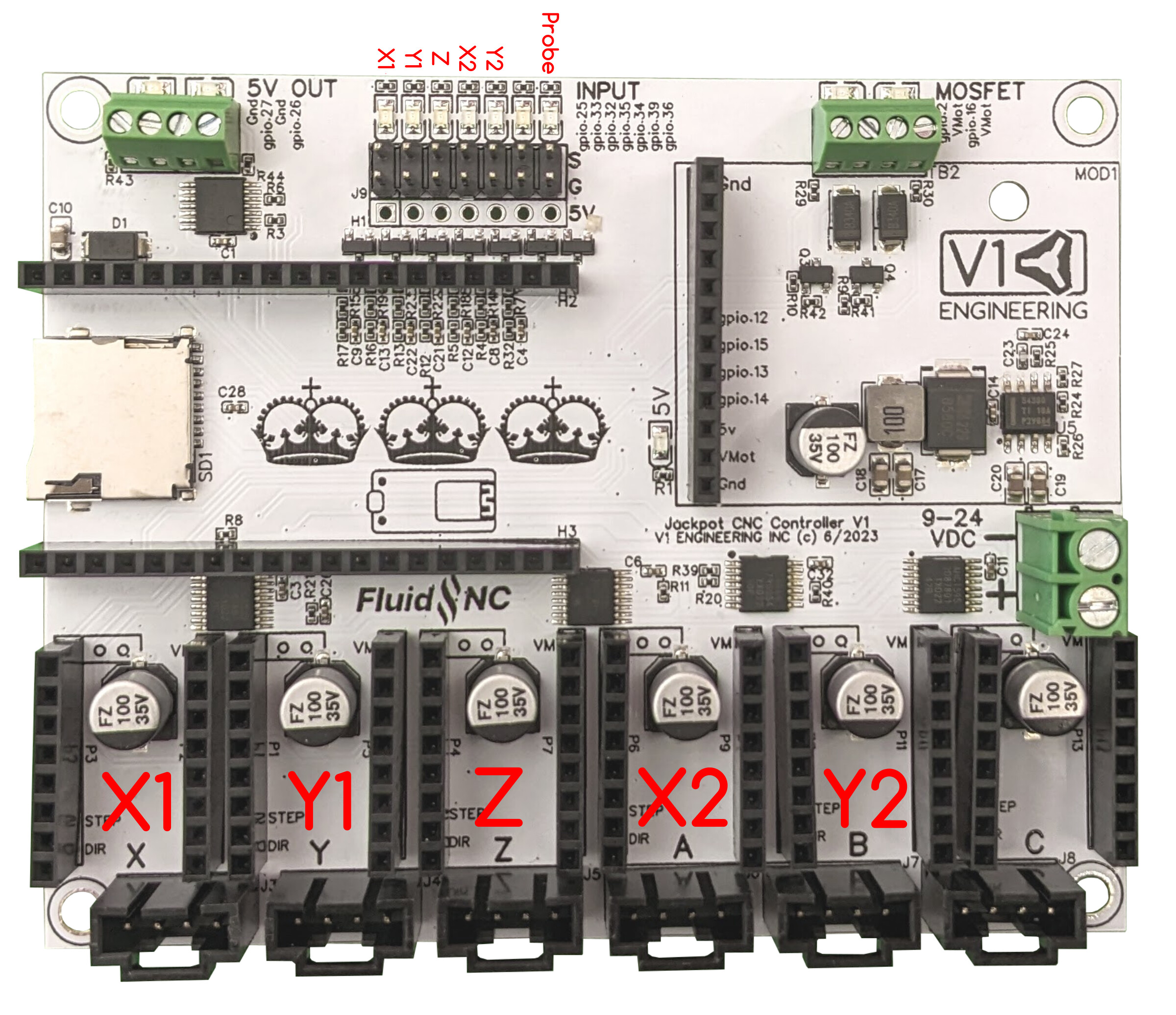

Here’s how the endstops and probe should be connected (v1e.com jackpot docs- https://docs.v1e.com/img/jackpot/MPCNC%20Labels.png )

That’s where I’m unclear. Do I hook the 2 pin probe to Probe or to Z? I’ve tried both, and it seems the same. Right now on the board, the 4 lights for the X and Y stops are lit. The Z one is NOT until I touch the contacts together. That seems backwards, and I’m thinking if I reverse it like I did with X/Y, homing for Z will work as well.
No, the light is ON until it’s triggered. If you manually press the endstops, do they turn off?
Probe goes to probe.
Z stop should be wired same as X and Y.
Jackpot LEDs should be on when NOT tirggered and off when they are triggered.
@vicious1 - the Jackpot docs don’t read well at least for some-
Maybe instead “Will have the LED ON when not triggered, and LED OFF when triggered”
