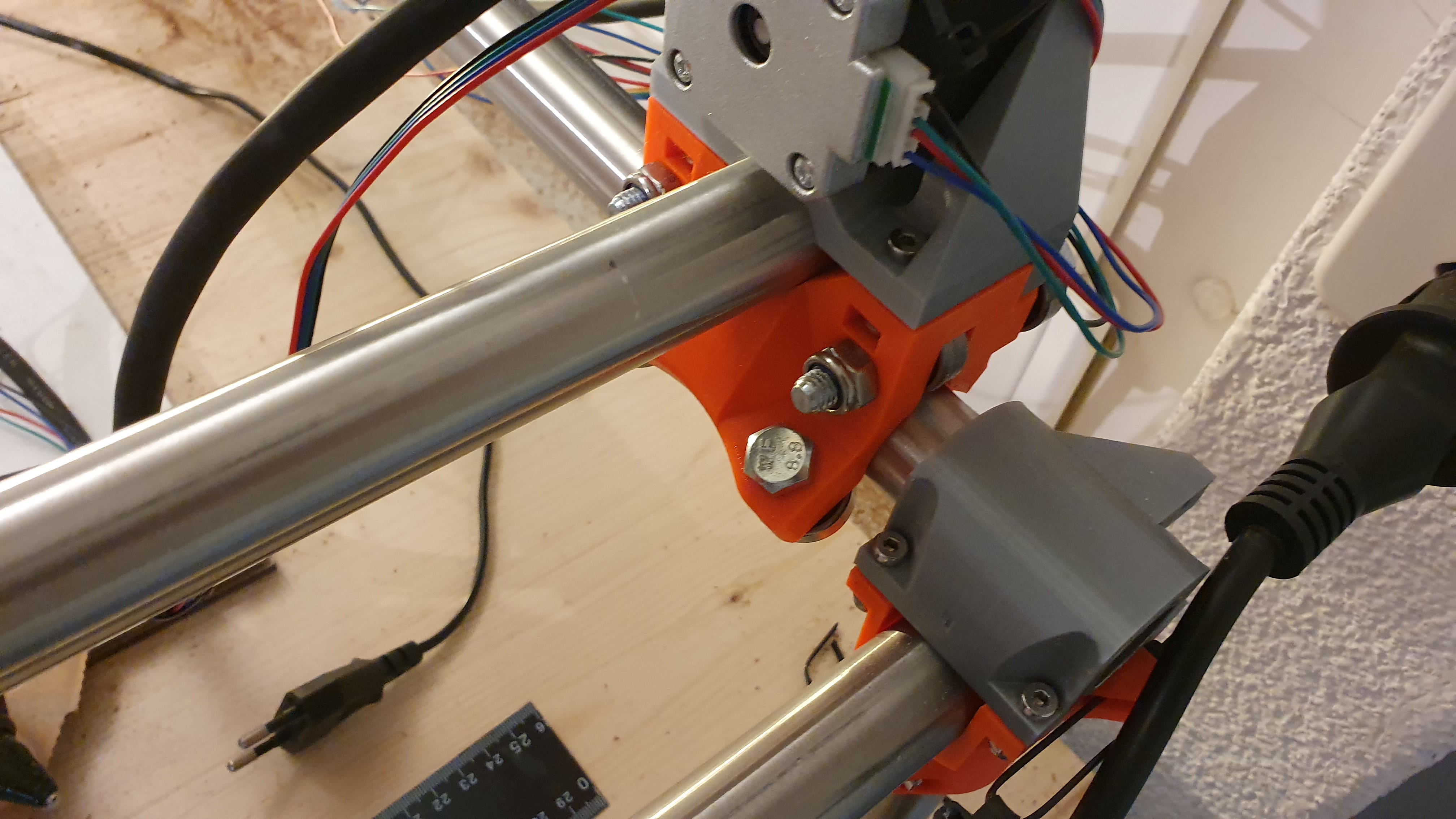

So no progress. But as I was moving around the X-axis (it moves very very smooth without motors attached) I found this:
(other image in next post)
On the image I did not bend the middle rail at all, so it is indeed 10mm off. Now I’m completely confused because when I measured it before it was different, but anyways there is still a problem to solve.
Sooo, if I’m assuming correctly my right angle in the middle is not a right angle but a larger angle than 45° (right?). So according to the assembly instructions I would tighten the tension bolt B and untighten the tension bolts A. But since my tension bolt B is already very thight and my tension bolt A’s are loose I still don’t know what to do :sweat_smile:.

So clearly it must be a mechanical problem. My assumption is that something is wrong with my middle assembly, since I cannot adjust the angle of the X and Y axis at all with the two tensioning bolts (A & B). Like I wrote her:
Do you have an idea what the problem could be?
