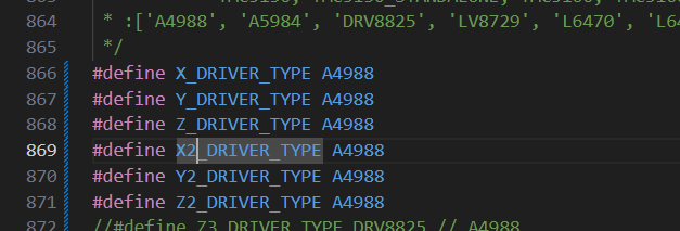

I wonder if I need to change the config to tell it I am using A4988 instead of DRV8825?
Yeah it looks like you are using the correct firmware but you will need to tell it you are using the different drivers.
Changed this in configuration.h, but no change

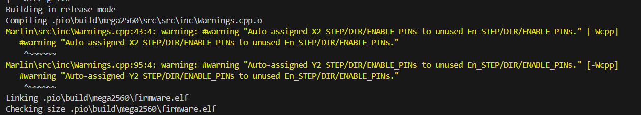

I wonder if these warnings are relevant?
That was normal with the older drivers. My old Lulzbot AO10x print farm sounded like a tangle of snakes when just sitting there.
Yeah, if your control pins for the stepsticks are misdefined, your machine isn’t going to do anything.
