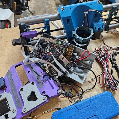

Hey Ryan I can’t find any info on github about the uart mode pins and jumper for the twotrees tmc2209 v2 drivers. They just don’t have the 2 pins (one of which you bend in the tutorial DIAG I believe)
Im gonna wing it and assume index is not used on either. Its the jumper sitch Im worried aboot.
For what board? Most boards do not use the top drivers pins anymore, that was a retrofit thing a long time ago.

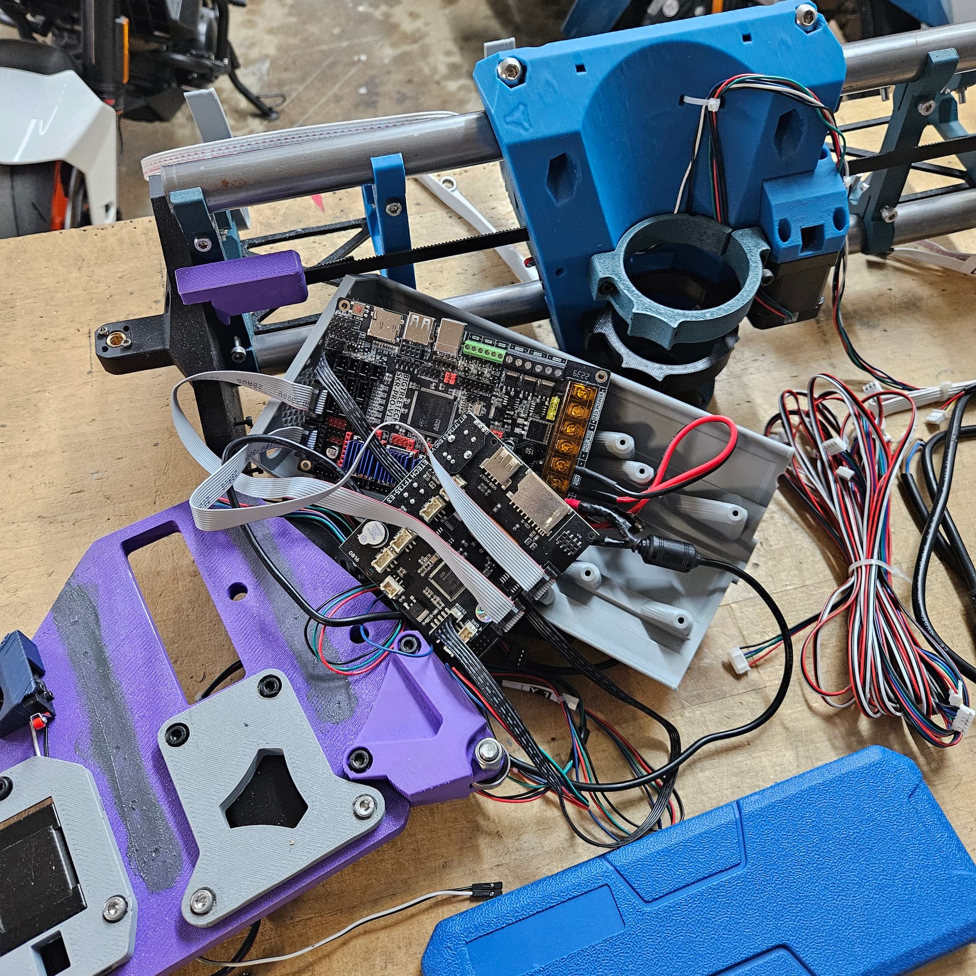

Oh okay. I kinda figured. I am just following the Assembly, step by step from the lr3 homepage. I have one more side to wire tonight. Hoping none of the extensions came loose getting the weave around all the different routings to make it semi cleanish looking.
I have about half of the thing wired so far. I still have to make sure none of it came apart in the shielding or whatever. I have a decent micrometer so I can test all the connections before I turn it on.
I guess my question is now, should I be following more up to date instructions?

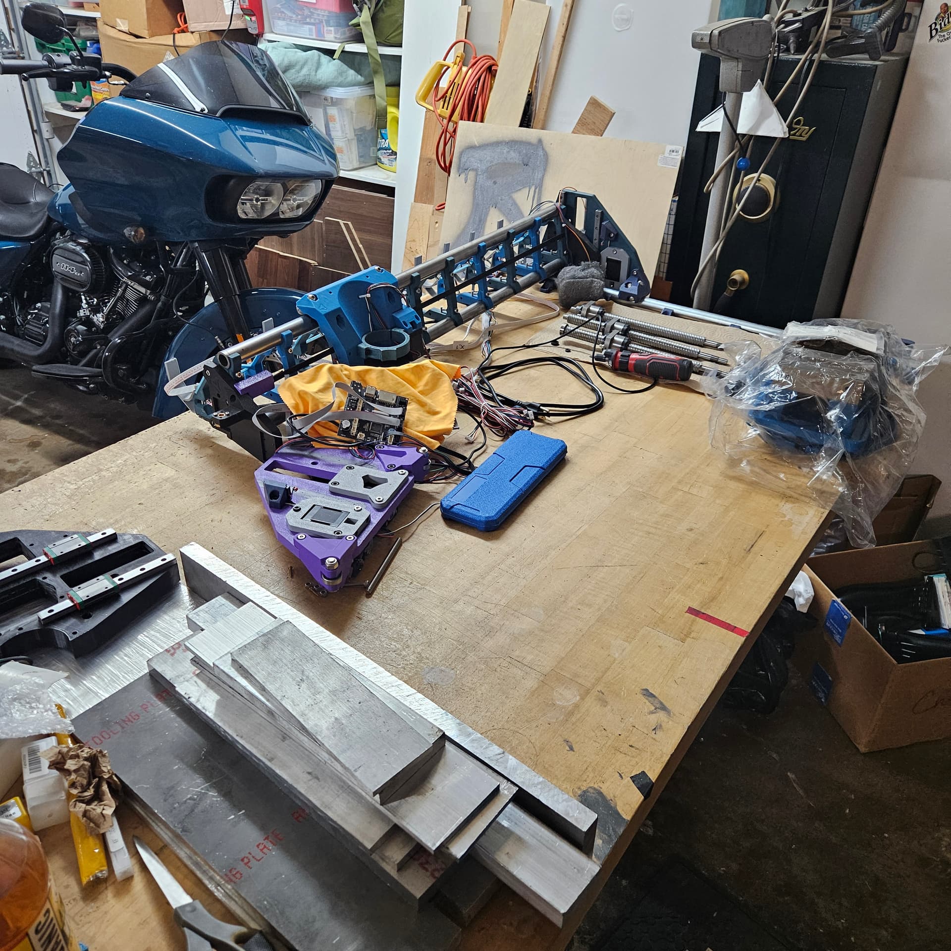

Pretty much been looking like this since last year :frowning:
Let’s pick some stuff to start making progress on. We can get through the build together. Before we start doing wiring and controller stuff, let’s get the machine the rest of the way assembled.

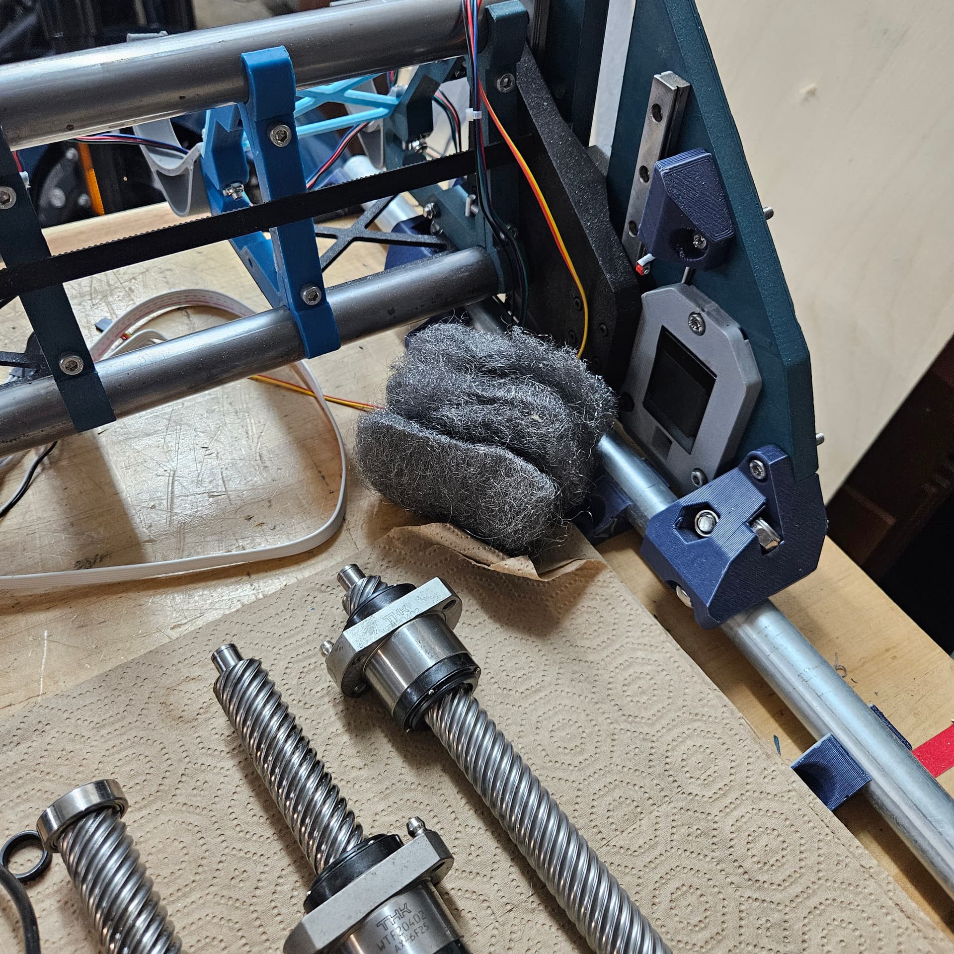

What’s the story with the ball screws?
Were you intending to try and upgrade the z axis?
You’ll need different parts to do that. I’m not sure if anyone has a remix for that.

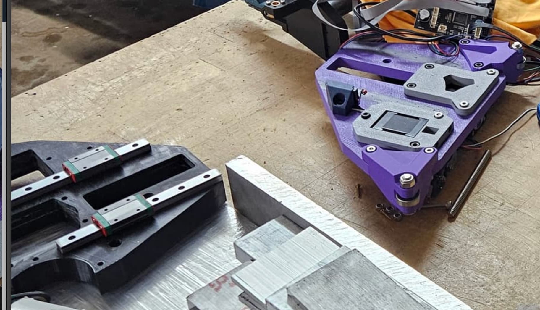

It looks like there are two partially assembled YZ plates for the same side:
The puple one has a closer view:

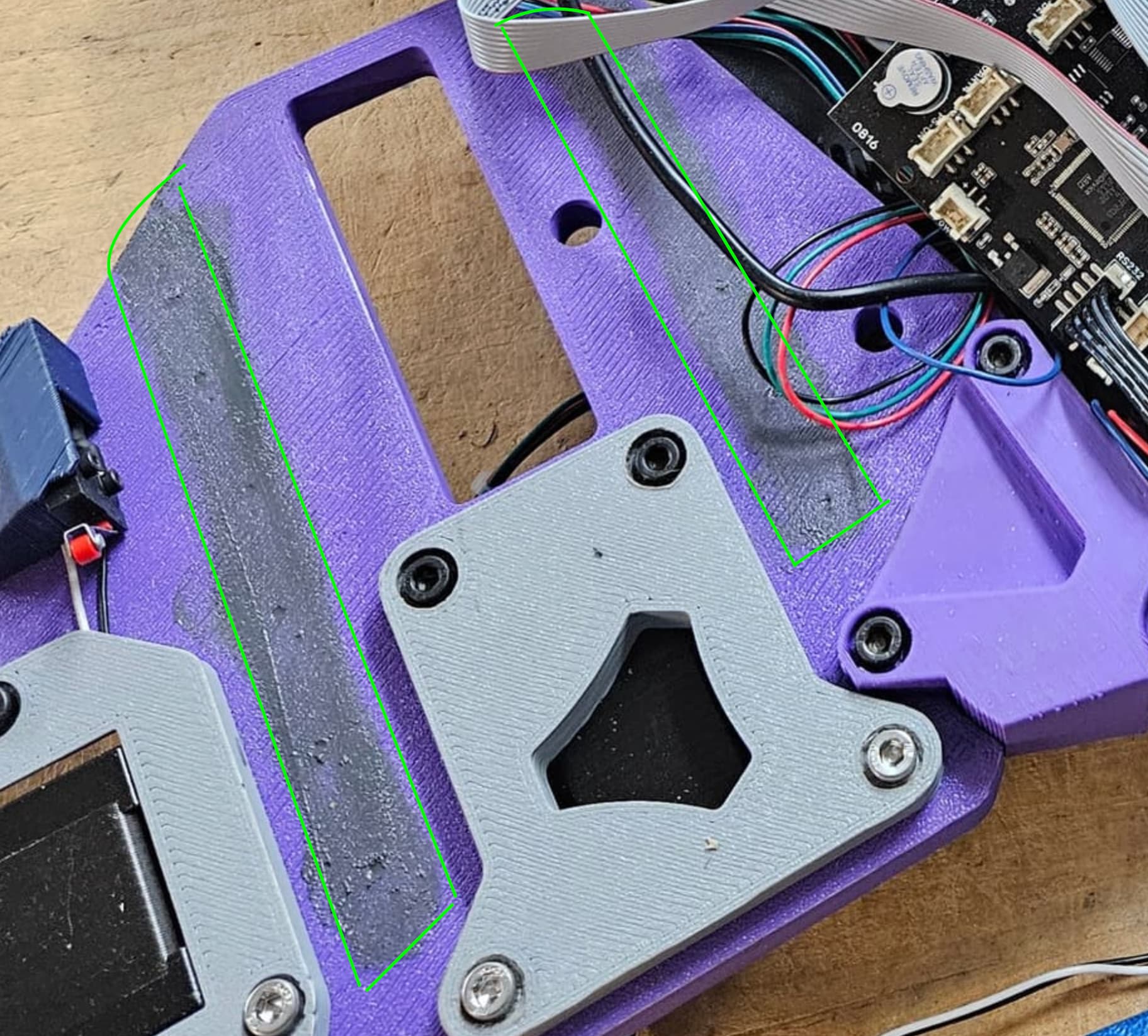

I’ve highlighted an interesting (to me) detail there. This is a printed plate, and the areas highlighted seem to have glue or paint, and the screw holes look like they’re not all aligned with where the print has them.
Can you elaborate on what issues you ran into with these and why there are two partially assembled plates?
We can help get that sorted out/squared away.
Thanks Jim. I worked on it a lot last night. Its pretty much back together I think. I routed tye wires best I could. Long story short, I just kept getting stopped by things not being right in my head. The line u highlighted was JB Weld. My machine wouldnt drop with gravity like tge instructions said, so I took it back apart and filled in various holes. As soon as this gets running I will swap out the xy plates for wood or aluminum. The black one in the picture was a remix Doug did where u can print it in 2 pieces. I ended up trying to make it extra thick and bore out the necessary areas but just disnt work, so back to the purple ones. Also, I want to make my gantry 4 foot so I will basically be tearing it all down again if i ever finish.

The ballscrews I was just cleaning on the table haha. Nothing to do with the build
