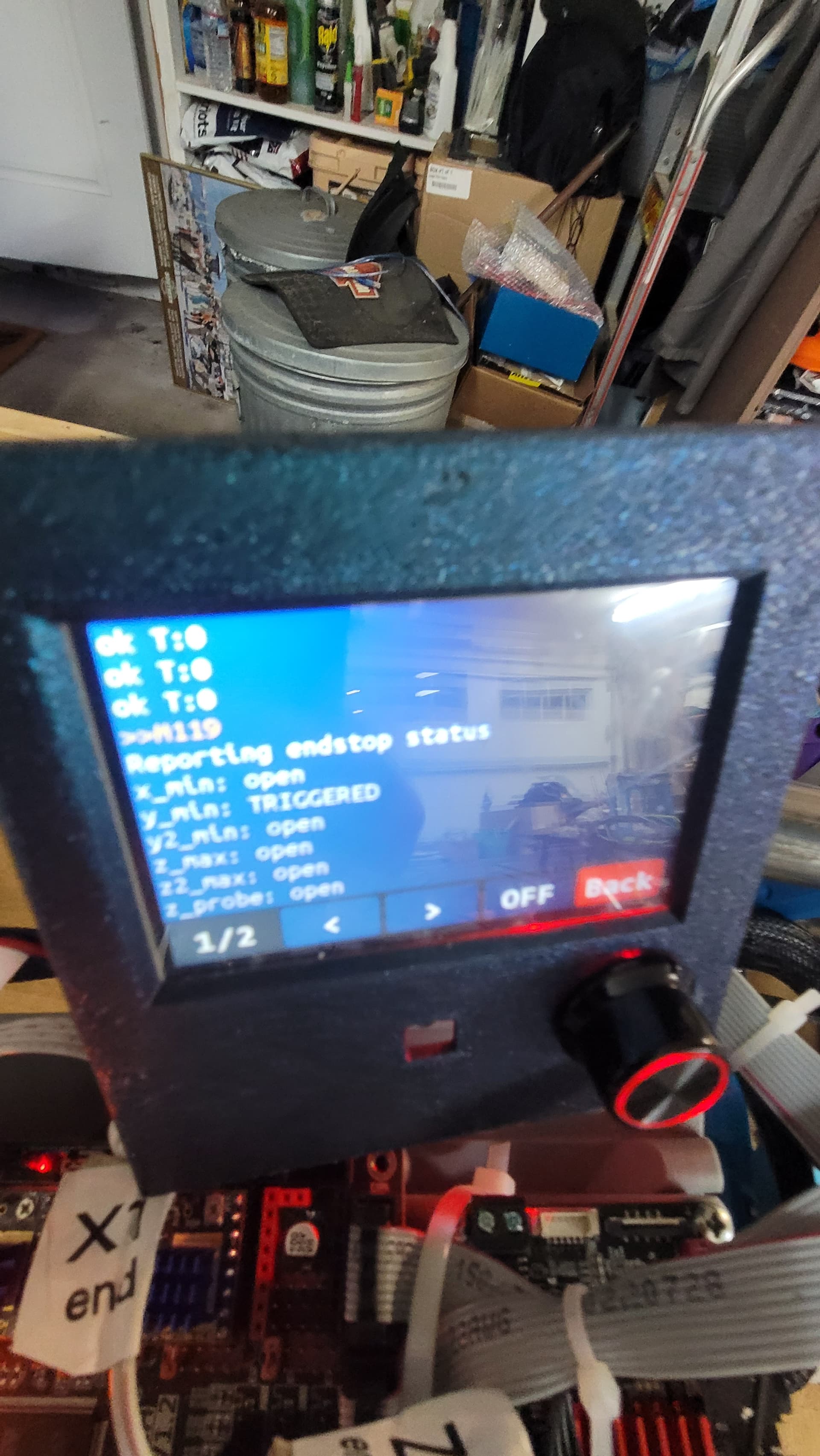

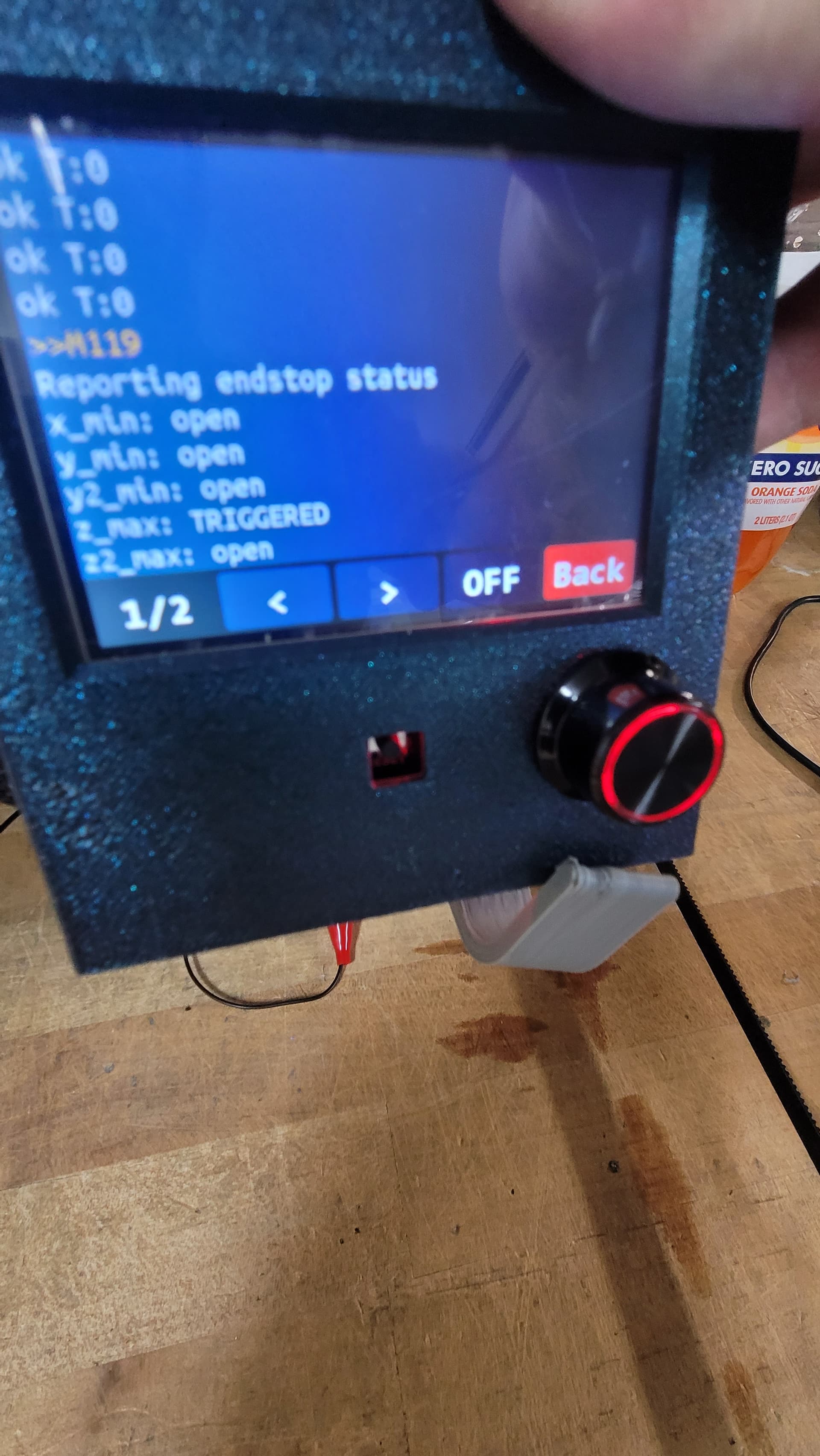

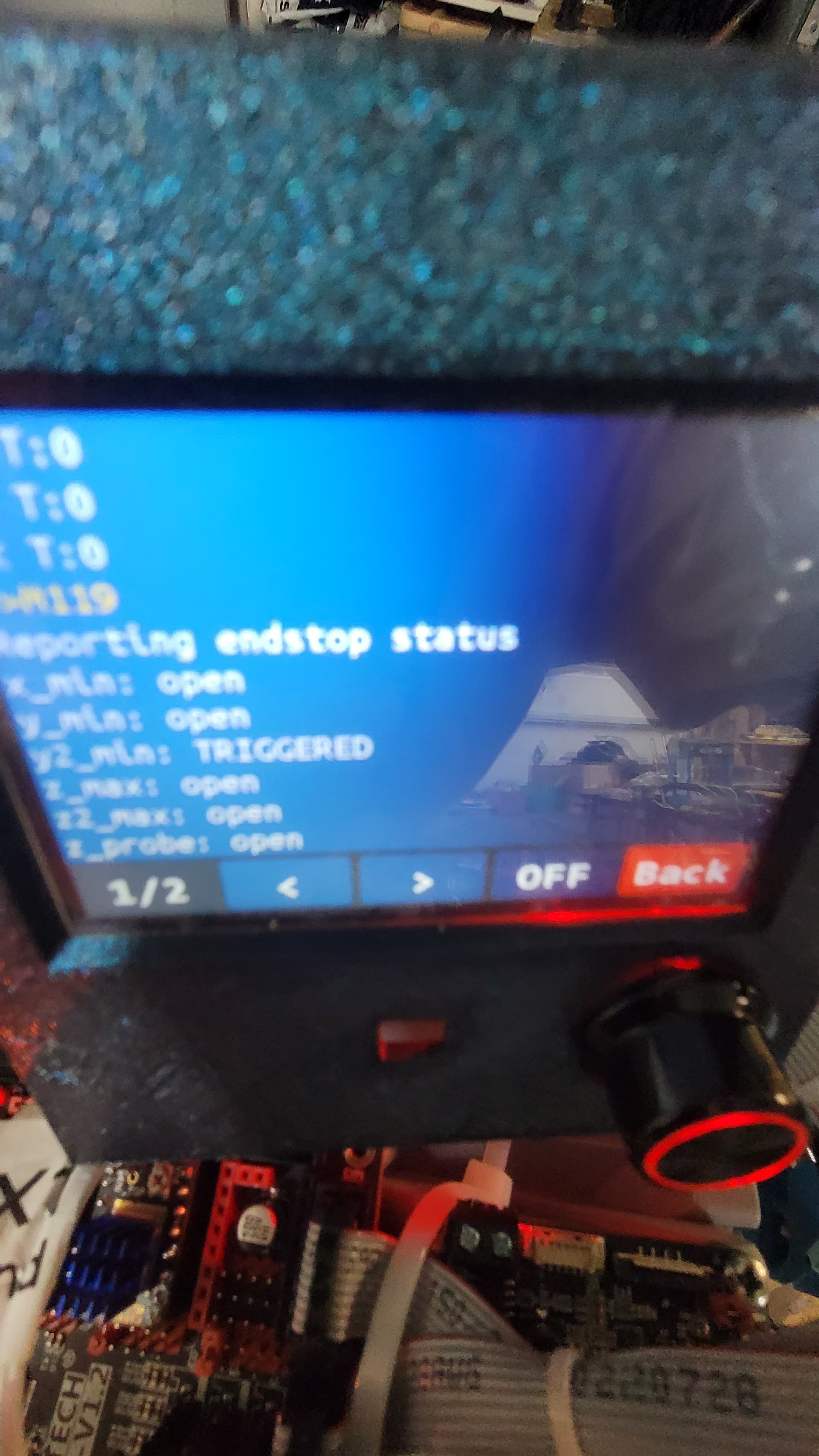

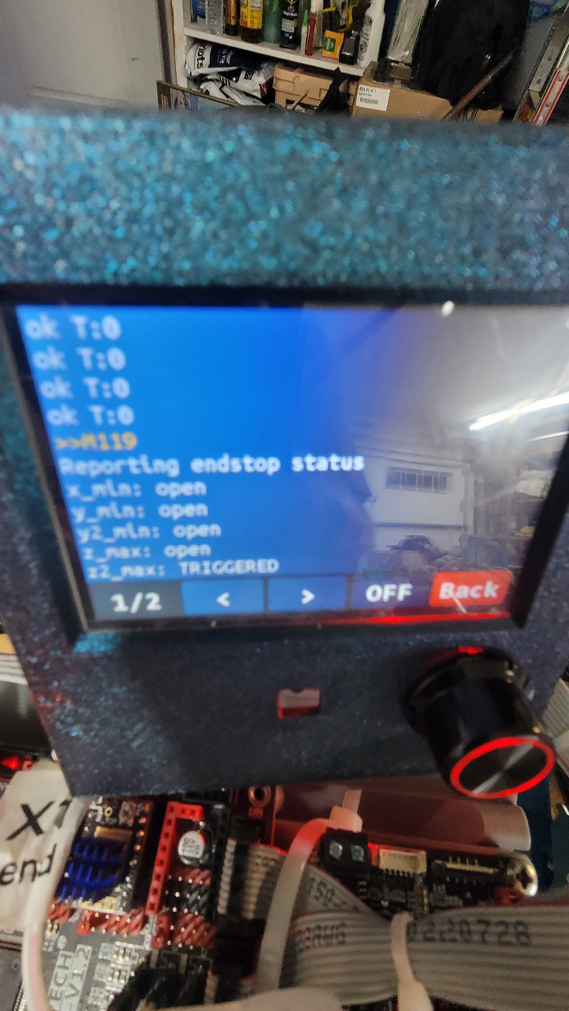

Gere are some pics. Not getting any faults or anything but still just cruising right through my endstops. Having to rip the plug each time.
Problem#2 is I cant get pronterface or anything to connect. So just using the tft for now.

OK, so you can send M119s.
With the machine not running the router, and X and Y somewhere out in the middle of the machine, do this:
One endstop at a time, press and hold in the endstop. (or blue tape) and Run M119 before and during each endstop press. What do you get?
They say triggered i can see them light up correctly too. They just have ZERO affect in stopping travel
is this smehow the wrong boot?
I don’t think they’re supposed to except when homing.
Ive tried both, but mainly just homing. But ya i tried all axis with my finger too
Full video of current status
If you have the Y or Z endstops switched, then the Y1 motor will touch the Y2 endstop, stopping the Y2 motor. But the Y1 motor will keep crashing through. Check that the endstop for Y1 is on the side of the motor connected to the Y driver and the Y2 endstop is connected to the motor wired to the E0 driver. Same for the Z.
If the motors are moving in the right direction, and you have the right answer in M119, and you have them wired to the correct motor, then there isn’t really anything else that can go wrong (when homing).
And the endstops are ignored unless you are homing. So don’t expect it to stop from a jog command.
One more thing- make sure that the axis doesn’t hit and bind on some other part of the machine before the enstops triger.
Edit- I wonder if the forum hiccupped… I swear there were posts last night about not needing to mess with firmware changes- but those are gone this morning. At any rate, don’t mess with trying to change or flash different firmware.
It can seem like they aren’t stopping movement for Y and Z if the Y1 motor is at the Y2 endstop or the Z1 motor is at the Z2 stop.
If they are moving the right way, try switchjng the Y1 and Y2 motor or the Z1 and Z2 motor.
