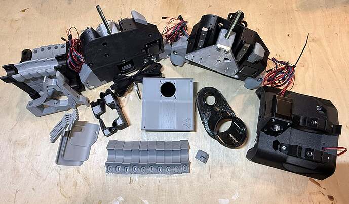

The parts most effected are the ones I print out of PET-CF. Also the ones that gain the most from more stiffness. So far I have built 19 LR4s this way and have not had any complaints yet.
If you get the PET-CF Printed parts from me then you can get the parts kit from Ryan (should be back in stock real soon) and the EMT from your local hardware store.

One of the great things about Ryan’s designs is that I feel like I can fix almost anything that goes wrong. Part of that is being able to print replacement parts. I’m guessing most of the people on the forums have printed more than one core. (Pretty sure there are a fair number that have cracked a core assembling a machine. :person_raising_hand:)
If your machine has a job to do and you’re just looking to get started quickly, then buying the parts makes a lot of sense. If you’re “getting started” and you want to develop the knowledge and skills you’d need to maintain the machine, part of that would be printing the parts.

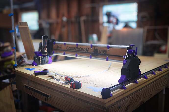

I started out having never been around a 3D printer or CNC machine. I bought a Flashforge AD5M PRO 3D printer and a hardware kit from V1E. I usually keep my garage at 60 degrees through the winter months however I thought about opening the garage doors when moving vehicles in and out so I figured the enclosed printer would be beneficial. I printed two small things to try it out and threw caution to the wind and started printing the core. It printed perfect first time and I didn’t bother checking calibration (probably not wise, oh well). I’ve been completely fascinated and interested in anything mechanical since birth.
Building the Lowrider V4 is a great experience, that you will most likely enjoy.
I would be lost without having a 3D printer around now. Best of luck to you whichever way you go.
