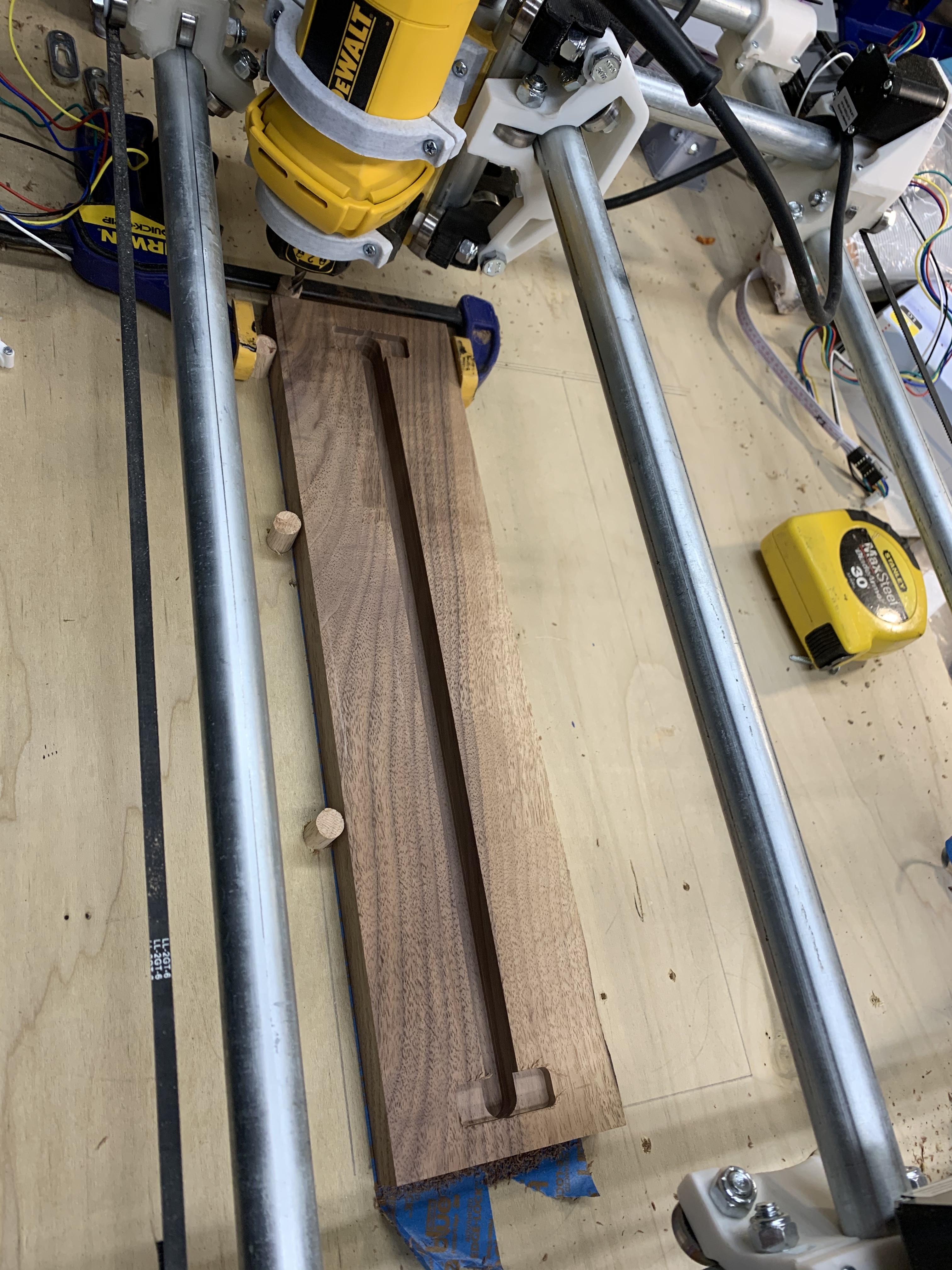

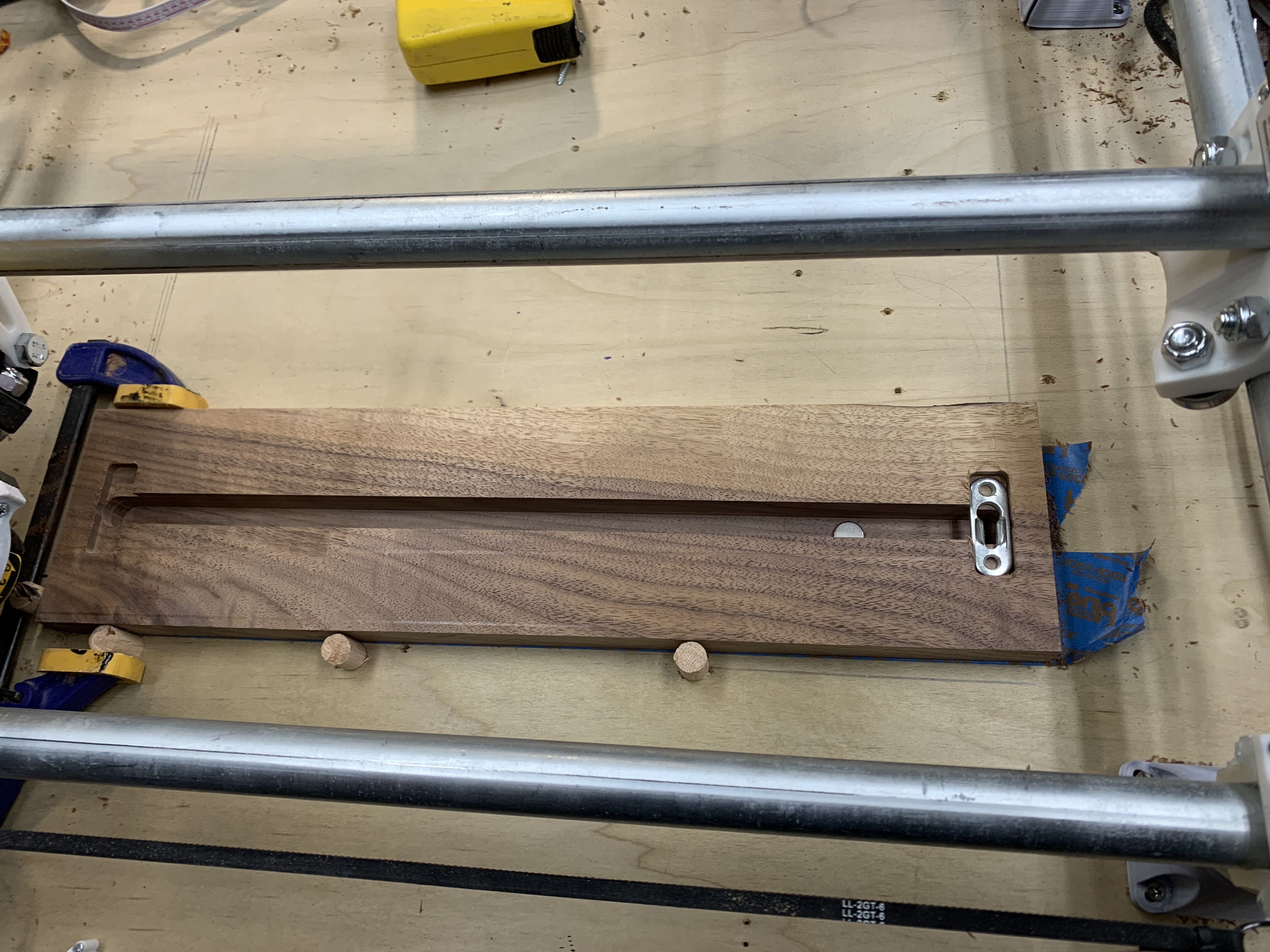

I have always made these with my router. Now… why bother with that. Lol. The MPCNC handles 0.25 inch four flute end mill with 6 mm DOC and 25% overlap in the pocketing in walnut like a champ. All the other settings were from the milling basics page.

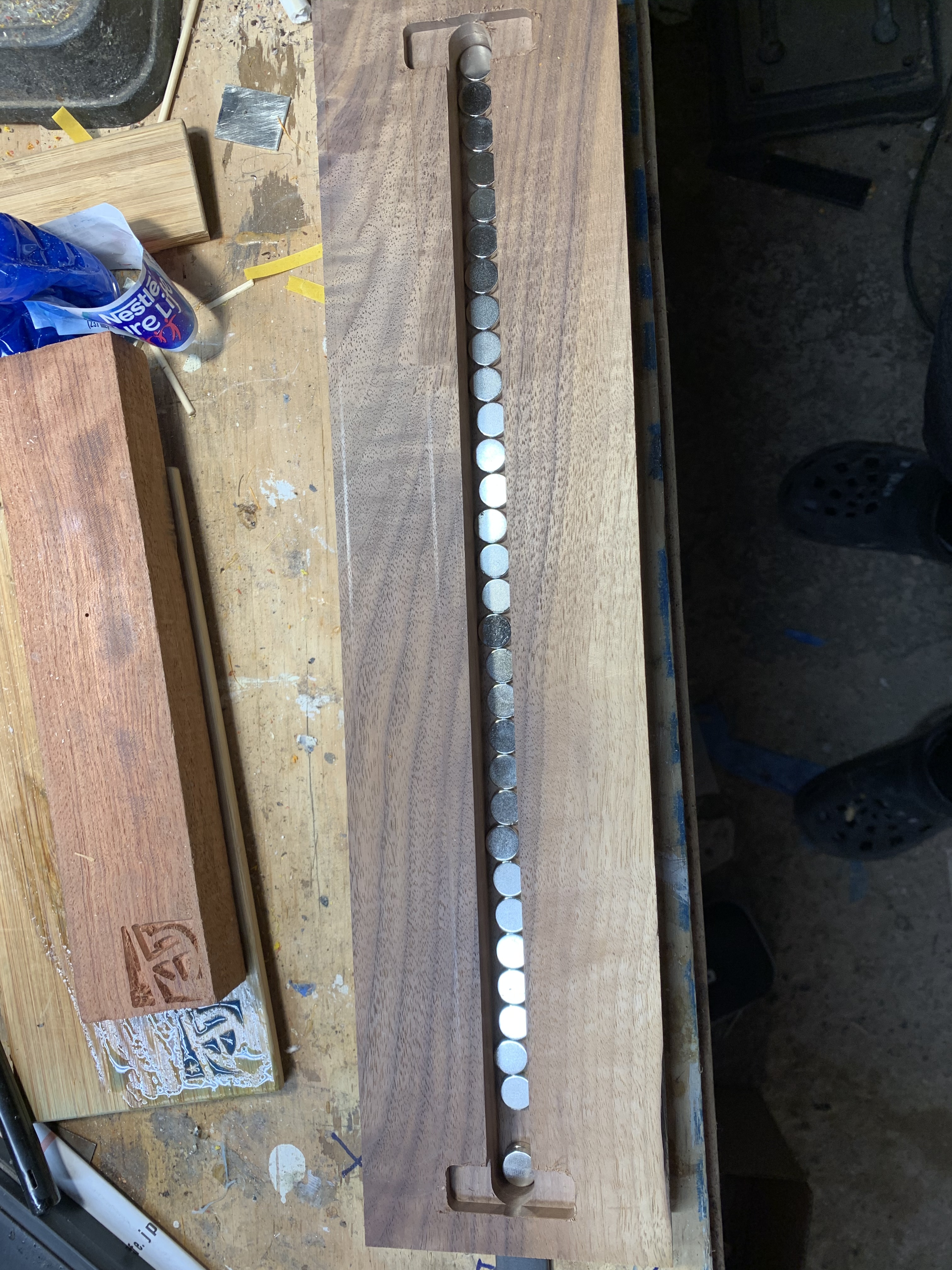

That is great! Just a bunch of magnets in there, huh? I was expecting some kind of bar magnet.

Your work holding solution is really effective.
Painters tape and superglue. The clamp is just a backup.
Check out some of the posts on chefknivestogoforums.com. I look like a beginner.
Ha. I was wondering about lift of the part. I have t channels and clamps and after about a month of clamps switched pretty much to painters tape and hot glue too.

If you used a t-slot bit you wouldn’t even have to glue them in. You could just slide them from one end into the slot and add a dowel plug at the end. Chip clearing might be a trick though. Maybe cut the channel at 3/4 the size of the magnets first?
