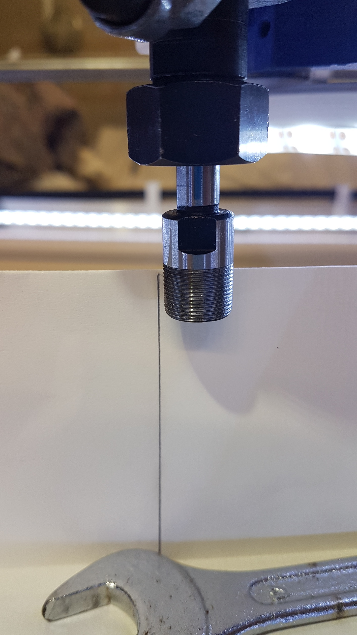

I have a wobbly chuck. And just cannot see which part is the culprit.
I have a Katsu trimmer, which seems to run fine, and I don’t think it is the part of the chuck actually on the router/trimmer.
I have had a NIGHTMARE finding parts to actually get a 3.2mm bit to fit this thing. My horrific arrangement is shown in the attached picture.

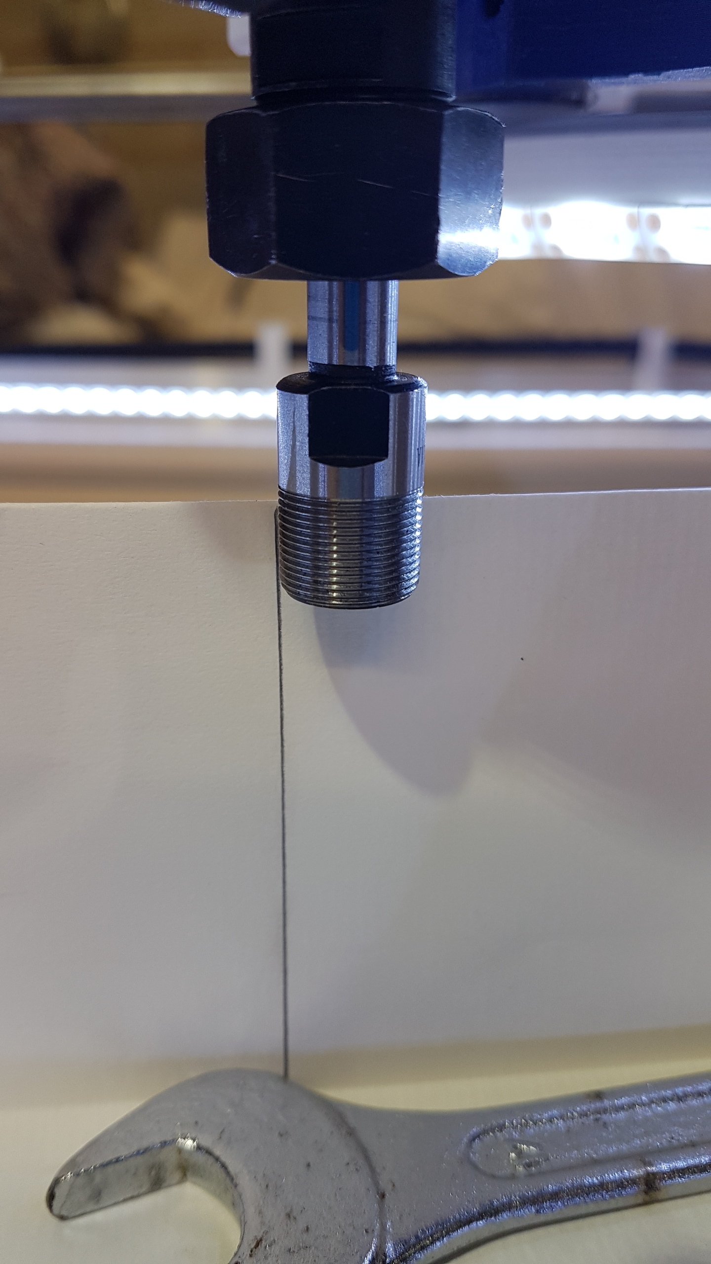

But, when everything is lose, the wobble just isn’t there. As you tighten the nuts, it introduces a slight wobble.
I don’t have any fancy measuring kit… so the best I can do is the photos of the chuck against the line drawn behind it. BUT… that makes it look way worse than it actually is. I would say it wobbles 0.5mm.
Anyone else had issues. Better options?
It’s literally taken me as long to find parts for this chuck as to build the whole damn thing.
My suspicions are either, the taper inside the chuck isn’t perfect. However, if you run the router slowly and run a piece of metal up and down the taper, it doesn’t feel like it runs out (if you indeed, could feel it - which I think you could).
Other suspicions are the holes in the nuts of both the router and the ER11A converter.
I don’t think its the ER11A, as a drill bit tightened directly into the router/trimmer appears to have the wobble. But, when it’s tight, the nut on the end of the ER11A doesn’t seem to sit flat, it develops a kinda toppling/wobble.

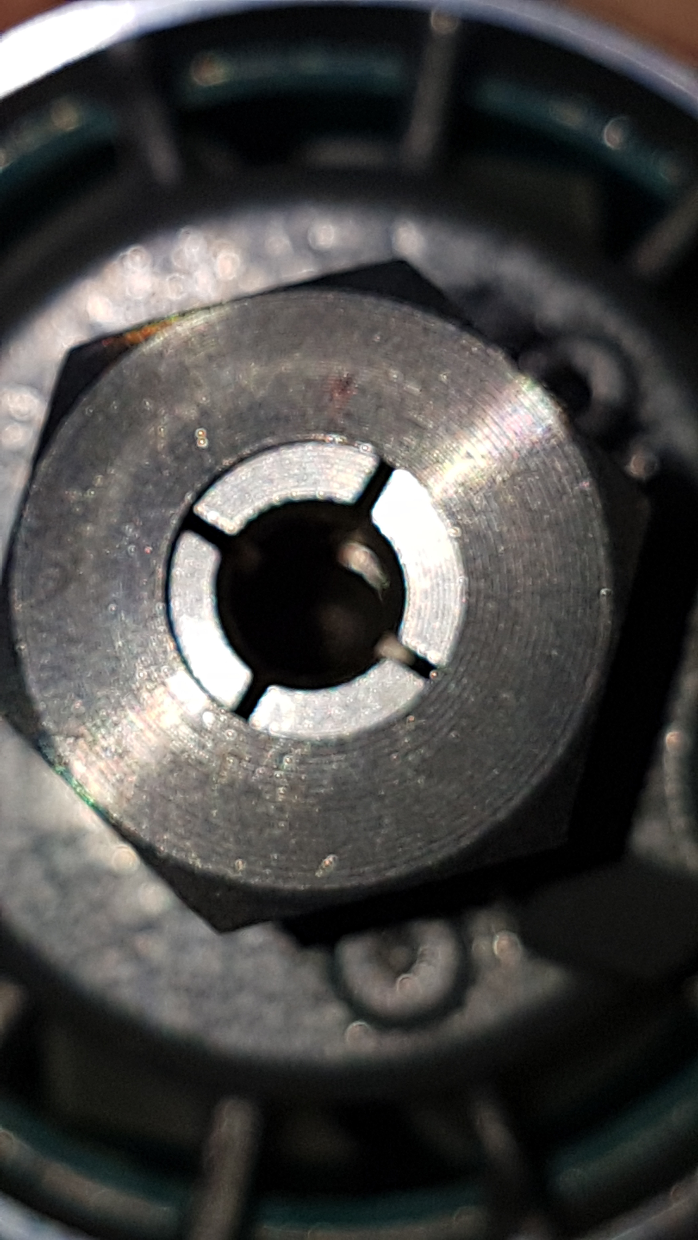

Is it me, or is that hole in the collet nut not central… culprit I believe
Yeah that looks suspect. You get what you pay for with these things.
