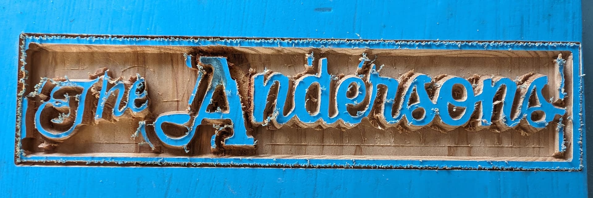

With a tool change, the Y axis changes dramatically
I could use the forum’s expertise in helping me troubleshoot this issue. I carved this in a vertical orientation, so it looks like the X axis is off, but it’s really the Y axis. My Primo has dual end-stops, and they are solid. I perform an x/y/z home after the tool change. But, for some reason, the Y axis is off by about a quarter inch. I’m hogging this sign-out with a 1/8" up-cut bit, then doing the carving with a 45 degree V-bit. I’m using Estlcam 11.245_A_64.

Where did you put the home? Is home for the project at 0/0/0? If not, after homing it might not know where home is.
Is your stock mounted at the machine 0,0? If not, can you upload the full g-code file? Even if you are mounting at 0,0, it might be helpful to see the first part of the g-code file.
There are some things you’ve done in this code that are a bit strange, but I don’t see anything that would cause a 1/4" Y axis slip. Personally, I don’t disengage the steppers when I change tools.
One troubleshooting step would be to run the script again with the router turned off and the bit in the air to see if the problem reoccurs when not cutting. Use a nail or other pointed object to mark the original origin before bit change.
Home is 0,0,0. @Philipp , I’m not sure what you mean by “after homing, it might not know where home is”. The point of homing is to ensure that “home” is always in the same place. I home it at the job start, and then I home it after the tool change.

Yes, your “machine home” is always at the same place, but “workpiece home” might be somewhere else. So basically the question about absolute and relative coordinates.
Let’s say you square the machine and then drive 2 inches to the workpiece and set X to 0. After the toolchange, running your squaring/homing again, did you maybe forget to drive it those two inches again?

There is no grinding or tooth-skipping going-on. Over the years, I’ve experienced that, and that would have been a pretty obvious call-out. In this case, the tool change goes without a hitch. I don’t move the gantry during the tool change on this project. It simply carves in the wrong spot every time. I built this Primo about 3 years ago. I’ve done dozens of projects with tool changes without much trouble. However, I can’t remember when I last ran a project that required a tool change. As a result, it’s tough to pinpoint WHEN this issue started happening. When I head to the shop, I’ll also check the SKR Pro firmware and update if-needed.

Are you able to change your tool without disabling steppers? that way x/y stay where they are and you will not have a chance of setting your 0 wrong. When I do tool changes, I raised, changed, probed and resumed.

I changed my config to NOT disable the XYZ steppers, and I eliminated the XY home and left the Z home after the tool change. Additionally, the SKR Pro firmware is updated and so is the TFT firmware. Thanks to Ryan for reminding me that this has a touch interface, I’m getting used to that now.
The carve is now clean after the tool change that I attribute to the locked XY steppers. But, the HOME XYZ should have solved that. I haven’t gone through the dual end-stop set-up and troubleshooting yet. I’ll do that later when I have more time.
