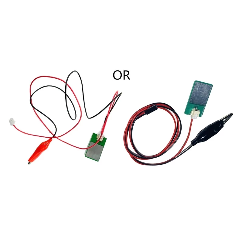

Also I found a touchplate for CNC sold locally - wondering if it is usable on the Lowrider or if they’re specific to machines/programs?
I added a photo of the options available in the listing, there looks like two types.
If it helps, the instructions in the listing state:
”Set the tool operating instructions on the software, or directly enter the instructions (Instructions: G90G21G38.2Z-50F100; G92Z1.6; G0Z20). (Different software interfaces are different, but the instructions are the same.)”
Cheers
For the touchplate, a piece of aluminium foil also works, so yes, those should work.

Thanks, I ordered the touchplate.:+1:

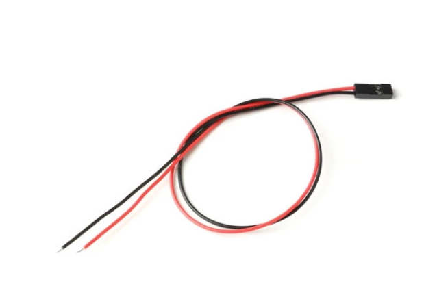

Another quick wiring question. To save me the hassle of crimping dupont connectors, could I buy ready made cables, then just connect to create longer lengths?
So for endstops - I can get the 2 pin dupont wires in 30cm lengths, then I’d use wire connectors to connect to longer wires ending in the spade connectors/endstop. (See photos below)
Any problems or issues that could arise doing this?
You absolutely can use ‘pigtail’ cables with the connectors already crimped. Wire connectors have a smallest and largest size cable they are designed for, so long as the wire you’re using is within that bracket it’s fine.
