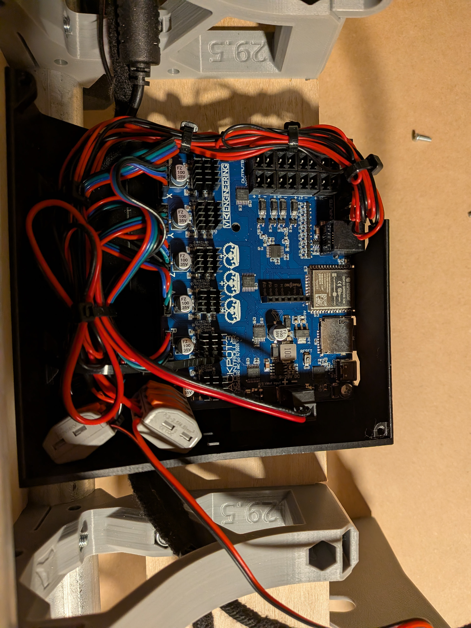

My machine is built, will zero and move about manually in fluid NC. Everything seems fine until I start running gcode. About 1 minute into the run I get red flag of “connection dropped” and “socket error”

Can you post a picture of your controller, as wired and as installed, in your machine?

You mean a pic of the jackpot? I can get that - it was built by Northwoods so just need take the cover off
Is this helpful at all?

the antennas on most esp32 are pretty bad. I wouldnt recommend running anything over the air. I copy all my stuff to the sd card and run it from there. that way if the network blips you don’t lose the stream of your gcode.
