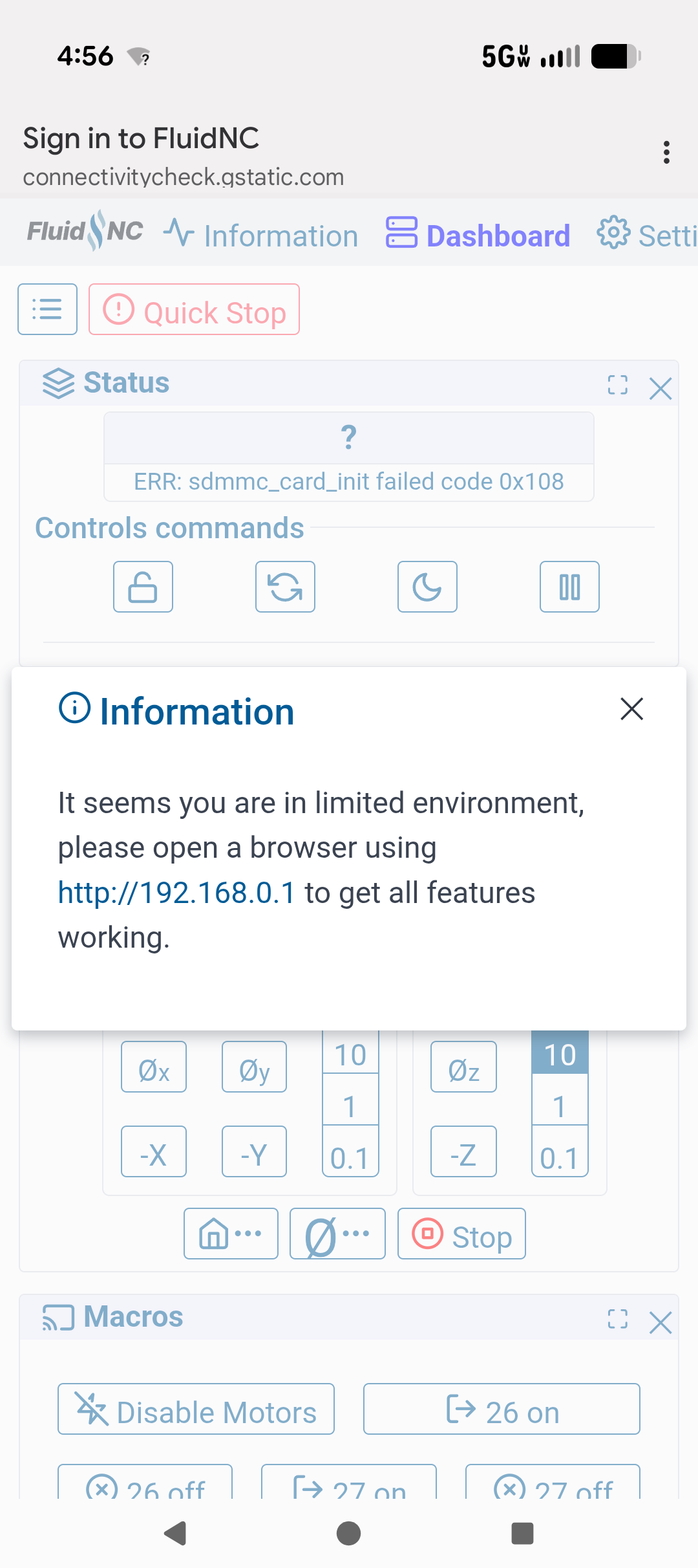

It absolutely does. A PC browser actually has a pop up window with a clickable link to open the right window. Android actually gets the pop up as well, usually, but is not clickable.
If you want a screenshot of an android browser tell me what one you are using and I will get it for you. In android it opens up a captured portal, it is not a full browser. you have to connect to Fluidnc ssid, that will pop up what looks like a browser window. if you can not see the accept network try minimizing that window, open your real browser, and go to 192.168.0.1

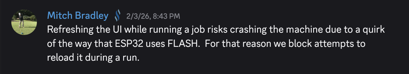

I just came across this post on the FluidNC Discord by Mitch. It might be relevant to your situation:
Are you trying to refresh the WebUI while a job is running?
no. not trying to refresh. just trying to run a gcode without my connection dropping.
thanks though.

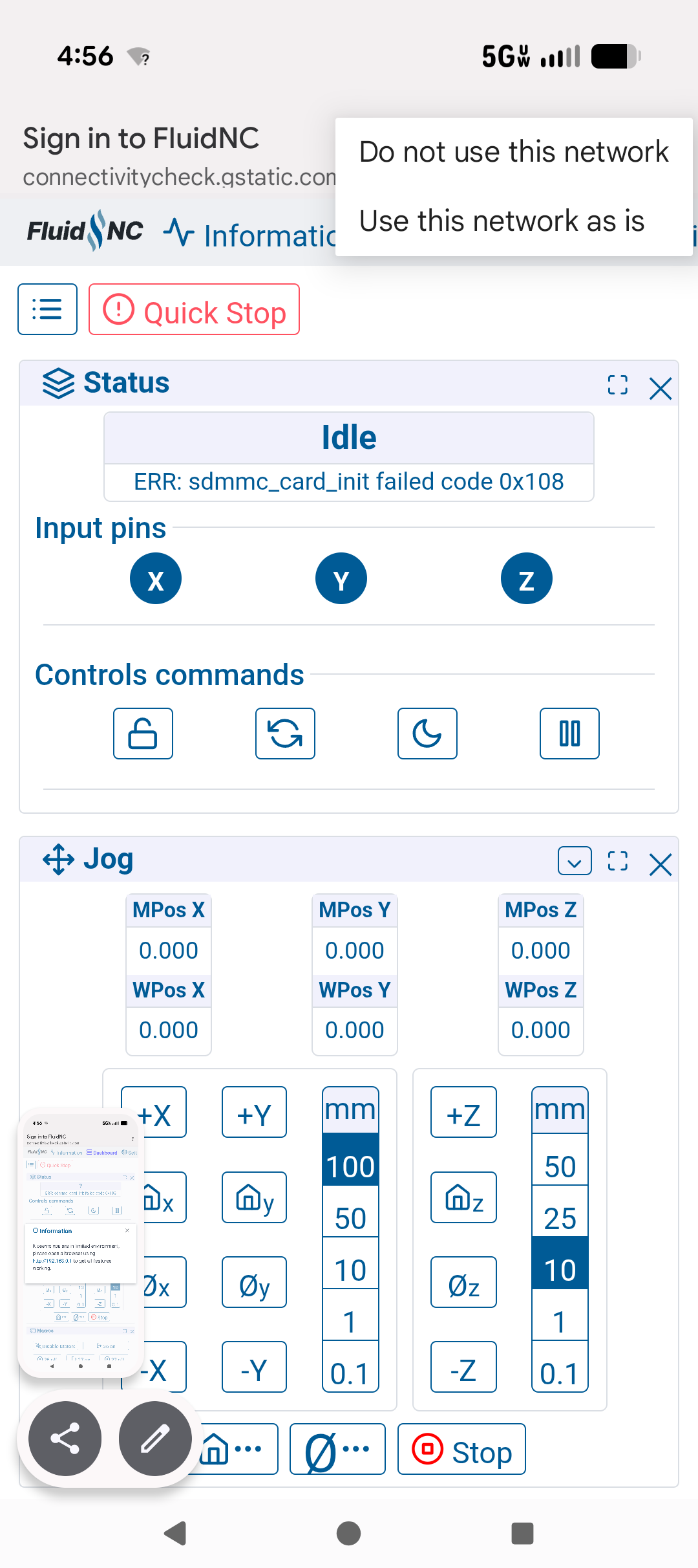

okay here is the steps.

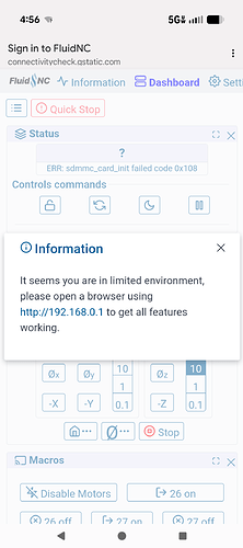

connect to fluidnc and you will see this pop up

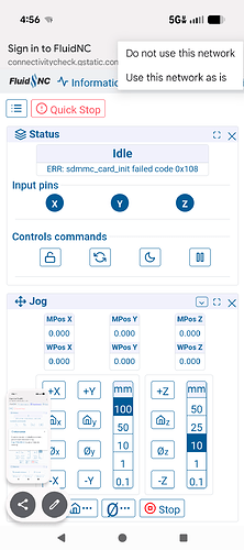

that link works on a pc, not on android. so on a pc click that and you are in. on the android close that pop up out, click the three little dots in the upper right corner
you will see this screen
click use this network as is.
that will kick you out of the browser. open chrome, go to 192.168.0.1, best to just make a bookmark.
it should work from there.
