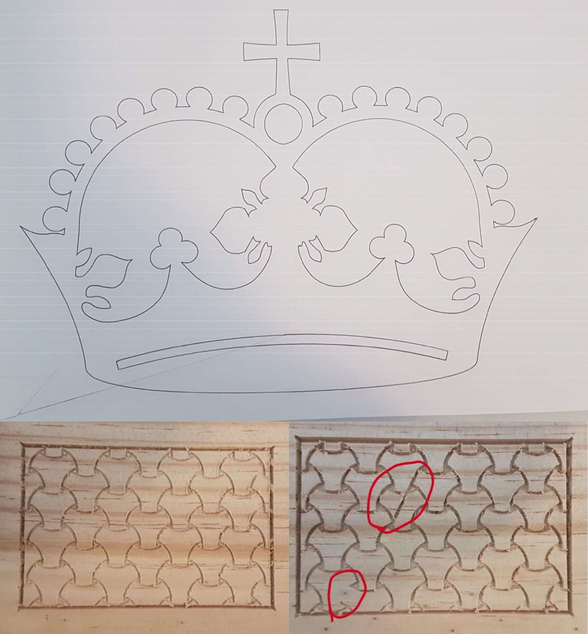

Hello, I am trying to cut with my MPCNC but am getting inconsistent results. The machine randomly skips parts of the G-code or makes random lines as it is cutting. Originally, I used Estlcam as instructed but after the issue persisted, I tried using Fusion360 with the “MPCNC milling and laser” post processor by flyfisher604 (That I read about in another forum). I am using a Ramps1.4 running on Marlin (that was provided on the V1 website, I just adjusted it to match my MPCNC). I chose Ramps1.4 as all other controllers were sold out when I tried to buy them.
It worked just fine when drawing with a pen plotter (See crown drawing) so I assumed it could be EMI from the spindle or stepper motors. I am using a Ryobi 400W trim router for now, but plan on upgrading it when I can get the MPCNC working. In response to suspected EMI, I added ferrite beads, twisted wires, added decoupling capacitors, grounded all the metal rails, and added shielding to the controller. This fixed my issue of some random “shakes” but not my random lines. I tried increasing the power supply also in case it simply didn’t have enough power to control all 5 steppers at once, but now that it is running on 12v 40A I doubt that is the issue. Also, I checked the wiring connections with a multimeter and they all seem to be fine.
After running more simple “2D” cuts with a V-bit rather than 3D cuts, I discovered that the inconsistency is a random error as the same g-code would sometimes works perfectly and sometimes fail. I have attached 2 images that I cut in pine, allowing you to see the different results. This makes me believe that the g-code is not an issue.
The only thing I can think of is maybe my Ramps1.4 isn’t up to the task. Before I invest in a more powerful controller I wanted to ask if anyone had any advice for me, or any recommendations for a controller? I know that the V1 website recommends UltiMachine boards or SKR Pro. I am in no way an expert with CNC’s but would love to learn. I hope this will be useful for someone else and thank you for anyone who is willing to help (:

Ok I will keep using the SD card. None of the motors are hot to the touch after/during cutting, I had forgot to set the current limit on some drivers originally and I think that lead to some being burnt out. I think my issue is more about the Ramps1.4 “miss reading” the g-code as it seems to “forget” to raise the bit when moving or not cut entire sections. I could be wrong, but if it was skipping steps I would imagine that the rest of the print would be slightly offset, whereas mine still proceeds to cut the remainder of the project correctly. Thanks for your help so far.

i had a similar problem on my lr3. turns out it was a mechanical issue. the z axis was binding up not allowing free movement up and down which caused cutting along the travel path. looks similar to what you’re getting from the big circle in the image
Thank you for the reply, I checked out my z-axis and it seems to be running fairly smoothly. Since the programme skipped out entirely on one section when cutting I think that it might be an issue like Dan “SupraGuy” said. But all things checked eliminates another potential issue!
V-bit carving is extremely sensitive to variations in the height of your stock. When I look at your carving, I see variations in the line width indicating that you have an uneven top surface. This could account for your problems. You might try increasing your clearance height and surfacing the top of your board before you v-carve.

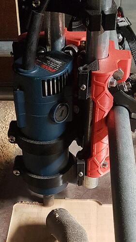

Check for looseness in the Z axis and any potential interference such as the cord impinging or the mount rubbing on the bolt head holding the bearings.
I agree with Robertbu about the controller. He did jog my memory about a problem from long ago… Shortly after building my MPCNC , I had some
projects fail , random lines. It turned out that one of captive nuts in the core for mounting tool heads backed out. when I mounted the tool head the nut did not go all the way back in, but did tighten. Under the right load; the nut would hang up on the guides as the Z moved up and down. This random hanging up of the Z kind of explains the failures, yet the rest of the project is still the proper placement

It does look like corrupted commands to me.
If the same code is run twice, does it do tha same thing? That could be trouble with the SD card itself.

In the original 2 images of the pattern cut in wood, that was the same g-code cut minutes after each other. The SD card I am using is a “SanDisk ultra 32gb micro A1 SD card”.
Thanks Robert, my machine is luckily running very smoothly in terms of mechanical issues, but I am happy to check any specific bolts/screws. I couldn’t find any loose or overtightened bolts in the core (with only a quick check). I should point out that my z-core clamps are modified to simply have an area for me to slide in a 8mm steel rod for my dust shoe. When I modified them I didn’t change any part of the original file but simply added a “tube”. I had this issue before I added them and they don’t interfere with anything. Currently I have not finished designing my dust shoe. I have attached a photo of the modified z-core clamps.
Also, as you pointed out that the workpiece is not flat, this is very true, this is because I haven’t made proper clamps for my CNC table yet. I will definitely be fixing that after I can work out the reliability issue, but for now it is flat to around 0.5mm.
also current photos incase there is an obvious issue to anyone that I have missed (I do however have a 6mm MDF spoil board in the cut out now).
