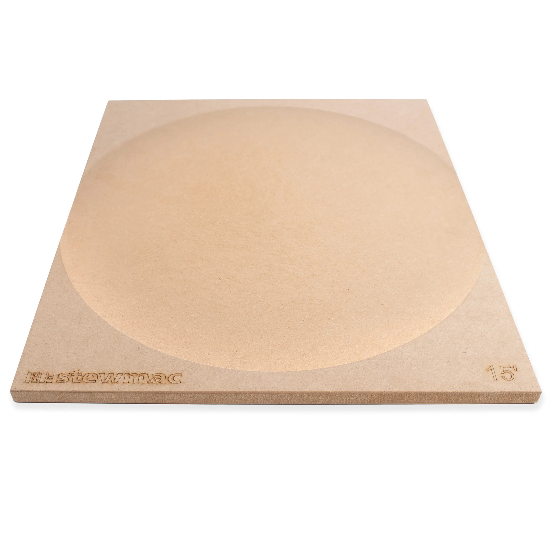

I’m making radius sanding dishes for acoustic guitar building. Basically I need to carve a section of a 25’/8 meter sphere into some mdf like this:

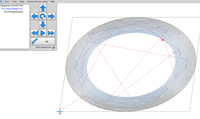

I’ve already carved one using the linear cutting option in estlcam’s 3d machining interface. But it seems like the correct way to do this is have the tool spiral down. However, when I use the waterline machining option I get weird disjointed paths like these:
I’ve experimented with different settings but can’t figure out how to get rid of these. One guess is that this is coming from using an stl to represent such a gradual curve. Any other ides of how to get estlcam to generate a non-disjointed tool path?

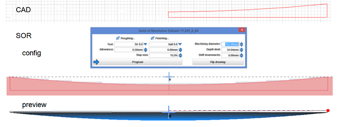

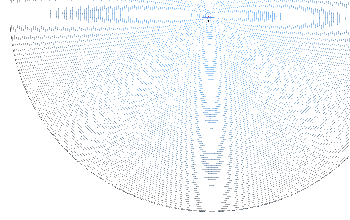

The v11 (Automatic Functions >) Solid of Revolution isn’t perfect, but its ability to spiral cut any shape from half a 2D cross section is pretty handy/cool.

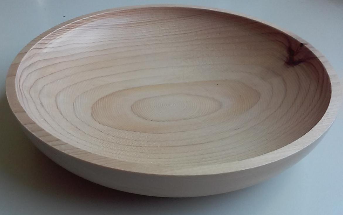

That looks like a perfect starting project. How did you fo the bottom side?
This looks perfect! I’ll check it out. So it’s only on version 11?

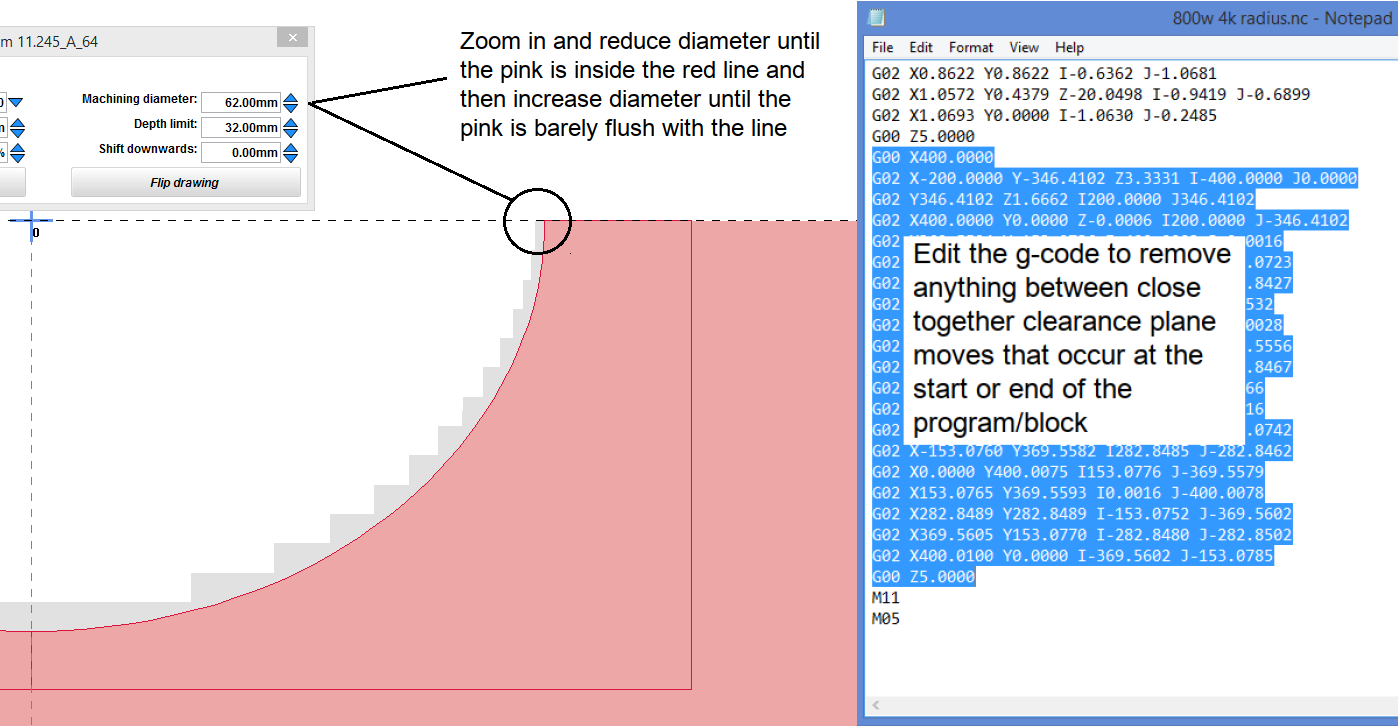

To simplify my earlier post: Set inside only Machining diameter to ‘cut diameter - tool diameter’. Remove the end of the finishing block/program clearance plane move and all lines up to the second to last clearance plane move. While they won’t do serious damage, they are out of bounds and the Z0 DOC can leave a very subtle mark on the uncut surface.
Example G-code preview shows the fully cut bowl (green) and what’s left (red) after the second to last clearance plane move.
