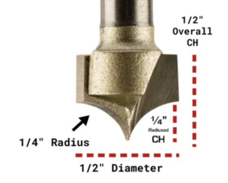

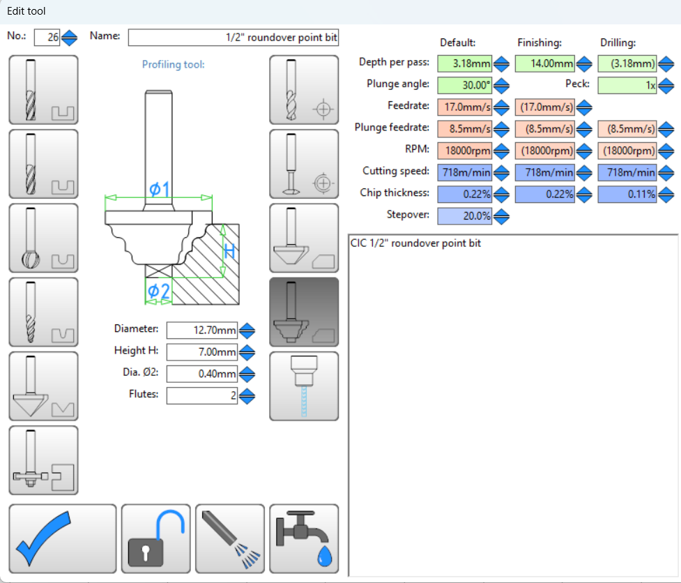

Do I use a ‘profiling tool’ profile to define it?
Or do I use the ‘tool with radius’ and put in a negative radius?
Anyone tried to do this with this type of bit?

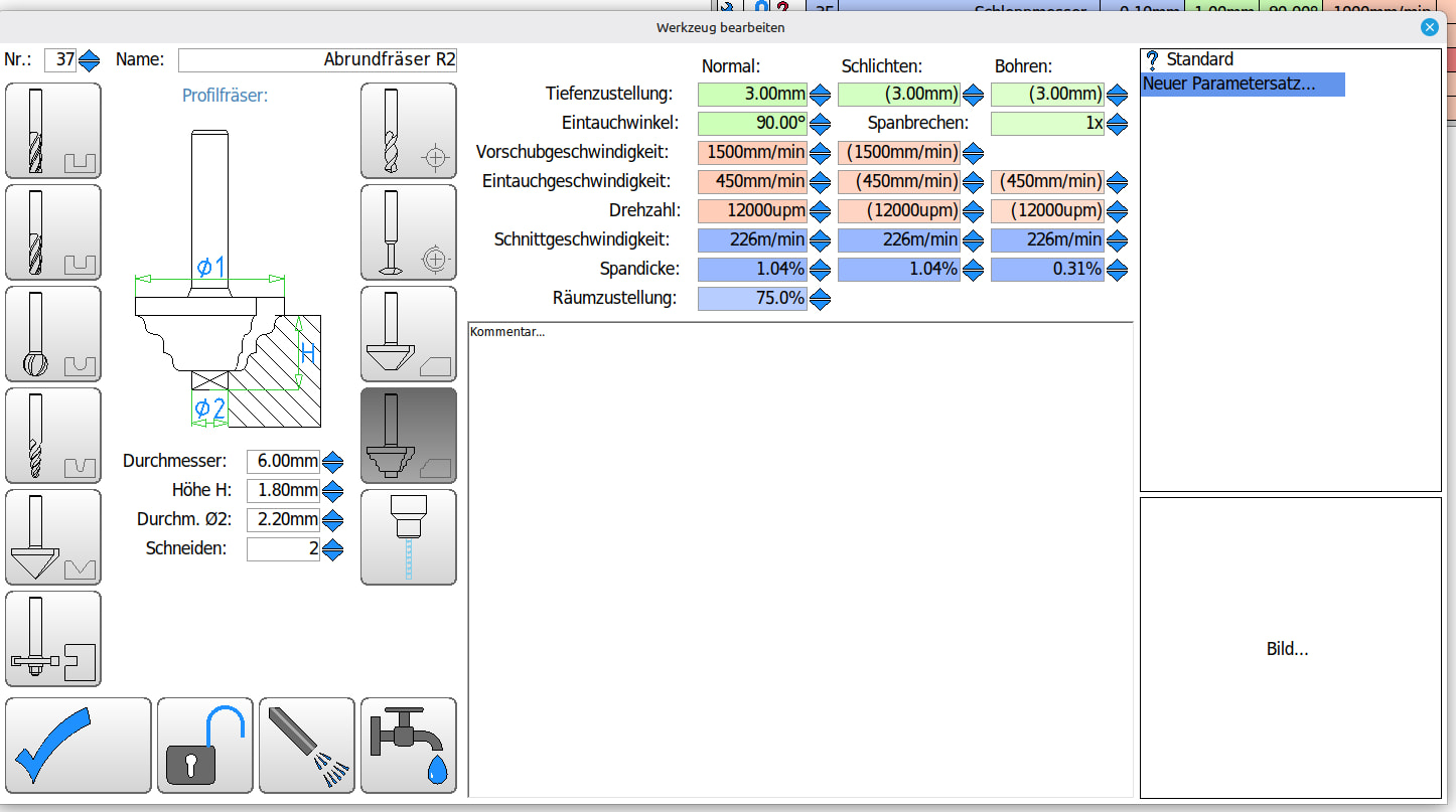

These are my settings for a 2mm roundover endmill. There is a tutorial by Christian from Estlcam where he explains how it works. I set the height lower and the diameter a little bigger so that I would not have some edges if the wood is a little off.
Philipp I’m looking for that tutorial and haven’t found it yet. I only know how to say cookies please in German . If you come across it, please post. I’ll still look since what I did, didn’t seem correct.
It helped a little. I’m guessing EstlCAM doesn’t care about the radius and leaves that up to me to determine how deep to go as Cesar does/said. If so then I think I get it and will need to experiment with it.
