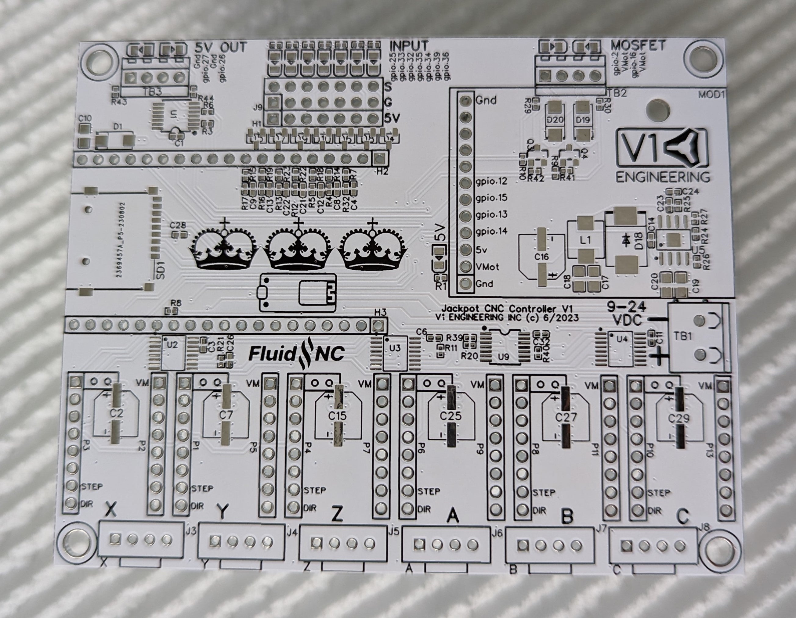

Where can I find some original Jackpot boards?
Not a fan of the newer boards with everything incorporated and no room for expansion.

I’m a fan of well built and modular. I understand the obsession with driving down costs, but…
  1. I’ve had a few stepper drivers burn out on me. With the original board you can pop in a new TMC for $2.50. With the new board? Throw it out I guess.
  2. If you want to make some mods to the firmware or the ESP is acting up… With the original board you just power it off, pull the ESP, take it to your desk and do your thing. With the new you have to disconnect everything from the board and remove the board from your machine. I haven’t cooked an ESP yet, but if you do on the new board … throw it out I guess.
  3. If you want to drive some external, high current, stepper drivers. With the original you pop out a TMC and fashion a plug, connect it to the socket and your off. Now … not possible.
  4. Finally, this is minor and very niche, but it was what I was referring to with expansion… The original boards had four extra pins on the expansion socket with nothing connected to them. Really handy for jumping things to with wires under the board - like a 3.3v rail for example.

I can understand that, I like modular boards also. I’m curious what features you’d want in a modular/expandable board. A successor to Jackpot V1. For example- access to all the IO on an ESP-32C3.
True, the strategy with Jackpot V3 is to deliver a board with 6 drivers when the target application- LR4- only needs 5. Yes, you’re buying a technically unneeded driver, but also saving assembly costs due to less through hole component soldering. You get single-fault resiliance at a fairly low overall cost.

To spell out the design philosophy a bit more. This is the best CNC, V1 CNC, board I can make for the money. I love for it to be used for more but Bart has lots of fantastic options for the wild uses. Designing for the 3 uses per 1,000 sold is not as interesting for me. I want this to be the best easiest most cost-effective for v1 CNC builders.
To address the above more specifically.
  • Once the boards are flashed from me, they are able to be flashed OTA.
  • Barring the 6-7 bad drivers in this last batch, popping a driver is extremely rare. Like 5-6 in 10 years, and we have a spare (or 4th axis).
  • I don’t see a need for more memory anymore, and I never maintained my own custom firmware to make use of it so it was wastefull.
  • bart has an inexpensive external driver board, why pay for the JP1’s included drivers if you are not going to use them.
  • soldered in expansion is not on the radar for me. There is lots of ways to expand the FluidNC boards these days.
  • Me needing to source the drivers and esp32’s separately, then unpackage and assemble, is a major cost in time that the jp3 does not have.
I am not trying to be rude, just trying to be very clear on why we did these things. RepRap, and a specifically designed CNC that is easily sourced all over the globe has razor thin margins. Most people do not buy anything from us. So when they do I want it to be the best for the products I support. The Jackpot line has become a major contributor to the income keeping this company moving. If I make a board that is too expensive people will move right on to something else. Heck you can still get a bunch of other 5 driver boards for under $30.

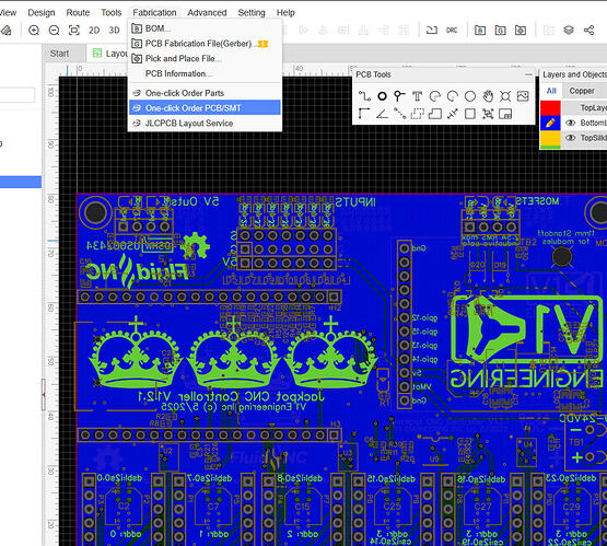

I have no idea what orders you’re seeing and/or how much hassle tariffs are causing you, but… if significant number of Customers are buying JackPot separately from your CNC/Machine kits, then, have you considered selling bare Jackpot 1 boards? SMT assembled, BUT, customers need to bring their own drivers and ESP32s. You only pack the assembled PCB as received from the Fab.
I appreciate O.G. JackPot fans can always get a board fab’d via https://oshwlab.com/allted/4layer-desktop-rc1_copy

I’ve never figured out how exactly to have them make a board. Has anyone actually made one from that source?
That is how I do it. When it is open in the editor there are three options,
If you’re super adventurous…
