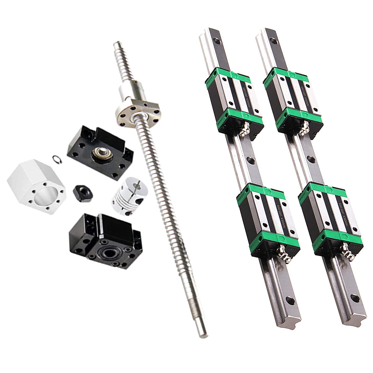

What I really need is for it to use the 1500mm linear rails and ball screws I just bought so I don’t have to design my own machine :slight_smile: And be stiff enough to push around a 2.2kw water-cooled spindle.

Well originally I had made room for the linear rails on the X axis at least, now I am rethinking that…but there might be an option to replace the round rails with some printed parts and linear rails. I am keeping that in the back of my mind…So far 23s will fit if you really feel the need for that. :shushing_face:
Have not gotten to the leadscrew part yet. Link to your screw dims?

I went with this kit. I found it’s pretty well put together. The ball screw is slightly longer than the linear rails to make sure you have full use of the linear rail.
That is a good price! I am going to have to take a look at the 1204 and 1605 just to see the weight difference. Seems like it might be significant. I would really like to use the MGN12h’s just so if I do buy them they work in the Repeat as well, but not set in stone. I want to make it compatible…but probably not come stock. I am desperately trying to gain performance and lower the cost.
So for stock Z travel what are we thinking, 4-6"? I of course would do my best to make it possible to go more, but I have never needed more than 4" it and if we are homing to Z max tall builds waste time.
why not split the difference and go with 5. I think most people cut sheet goods so probably max 1" of material + 1.5" cutting bit length + .75" for a standard touch pad + 1.75" to get a dust skirt under the bit and into the 611 plate. 5"ish seems to be standard for most of the hobby machines out there as well
