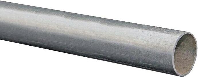

Here in Spain, you can find 32mm EMT easily. It cost about 14€ for 3 meters long.
Link:
https://www.obramat.es/tubo-metalico-enchufable-o32mm-3-metros-10164553.html
Specs:
Thank you!
Awesome thank you!
That’s super interesting. That’s 32mm with a +0/-0.4mm tolerance range, so it’s directly equivalent to 31.8mm tubing with a +/- 0.2mm tolerance, which means it’s basically 1.25" tube.

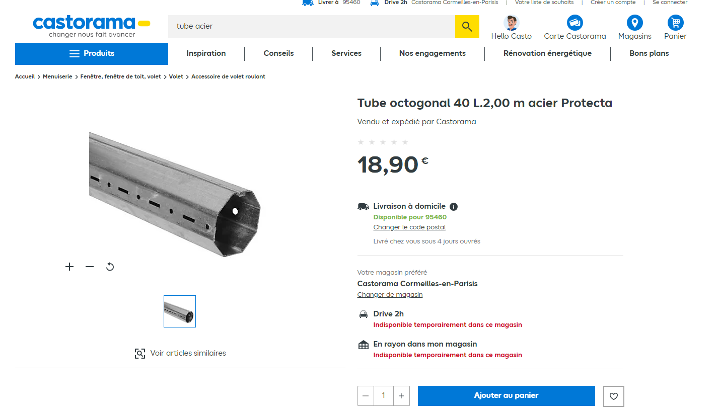

In France, you can easily find those in ā€œhome depotā€-like stores:
Steel tubes, 2m/2.5m/3m lengthes: 16mm, 20mm, 25mm, 50mm
Note: We also got this strange octogonal shaped 40mm or 60mm tube that could be very interesting to directly bolt the struts on…
Those look weird and not really stable. :sweat_smile:

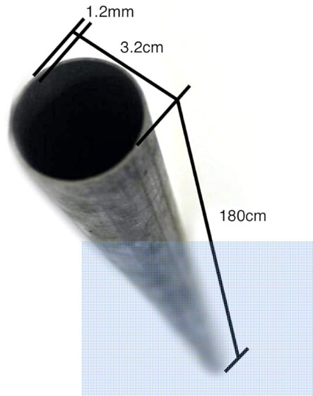

I discovered antenna mast tube on amazon, 32mm od 1.2mm wall. And relatively inexpensive too - any thoughts on suitability?
I don’t know whether 1.2mm might be too thin, but besides that if the measurements fit… You could try. :slight_smile:
this is where i got mine from,I recieved my order within a couple of days
Brilliant thank you that looks like a great option.
Looks exactly like the conduit I get.
Which one? The 1.2mm wall or the 2mm wall?
