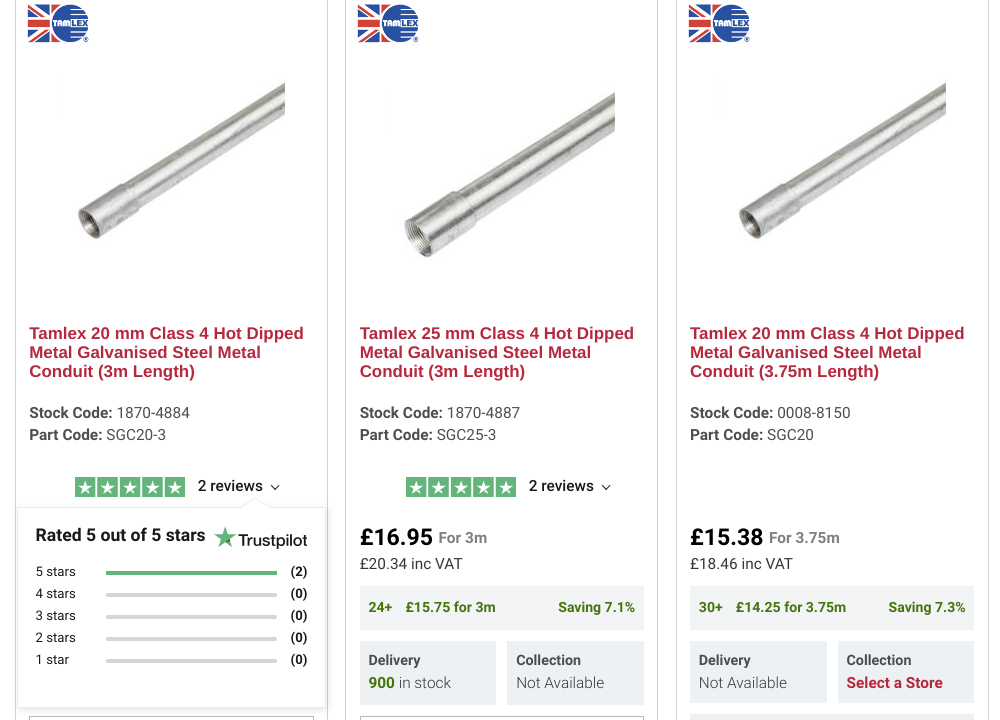

or
https://www.cef.co.uk/catalogue/categories/steel-conduit-hot-dipped-class-4-steel-conduit
That is the part I am trying to figure out. The conduit you are showing is considered ā€œrigidā€ conduit in the US, we are looking for thin walled or interior (it will not be threaded as it uses slip fit connectors). If that is available in your area the Outside dimensions will be very consistent. If it is not available in your area, it will need to be purchased from a metal supplier as ā€œTubingā€ at 30mmOD.
not a requirement. 30mm OD 1.5mm wall minimum, galvanized or stainless, seamless (or DOM) can be used if you wax it or something to help with rust.
