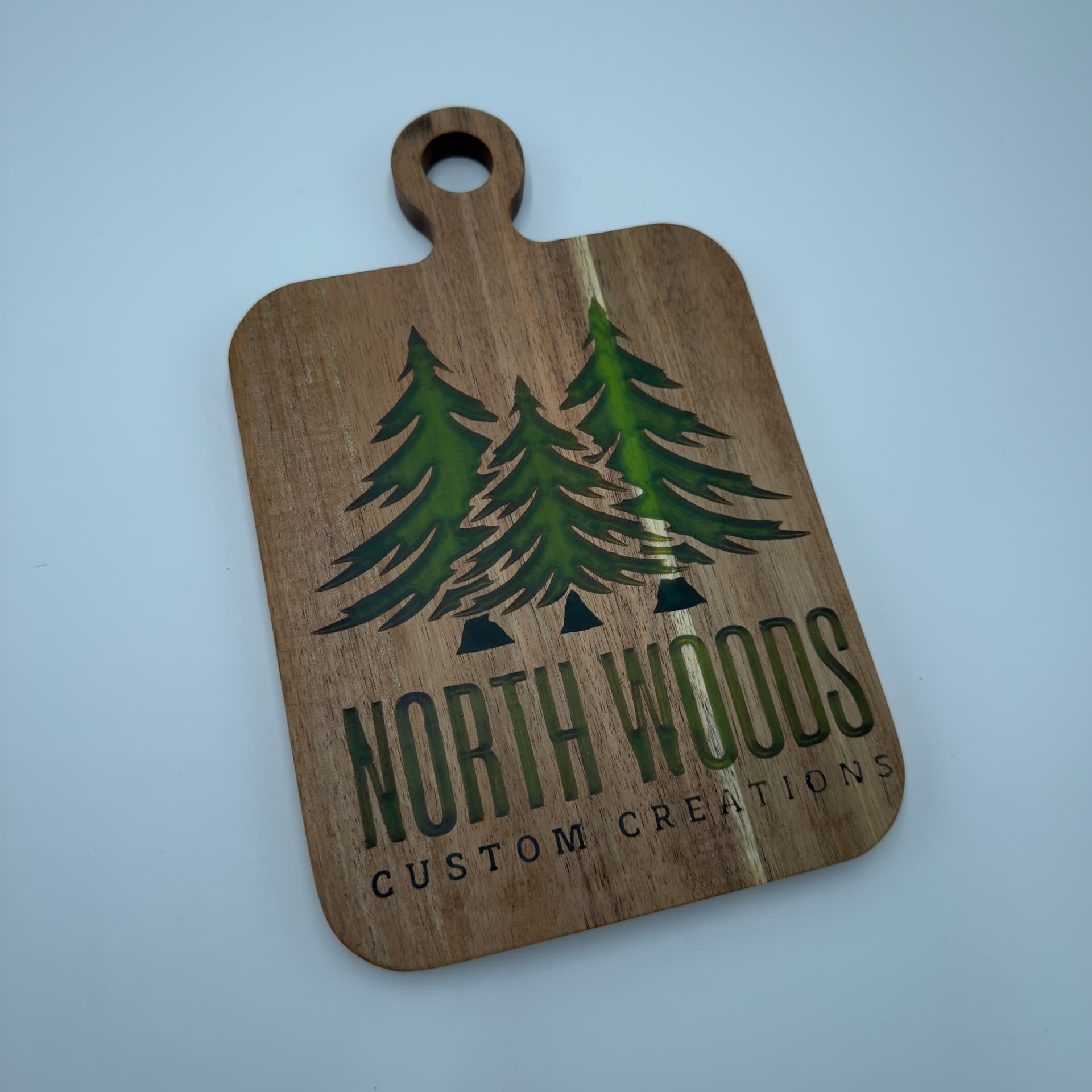

What I learned working with epoxy

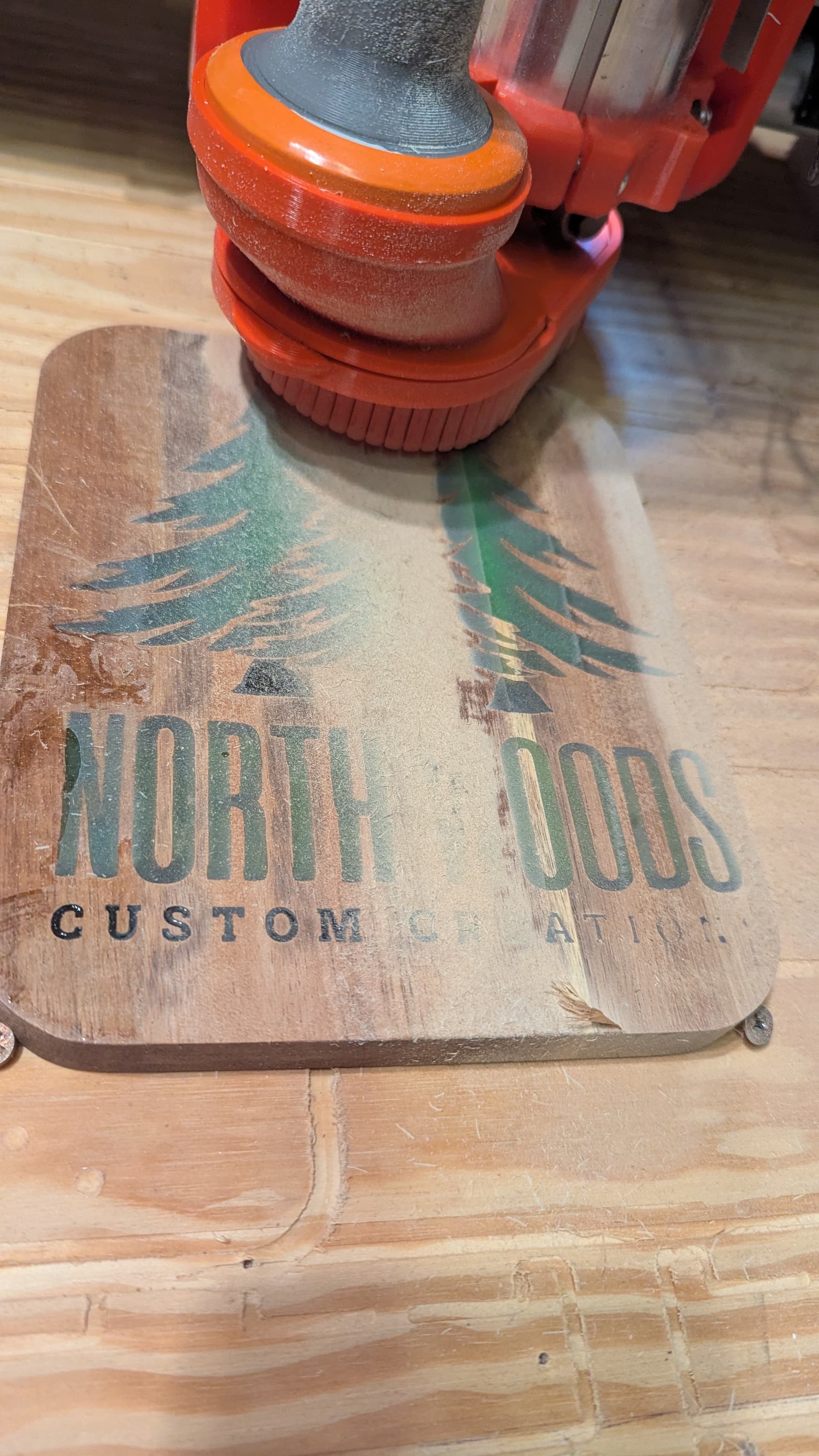

TLDR: be patient, ensure gantry is level, spoil is level, workpiece is flat. Make sure you have the right mill and there is no need to polish if a clear top coat is applied. (This isnt ai → @Tokoloshi, just longwinded).
Background: a while back I sent a request for older used skr or multichannel boards because through skill or lack of, a couple of my boards cooked in rapid succession on a couple different systems and since i use klipper, i can mix and match to get the number of channels needed. One power supply failed. One lit up a couple drivers… Anyway not good. I was able to get a couple used or nos boards at great and very reasonable rates from users here on the forum who had upgraded to the jackpot. These deals are greatly appreciated. @Jonathjon made me a deal that was too on-sided and refused to negotiate, so this was my attempt to even it a little and learn something. I had this piece of prototype product I held on for something just like this and so started on the design to make it into a custom piece.
Steps:

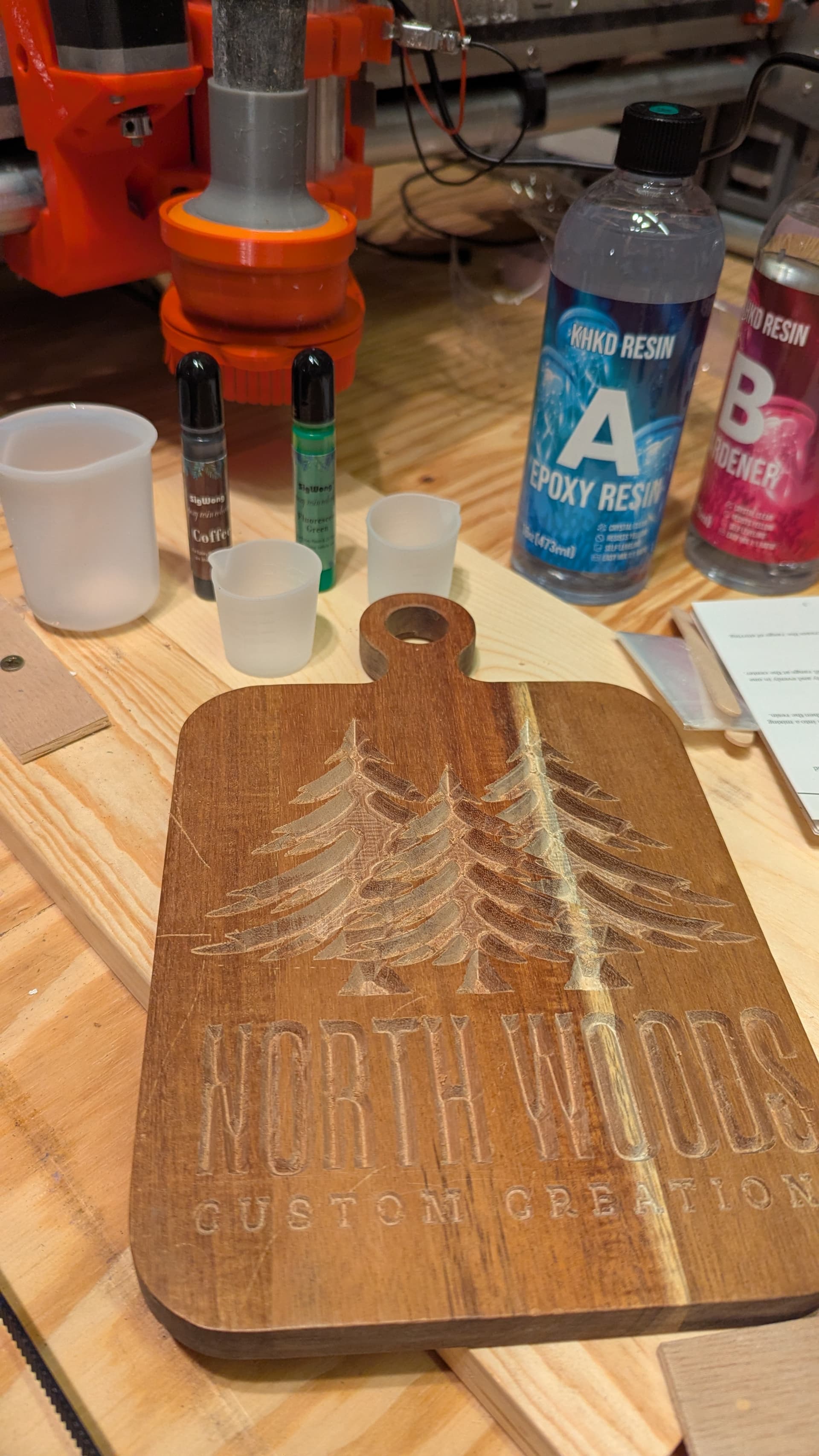

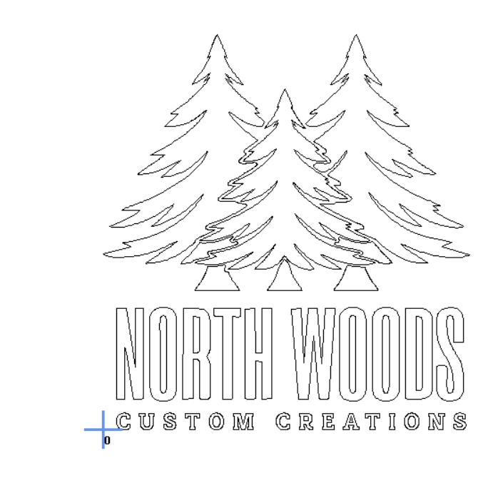

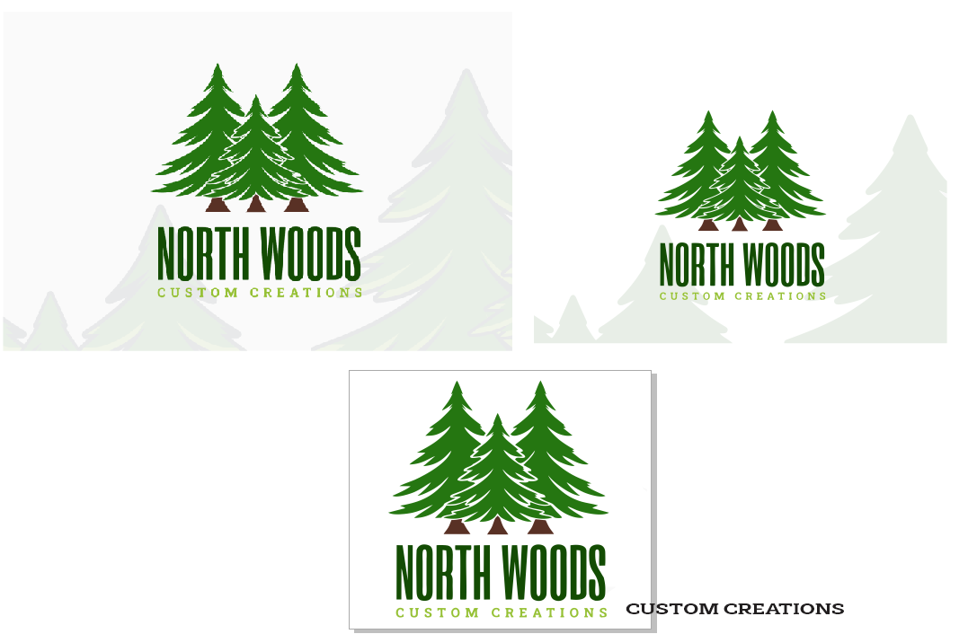

  1. “Acquire” logo. Pulled it off their web page and traced in corel draw and simplified it a little and found a close font.
    upper left is bitmap capture, upper right is initial trace. lower center in working box is the simplified logo and the font on the lower right is the closest match and with some scaling became the final.

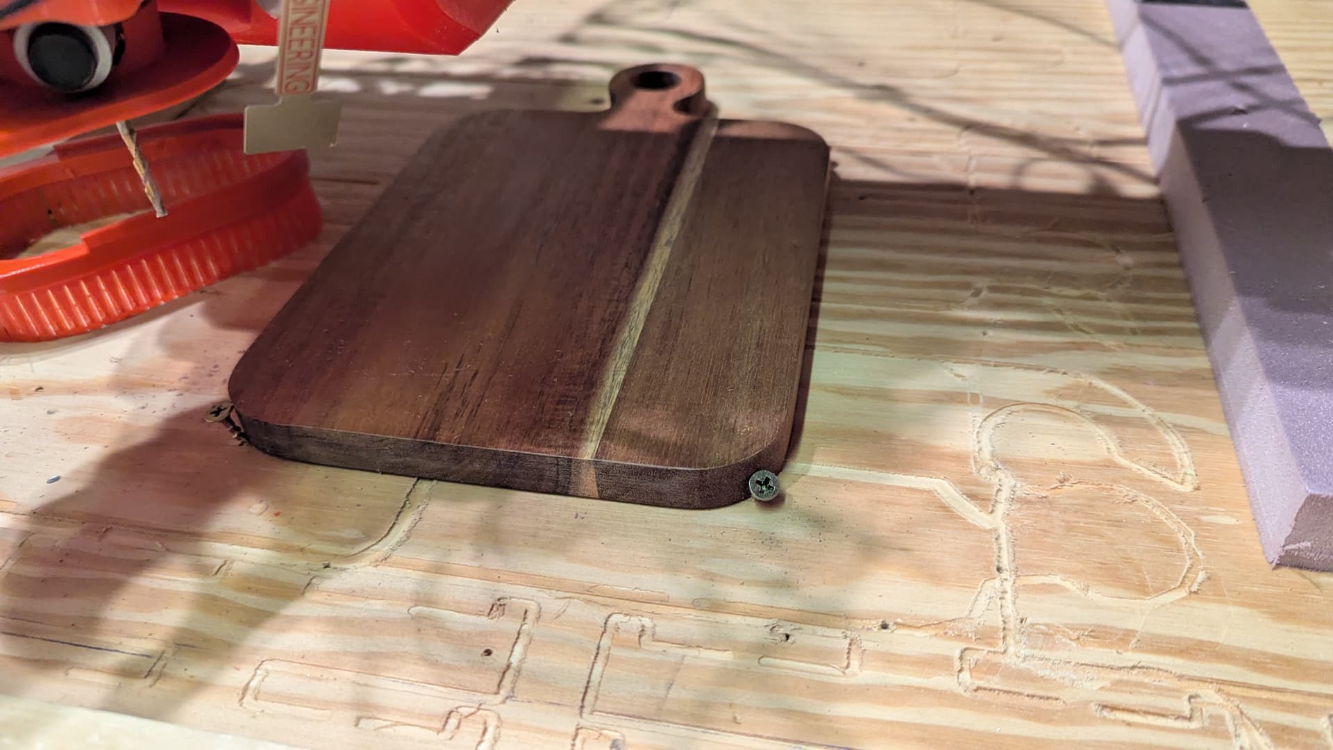

  2. Select workpiece

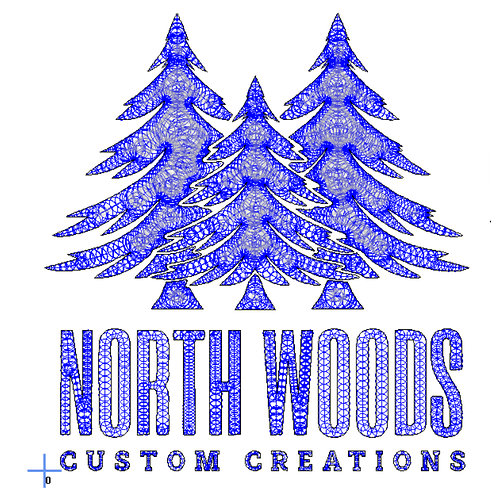

  3. Maybe a 1/16" end mill for the fine edgework with a 1/4" for the main pockets. Ordered 1/16" tool. Scaled to size, generated svg and pulled into estlcam.

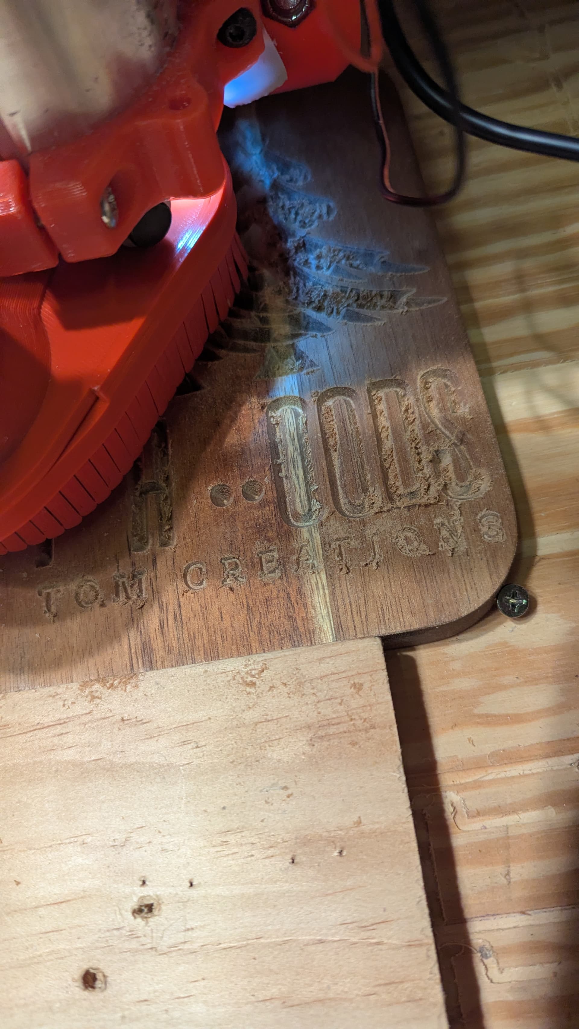

  4. Tool ended up being a drill not an endmill so i pivoted to a 60 deg v bit and set up estlcam as a carve 30 mm wide with a 1/8" endmill for the center pockets max 5 mm deep.
    Clean up fizzies that the 60 deg bit always leaves behind.

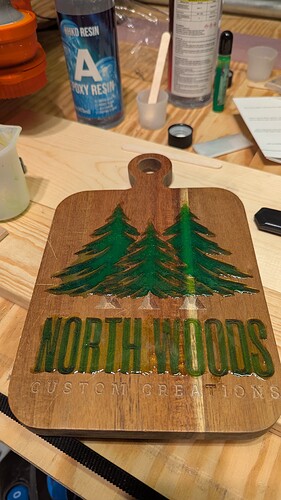

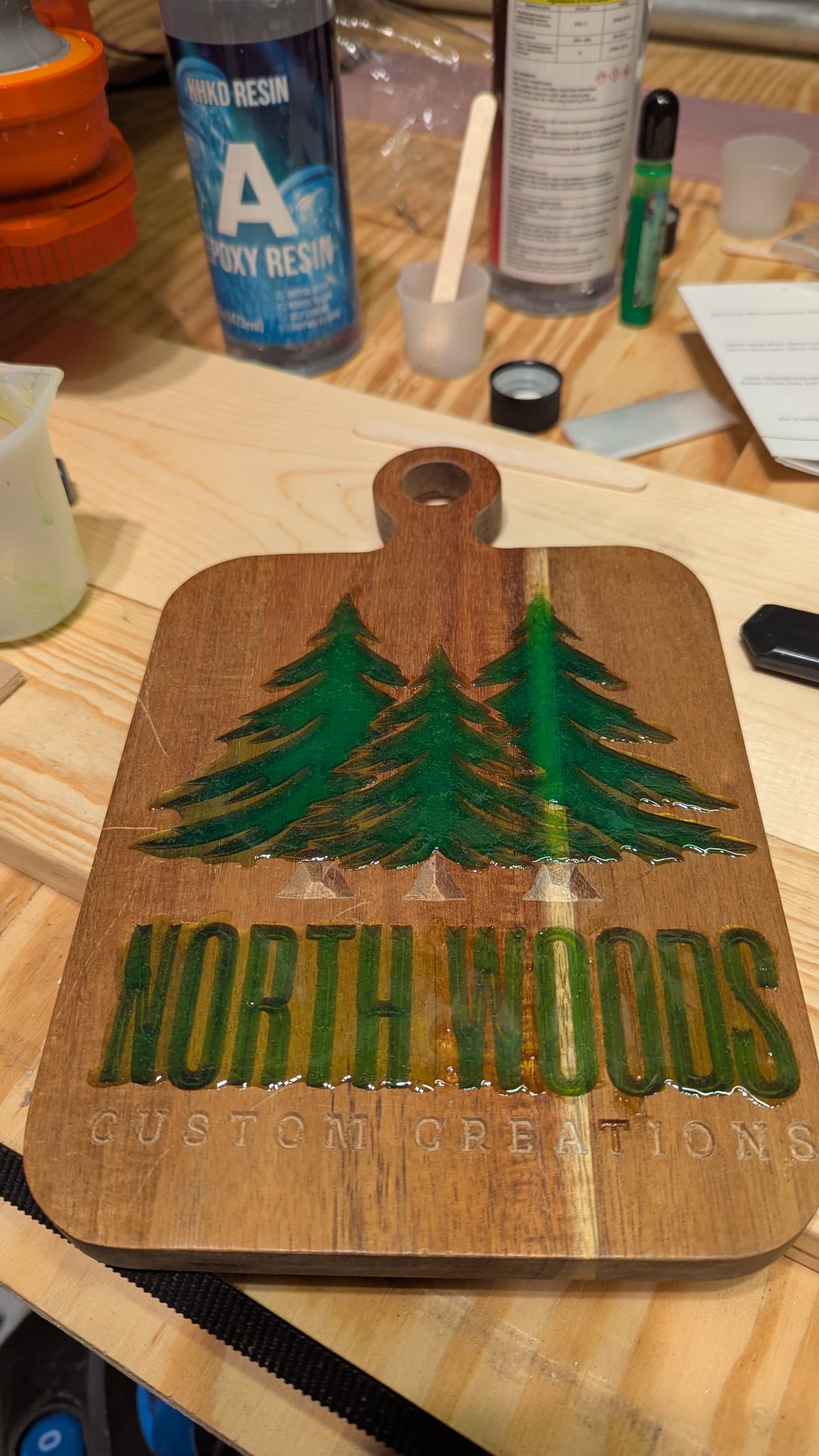

  5. Mixed 2 part epoxy and added coloring for tree tops and large letters.
Here is where i would do it differently.
  • dont remove from the cnc. Leave it mounted so your carve and final flat cut are parallel.
  • wait for a day for the first color to set before adding next color. Once they mix, there is no going back
  • be very careful to stay in your cut region and not overfill.
  • i knew about using the heat gun to boil out the bubbles. That works awesome.

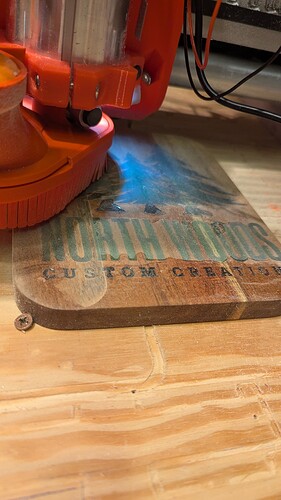

  1. Mix epoxy for second color for tree stumps and small lettering and waited a day for it to harden.
  2. Chuck up 1" flat mill for surface planing. And make esltcam hole pocket for planing. 2 mm total cut depth in 0.5 mm passes at 300 mm/min

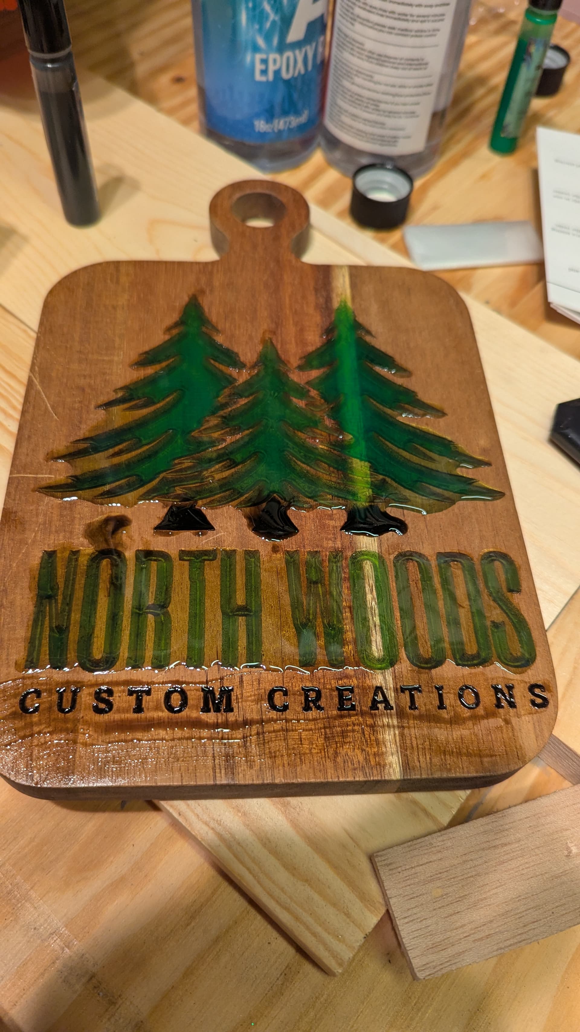

sand with fine grit, put on hardwood floor finish. I learned a ton. I hope after reading this you will brave an epoxy project the next time you have the opportunity.
photo credit to @CarmenJ and @Jonathjon for the finish photo and for overlooking its imperfections.
This forum makes cnc fun for me.

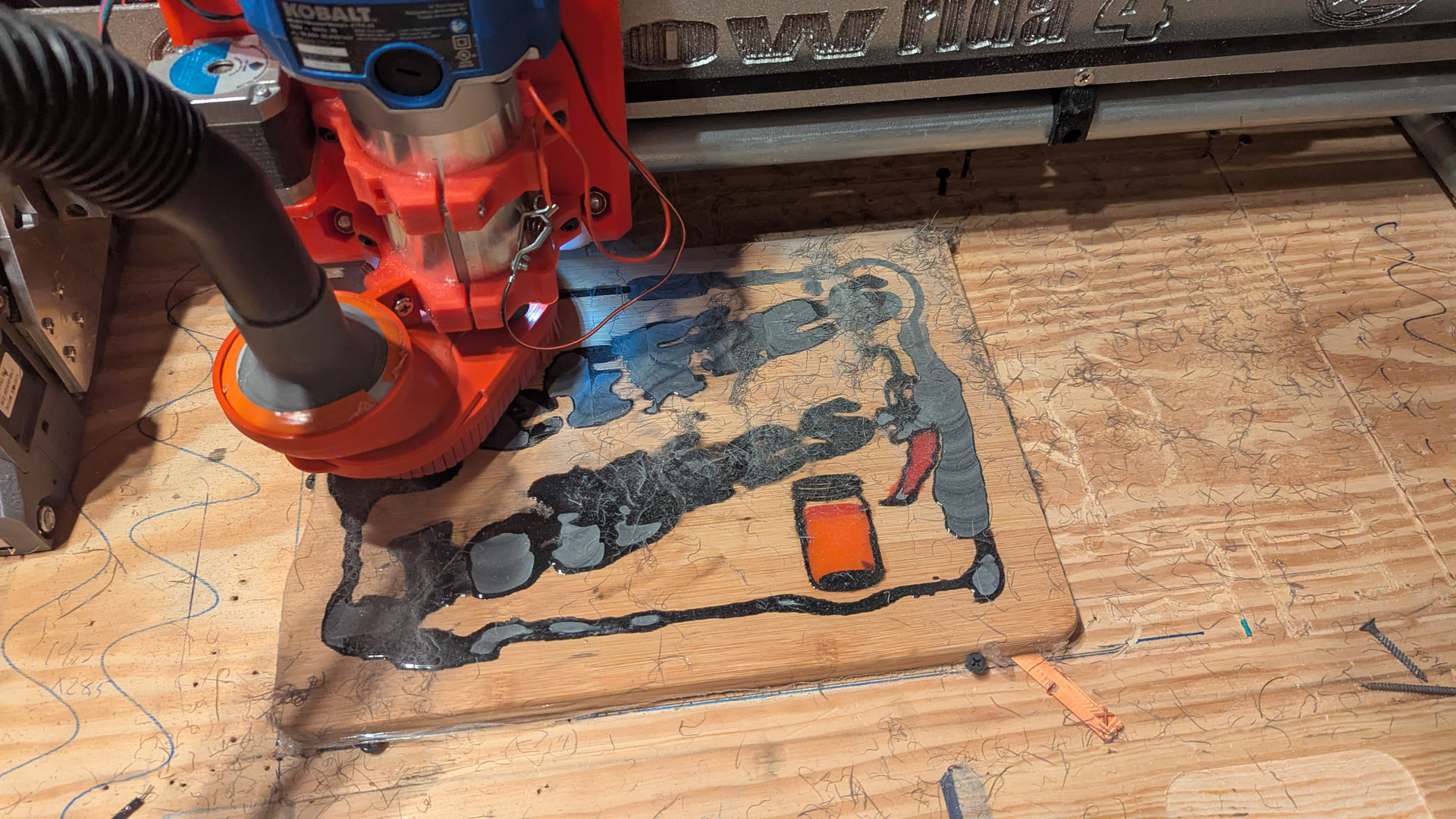

More on epoxy

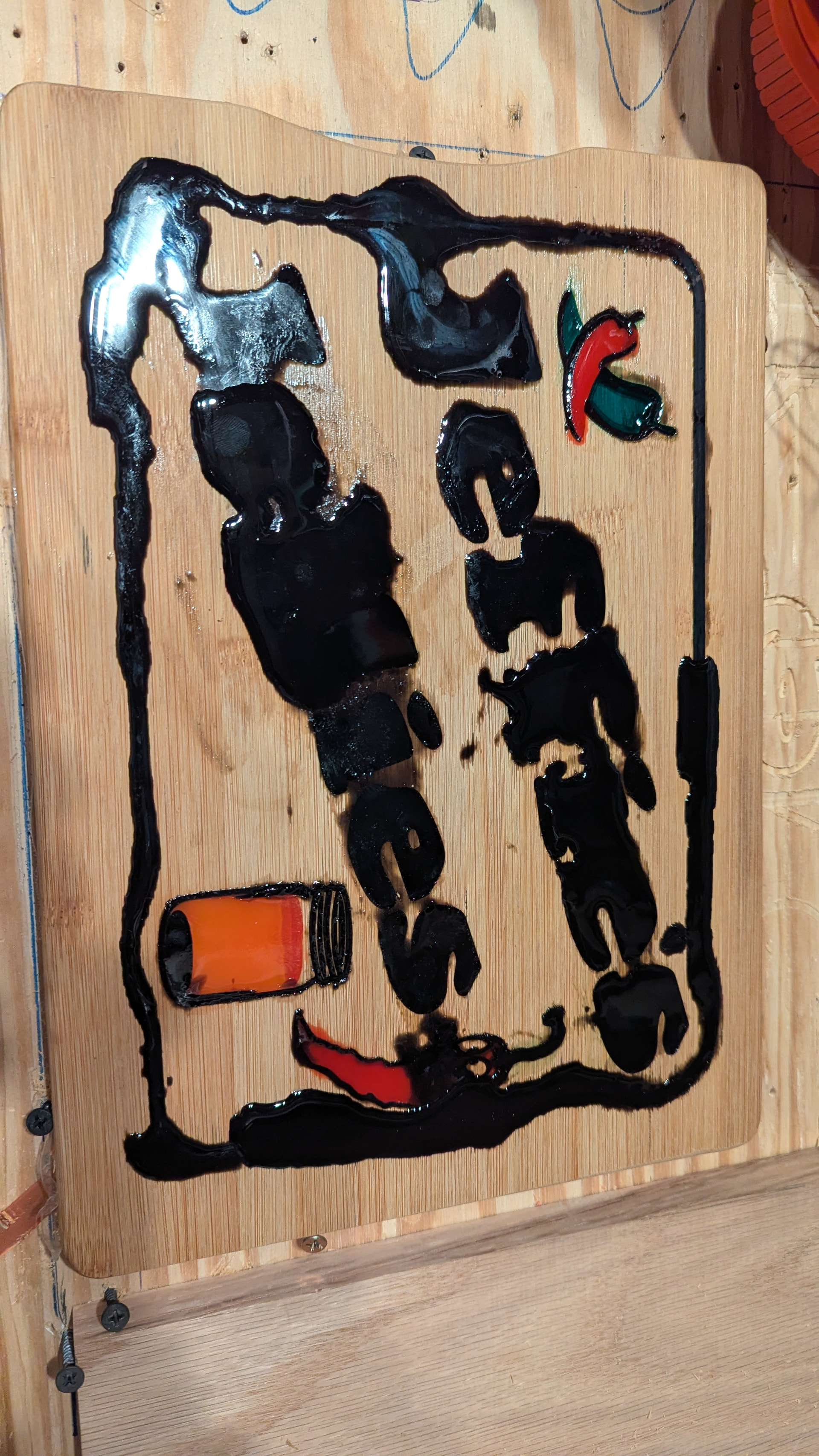

TLDR: even though your cnc and cutting piece are “leveled,” if they arent truly level, the epoxy can flow. And dont forget to heat gun the epoxy to get the bubbles out. the black lettering has dots around the edges.

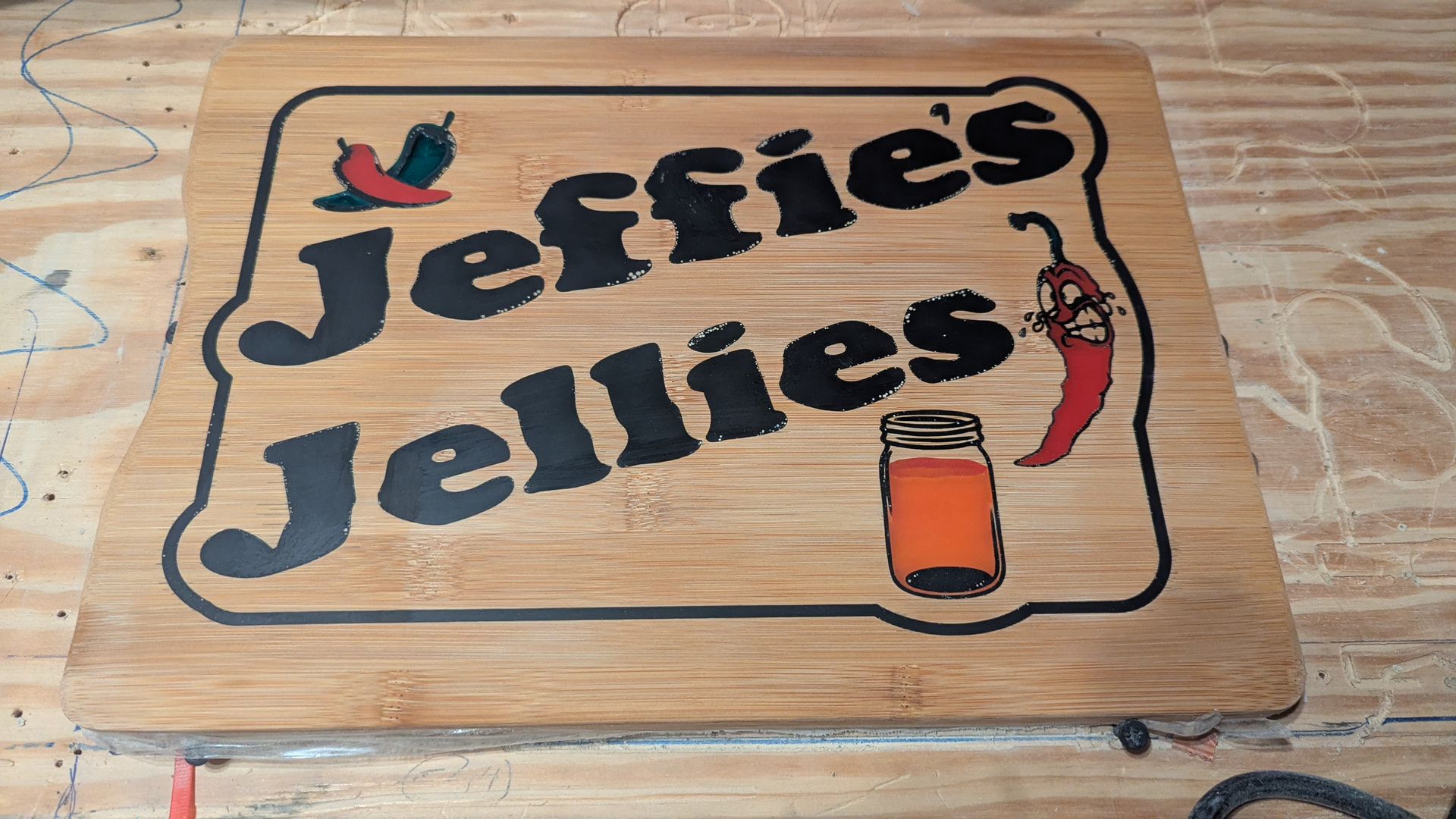

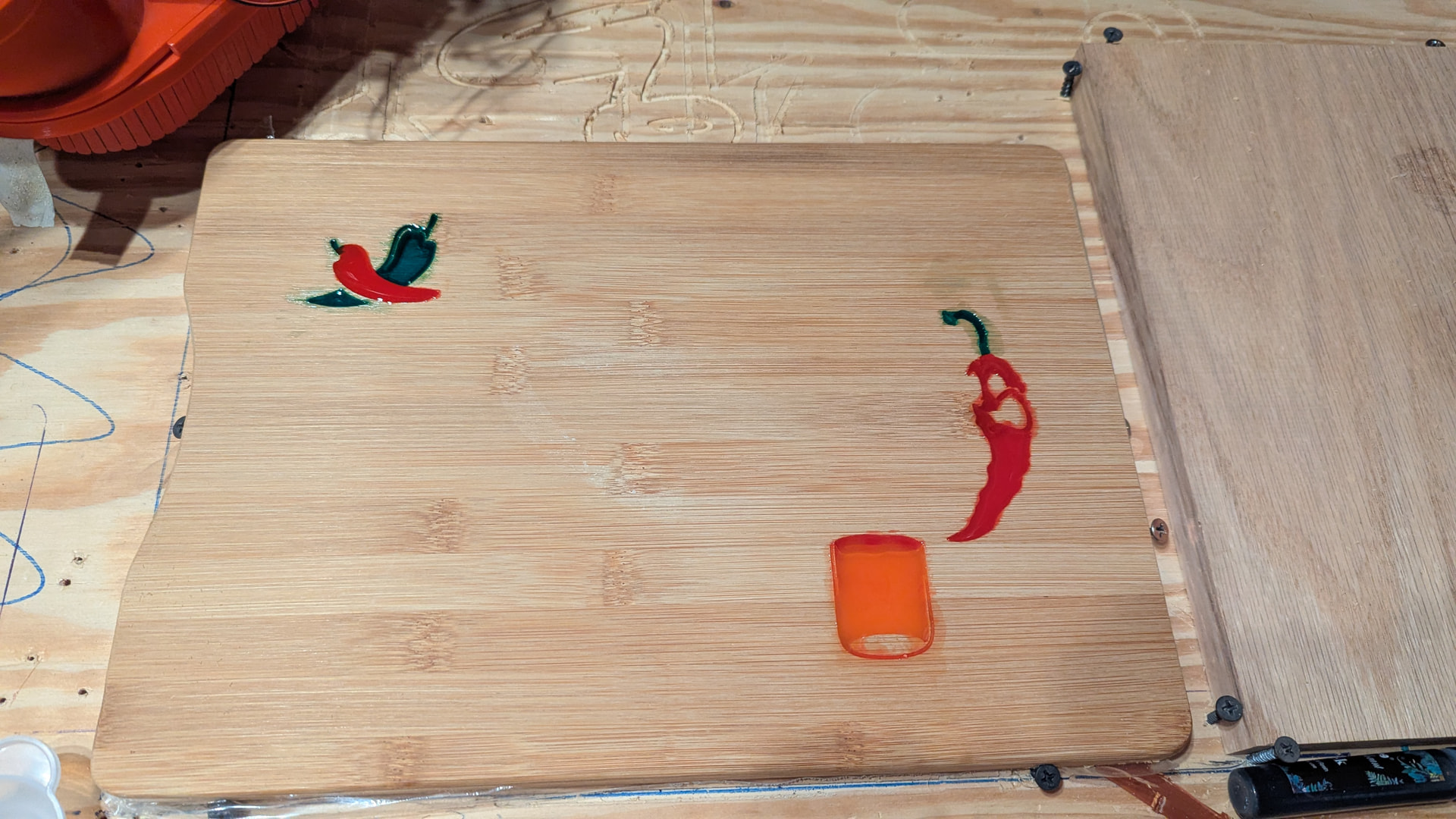

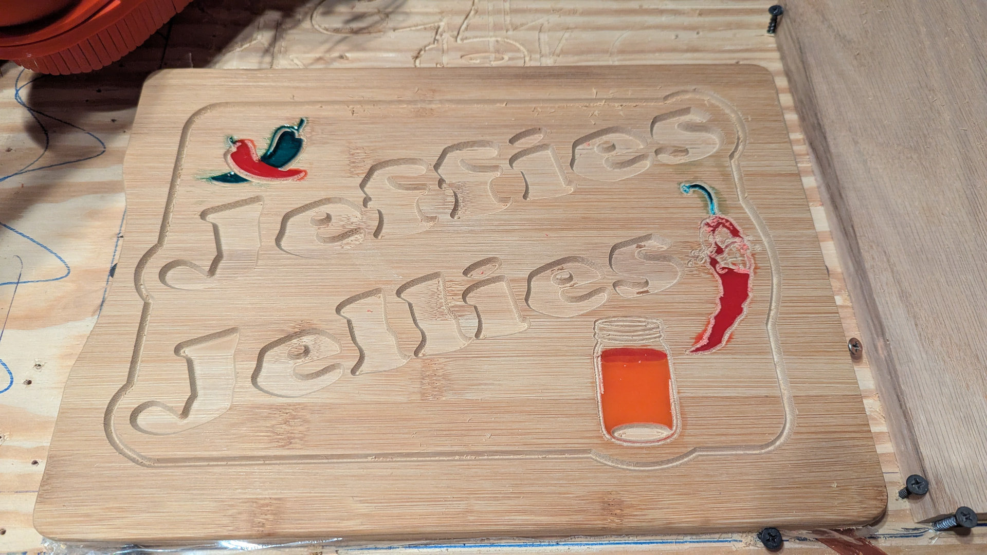

I made another epoxy inlay with a bamboo cutting board recently for a gift for a retirement at work for a guy who makes his own pepper jelly. 1/8” 2 flute upcut mill for the pocket and 60 deg v.

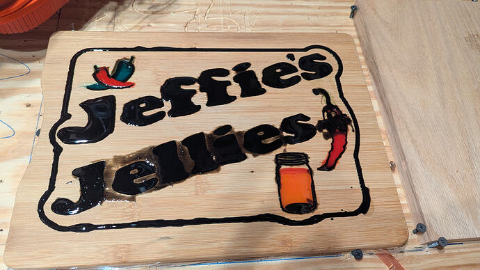

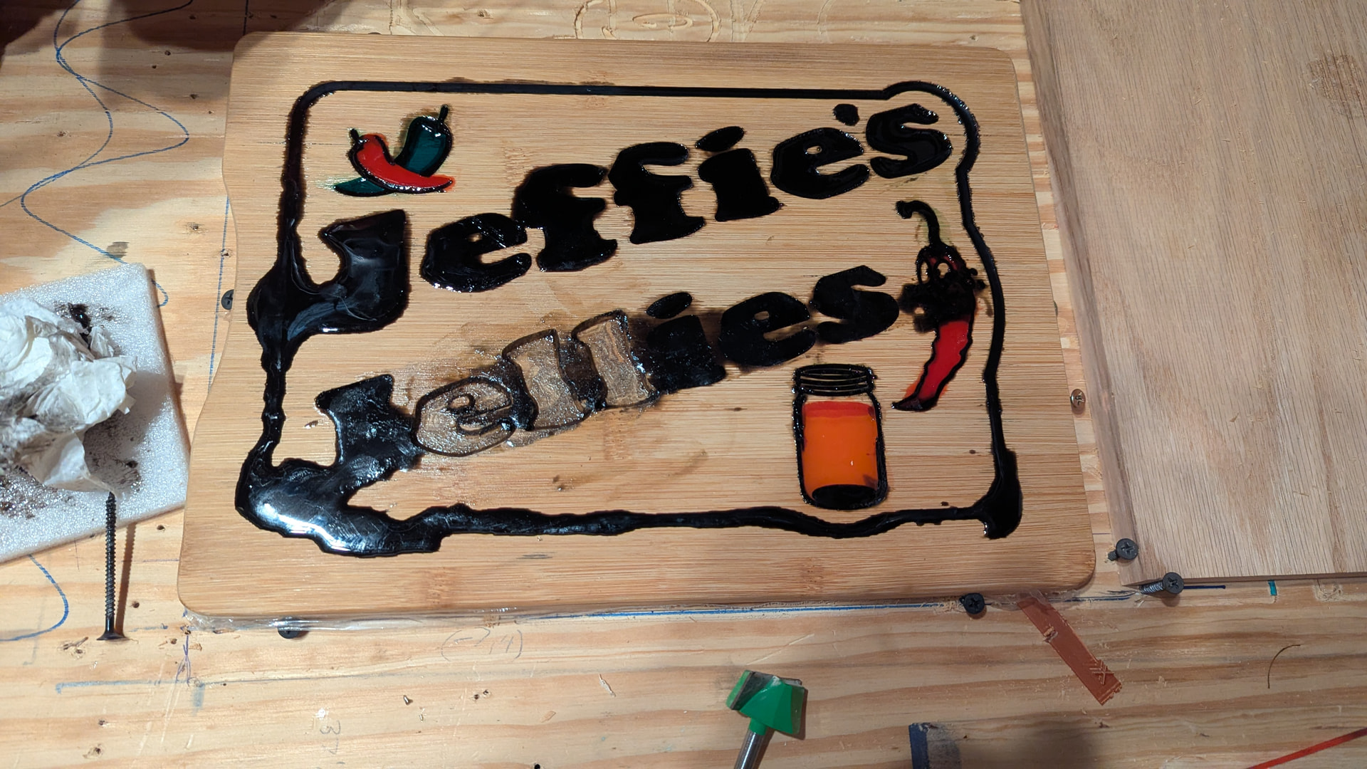

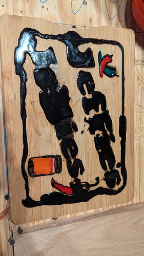

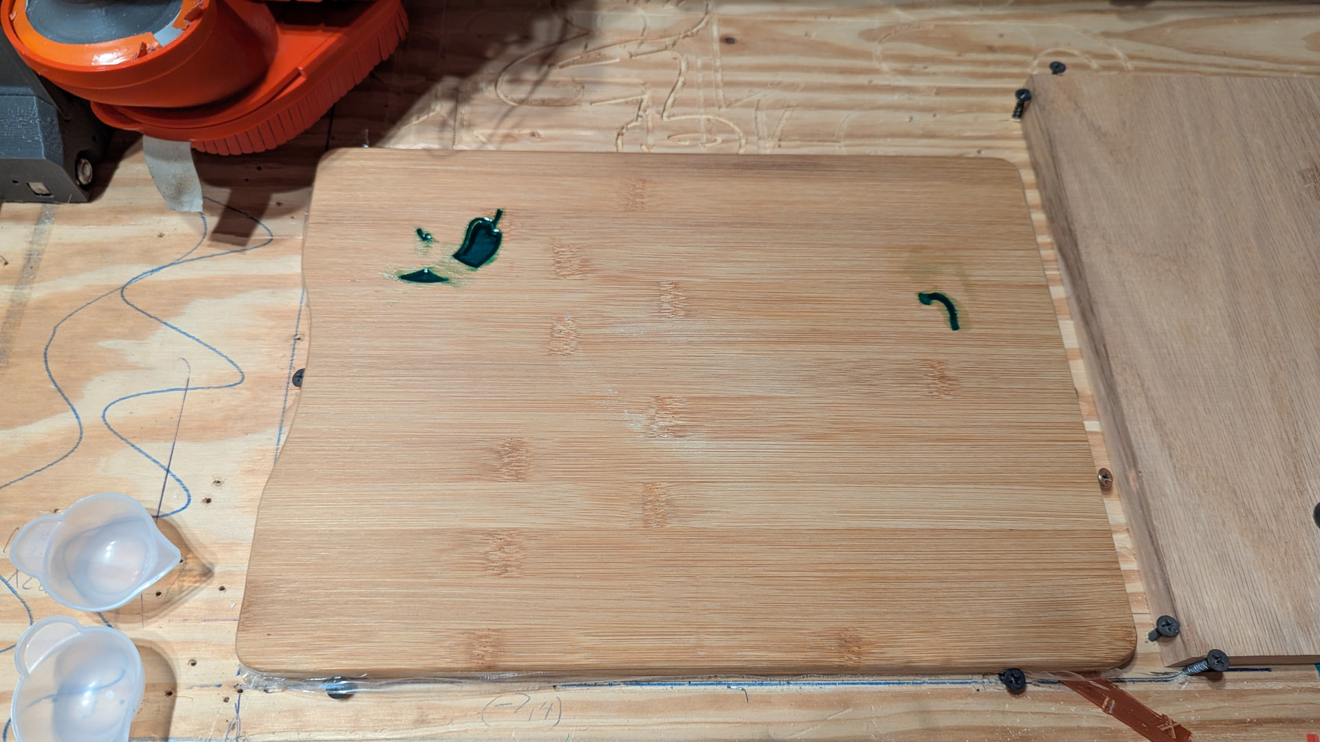

This time the board was “leveled” and only like-colors were cut and filled step by step. First was green, then red/orange, then black. Once the black was poured, either the mixing was incomplete or the resin wasn’t quite right, but a few letters didn’t set up after 3 days, so A few letters had to be scraped out and repoured,
After repouring, it became obvious the board was not exactly level. so additional epoxy was poured.
Surfacing revealed the board wasn’t quite leveled with the cnc, so I shimmed it a little and surfaced, then finished the epoxy surfacing with successive sanding with an orbital.

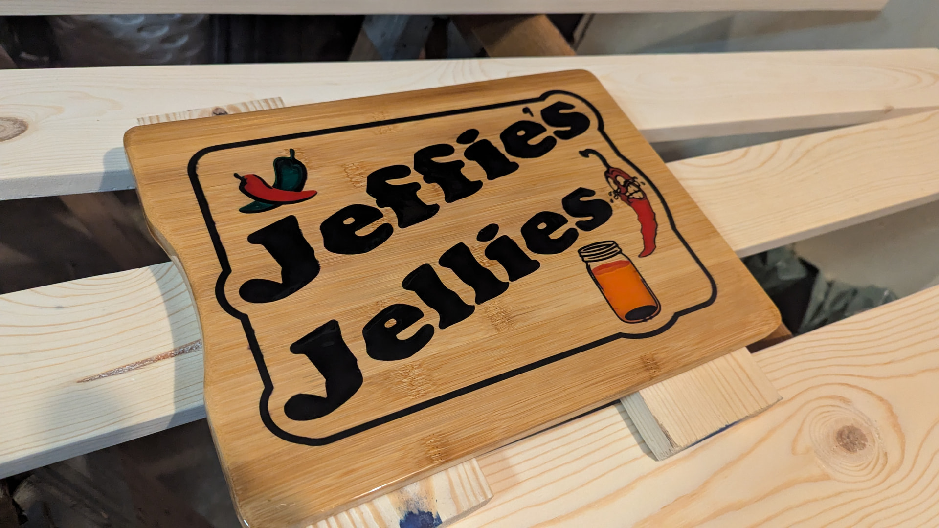

It will do. Photo above is after sanding and wiping with wet cloth. I then black-sharpied the bubble dots in the black epoxy and hit it with clear acrylic spray paint. This is intended as well art, not food prep… how would one finish it if it were for food (other than not use epoxy)?
Final photo
From a distance, it looks pretty good. Up close the bubbles and surface imperfections are easily discerned.

I think it takes the longest to just wait for the epoxy to set and then the alignment/shim leveling to make sure the fine detail wont be lost in the final planing operation. I have 2 more to make now…
