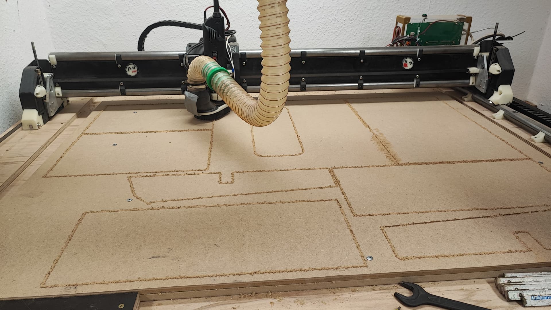

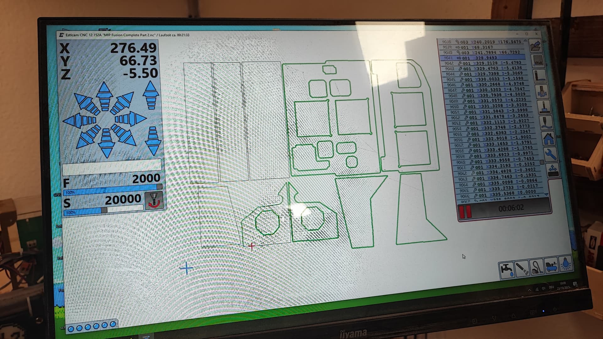

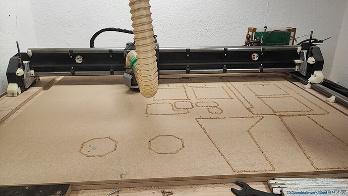

A310 cockpit on its way. :slightly_smiling_face:

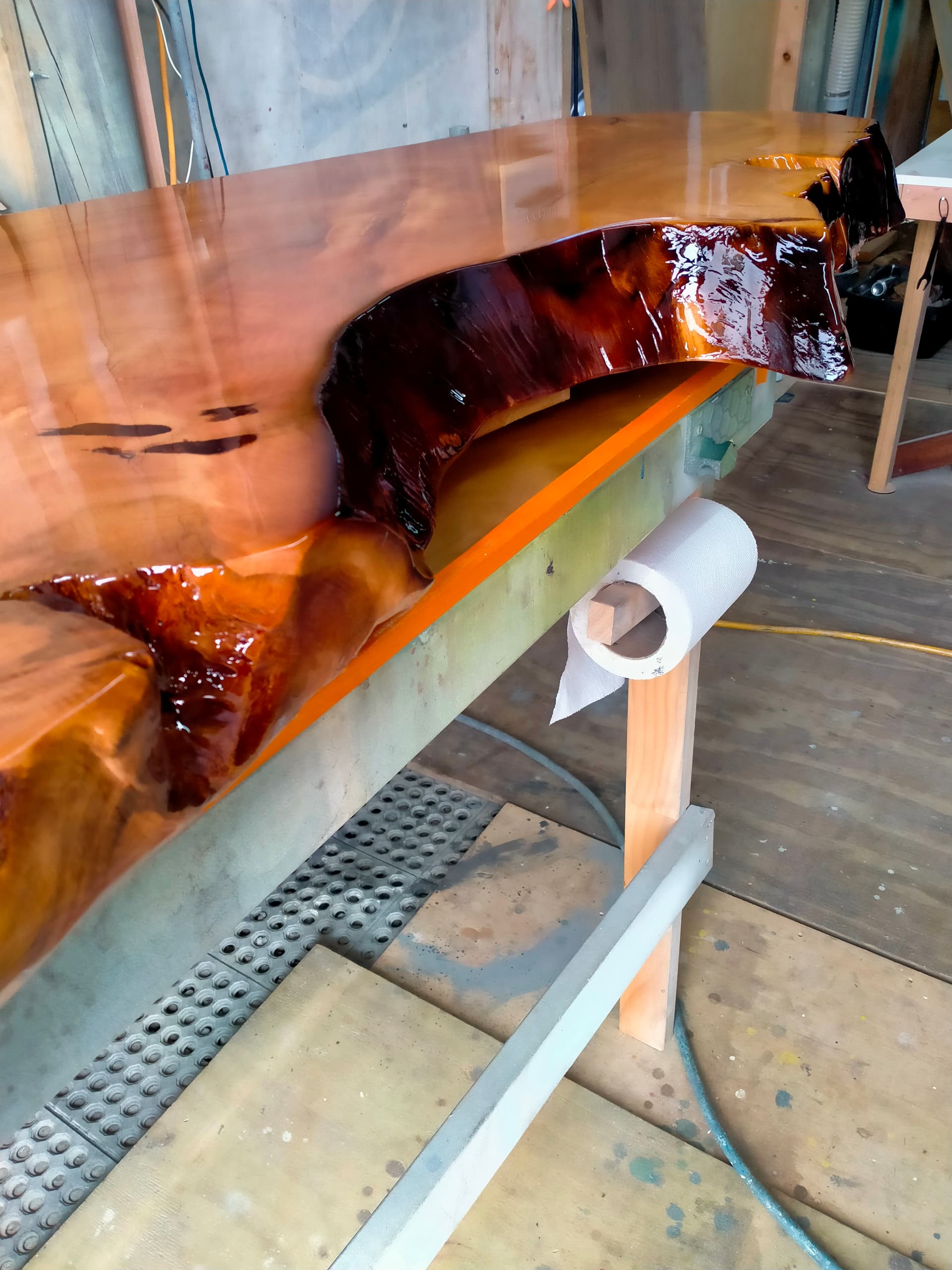

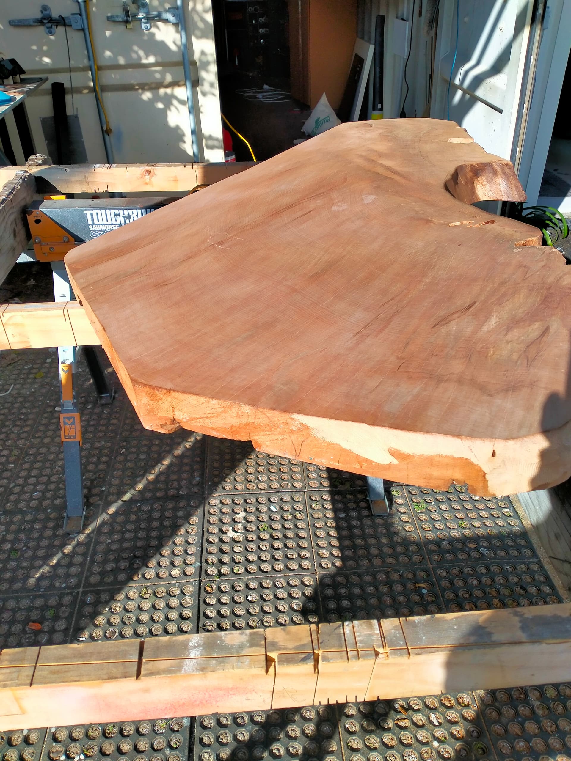

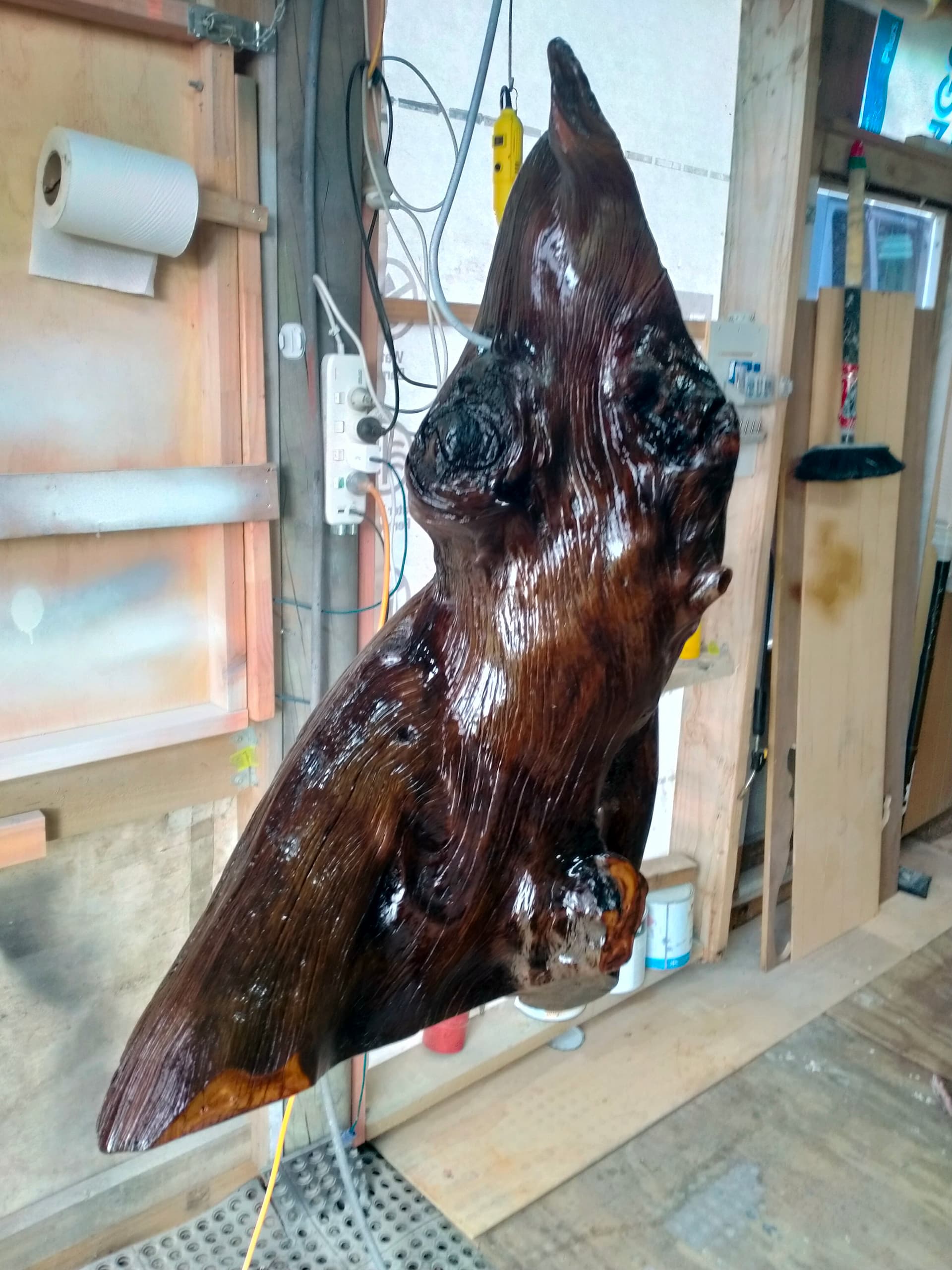

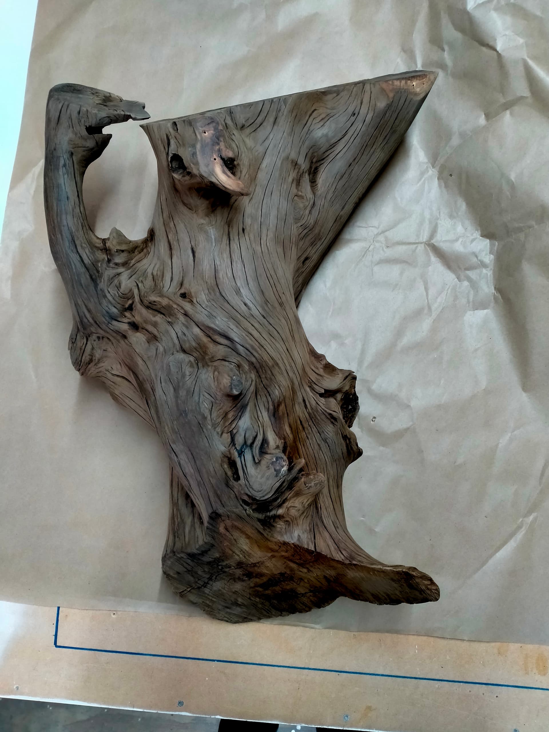

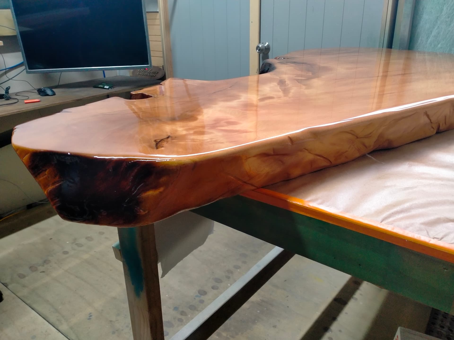

Been making coffee table. customer gave me theses 2 pieces and said make us a coffee table
was challenge to get slab to balance on base ,

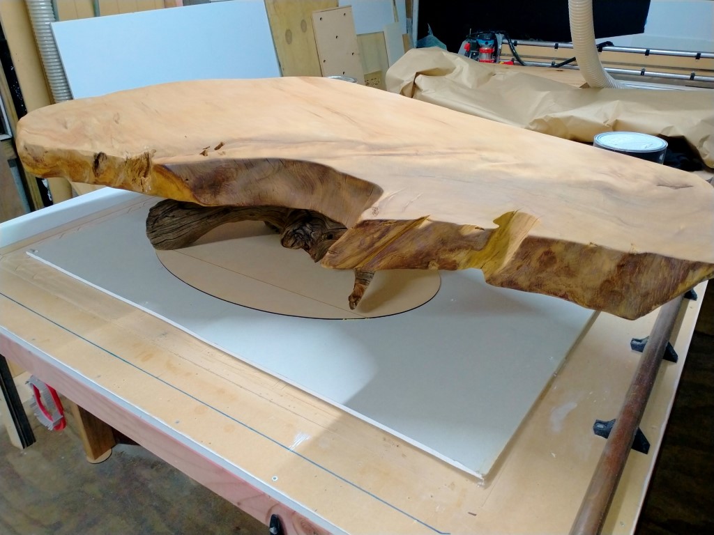

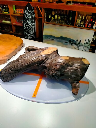

trial of what poly carb would look like
cut a 12mm polycard base with LR4 to stop trunk from rolling due to cantilever of slab
finished the base with a G30 gloss to highlight the detail

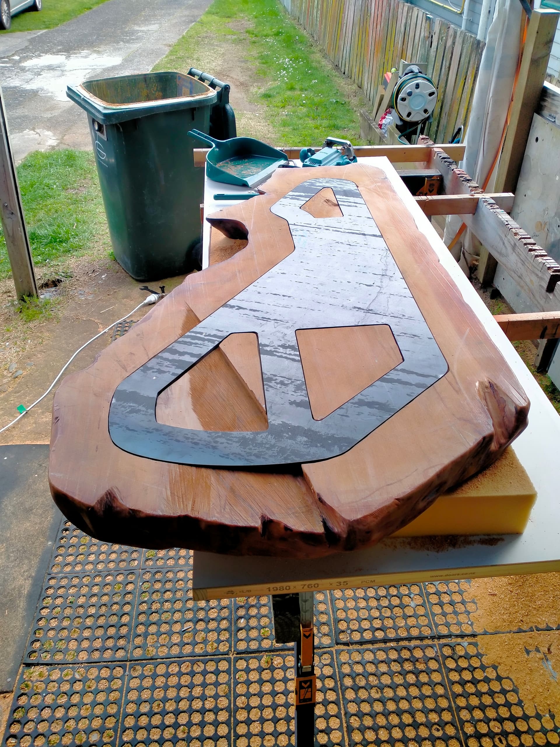

got 8mm plate laser cut to support slab.
hand routed bottom of slab to recess plate which is 19 kg and it was 2k painted black
due to crappy phone, photos below don’t show the true depth and gloss of the finish
photos are before i buffed it
there is 12 coats of 2k high build timber sealer . applied 3 coats at a time than sanded and than finished with 6 coats 2 k clear, ended up having to buff clear due to couple bits of dust , normally don’t polish clear as it highlights grains etc better unpolished
forgot to take photos with it finished and assembled at customer
Wow!
