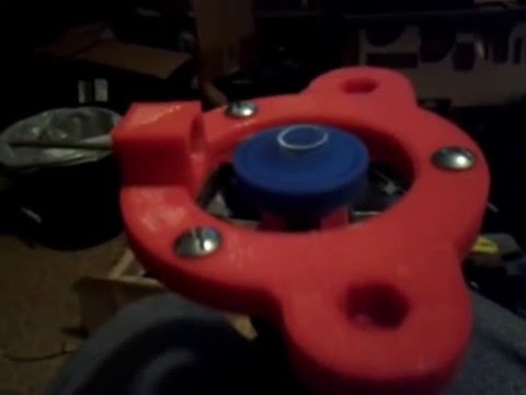

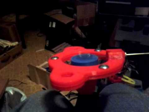

I suppose it could… but all my needle-cutter machines began life as needle-cutters and never had a spindle. They were built large (typically 3’ x 4’ or 4’ x 4’) to handle sheet foam (bluecore fanfold and DTFB) and, while rigid enough for needle-cutter, laser, or pen… they were way too flimsy for spindle work.

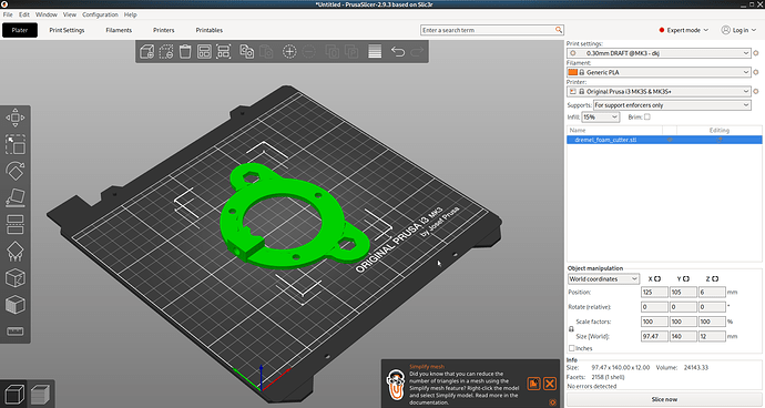

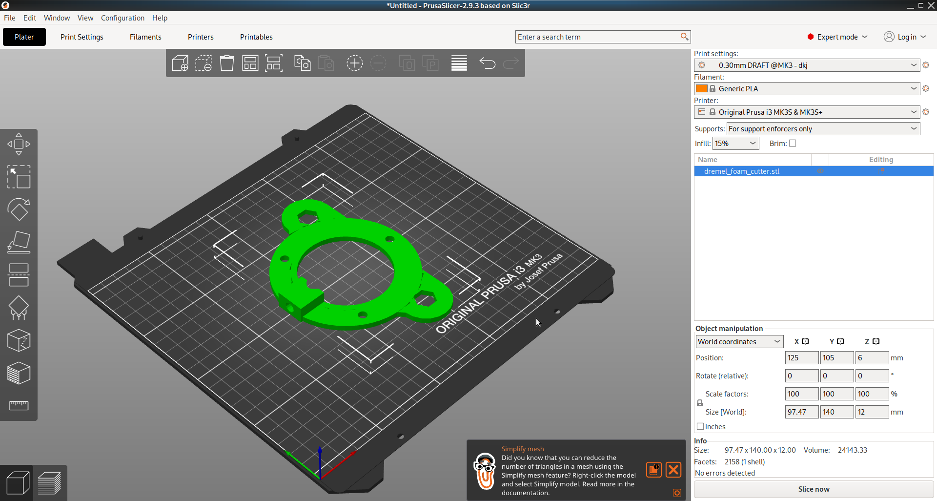

I do remember once entertaining the idea of a Dremel/rotary tool mount for MPCNC that mounted side-ways and chucked up a needle cutter flywheel/eccentric mounted on a 3mm shaft. Even went so far as to print a Dremel router base modified to hold a sports ball-inflation needle guide. I never mounted it on the MPCNC but did hand-hold it for testing. Had photos but cant find them now. I did find an STL that might have been part of it… the needle guide would be threaded into the block on left side.
EDIT: Found this out on my FT needle cutter thread…

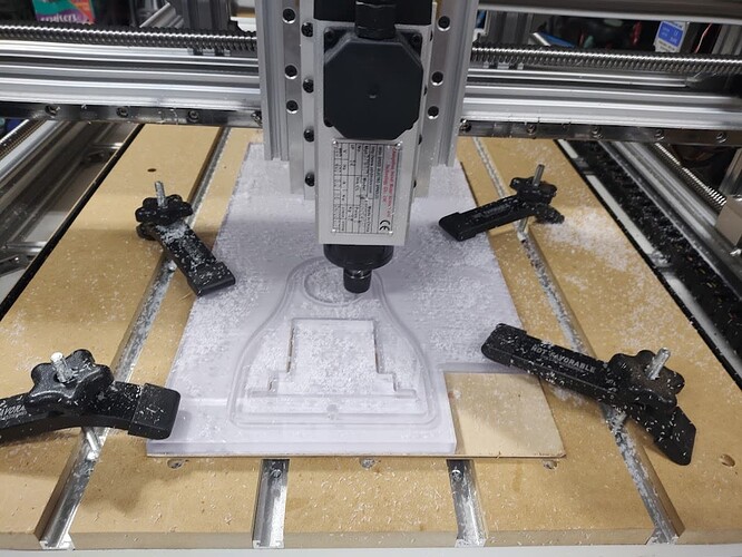

so my spindle has a pretty large circular portion of the body just above the spindle itself. I am envisioning a needle cutter housing that clamps around it. Into the spindle goes a shaft with a bevel gear on it, which drives a right angle gearset that is attached to the needle cutter bearing/body or whatever.

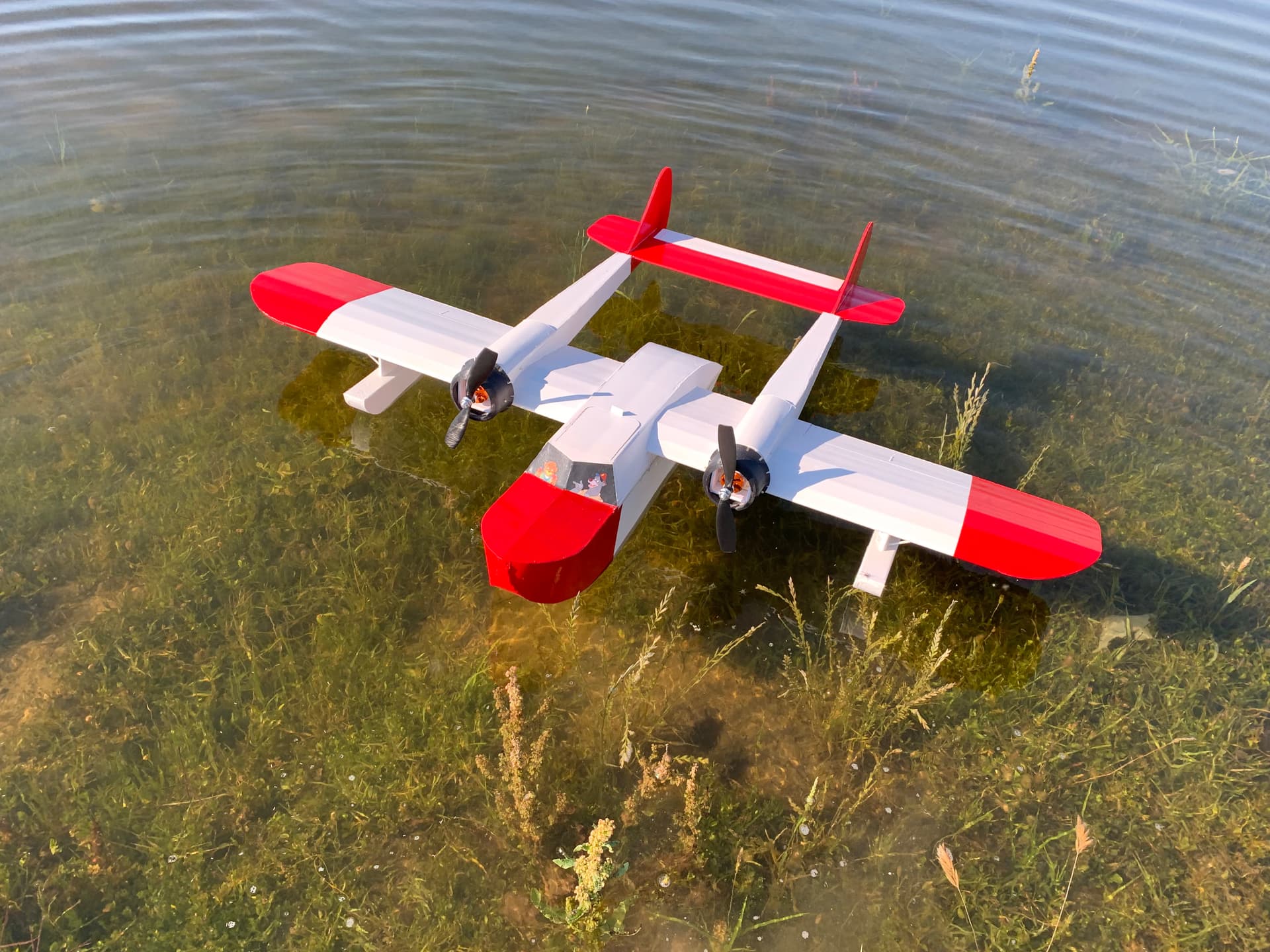

I have always wanted to build the FT Seaduck…..a needle cutter would make that a much nicer experience!

How low can you take the RPMs on your spindle? And what speeds do the needle cutters use? 10k rpm is probably going to melt stuff instead of cut it.
Typically, I run my needle cutters at ~8000 rpm, no load… and it would drop a couple of hundred RPMs while cutting. I also used a “rule of 10” to set the ratio of cutter rpm to feed rate… at 8000 rpm and 600-800 mm/minute feed rate. This results in 10-13 perforations/revolutions per millimeter of travel… and nice clean cuts in DT foam board, with paper on.
In my experience, running at 10k rpm and above, there would be a bit of foam melt (little black bits in the cut) as the needle started transferring enough heat from the MIG tip needle guide (which could get quite hot). Staying below 8000 rpm was far less stressful on the cutter and much quieter in operation; i.e. less “angry” sounding.
The SeaDuck is one of my favorite planes to fly.
It will go very low, but I recall the documentation warned not to run below 5k or 8k for extended periods, dont remember which. will check when I go home. In any event, the product page lists 10k-24k so im sure it can run all day at 10k. Id wager that a needle cutter doesnt put much load on the spindle at all so 8k is probably fine.
Plus, since I need to use gears to transmit power anyway I could always gear it down mechanically and keep the spindle rpms up.
