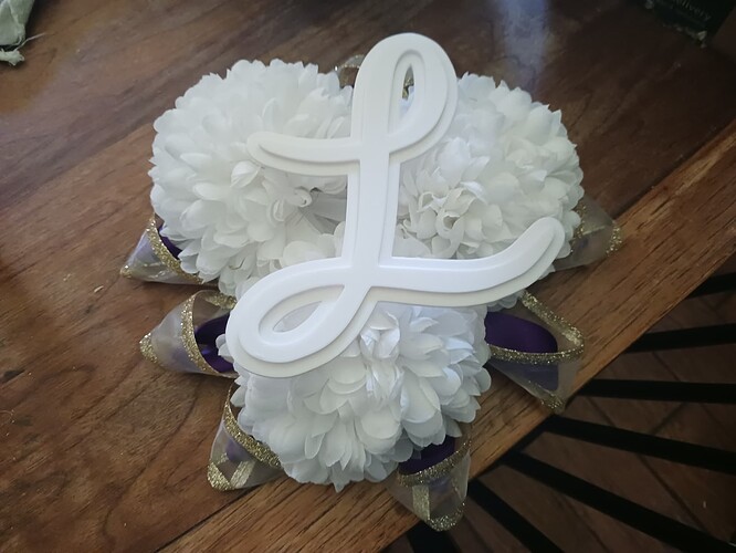

I guess I should have mentioned this a week or so ago. Grand-daughter has commandeered the “Laverne L” (from the Laverne & Shirley TV show) as her own… it’s now the “Layla L”. Anyway, for the last two or three years, when football season and homecoming rolls around in North Texas, she has “needed” an ever-larger corsage… which she crafts all by herself. She does buy/scrounge the materials of course… but I’m her “go to” for the “L”. Sized to her liking and then printed, along with a pedestal, to “float” above the “flowers”.
This was taken at the Friday night game with her friend… whose corsage was also crafted by my grand-daughter. Hmmm… hers is not as big? Face-painting by her Dad. And long gone are the days when the corsages were smaller and could be pinned on the shoulder of the dress… er, t-shirt.

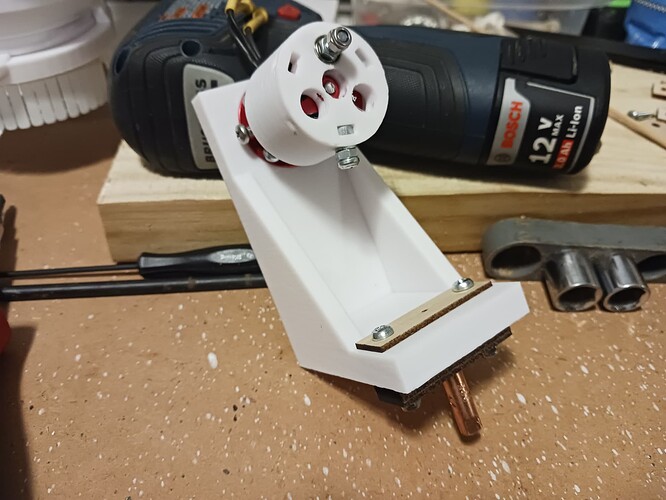

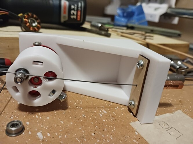

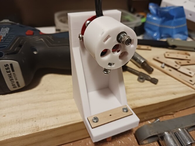

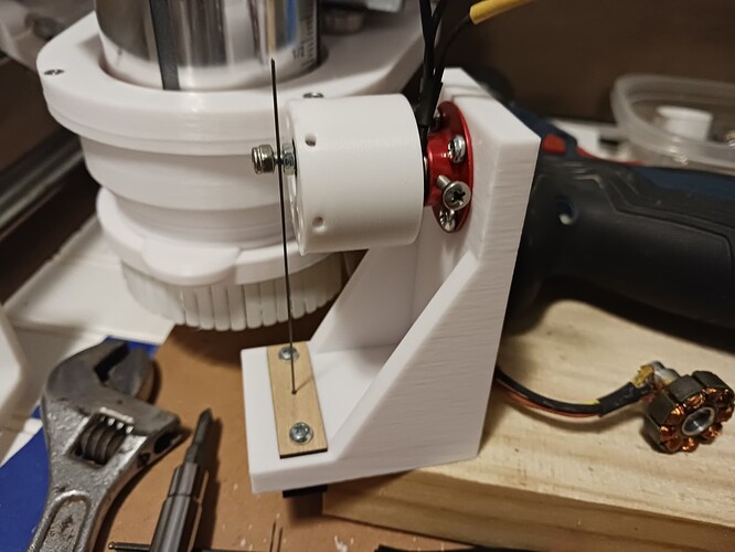

And “officially” I guess I’m currently working on yet another needle cutter… for MPR&P.

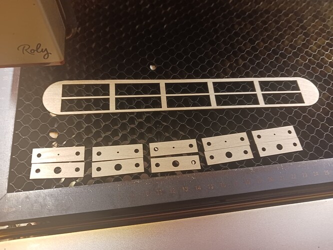

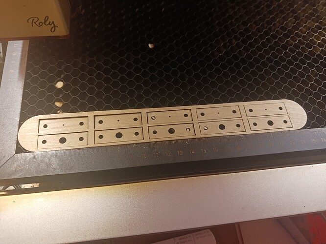

Laser-cutting the wooden “preguide” (small center hole) and main guide “stack” from a jumbo craft stick…

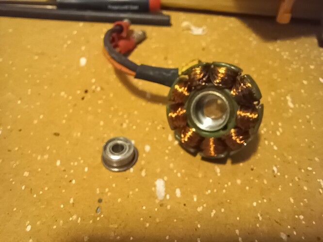

and then “borrowing” a 8mm OD x 3mm ID bearing from a junked motor… forgot photo and show flanged bearing that would also work.
and un-photoed bearing press-fitted into a newly-printed “slip-on flywheel” and roughly static-balanced…

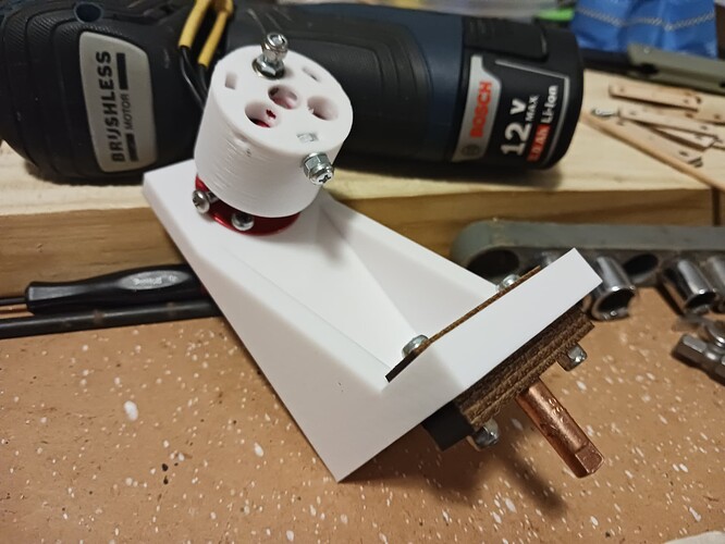

Needle-cutter assembly begins with flywheel slipped on…
and wooden guide stack and pre-guide installed…
A short length of 0.025" K&S music-/piano-wire to aid with rough alignment…
and all that’s left is to create a needle with a ~3mm loop to attach to “flywheel”. And, silly me, figure out how to mount it on MPR&P!

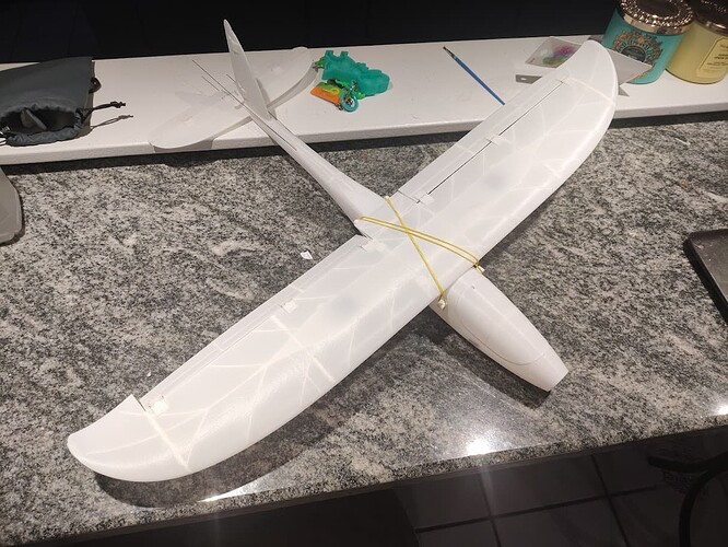

This is an Eclipson design that I think I scaled down a bit to keep it compact. This was before I re-printed the tail section from LW-PLA (active foaming) as I couldn’t get the standard PLA to balance about the center of lift without a MASSIVE battery. The airframe is done but I never installed the electronics. I even bought a flight stabilizer for it but never got around to it. I’m sure its not very robust, but the idea of just 3d printing a plane or replacement parts whenever you need them sure is cool!
