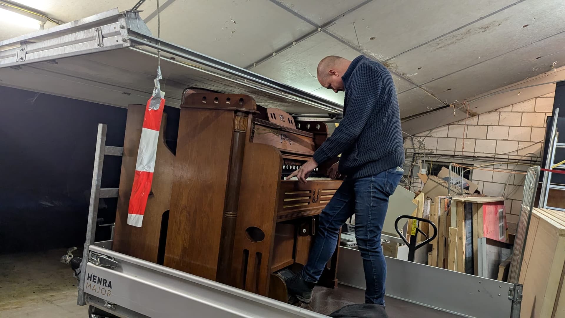

Got myself 2 harmoniums today. The idea is to convert them to midi with solenoids. Why? Because I want to. I expect it to be a 10-year project
During the trip we also picked up a used old go-kart for my youngest son :wink:

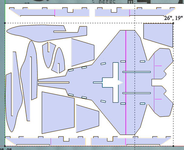

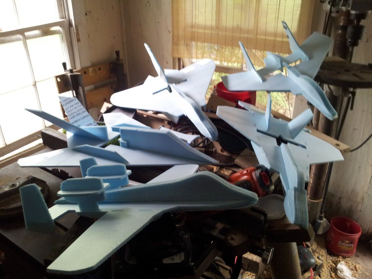

Oh, heavens no! The planes shown are just adaptations of various planes we found on the various forums/websites back in the 2010-2012 timeframe. We made them CNC-ready for our machines using SketchUp, added tabs and slots to strengthen them and simplify construction, and most often adjusted their size to let us “standardize” on small 3000kv BW motors and 2-cell LIPO batteries which we could stock up on. This made for very inexpensive planes that we could fly and crash… and then needle-cut a replacement overnight that we could assemble and fly again the next day. Most often the electrics would survive our crashes and it was usually simply a matter of cutting a new airframe and transferring the electrics over to go at it again.

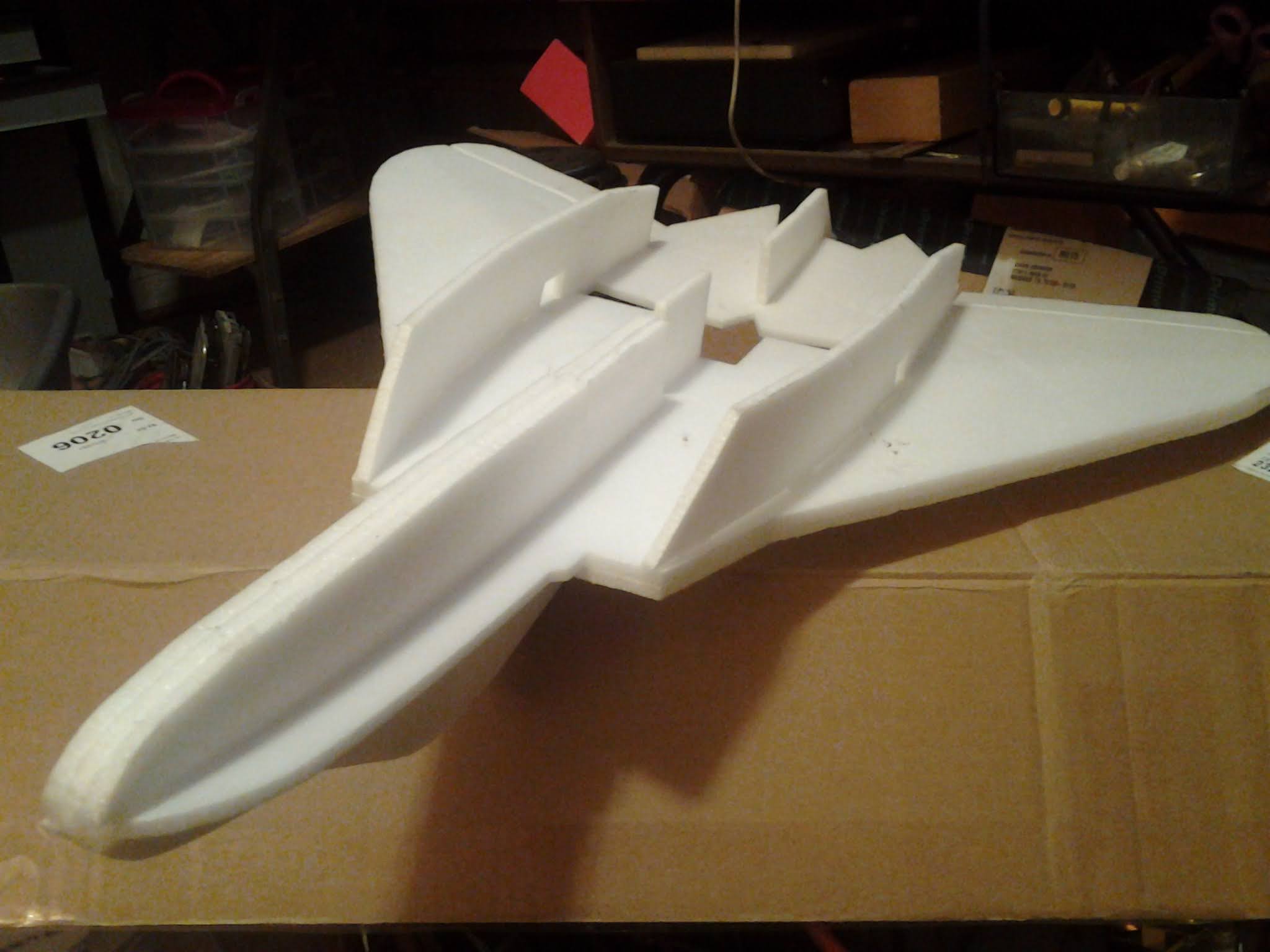

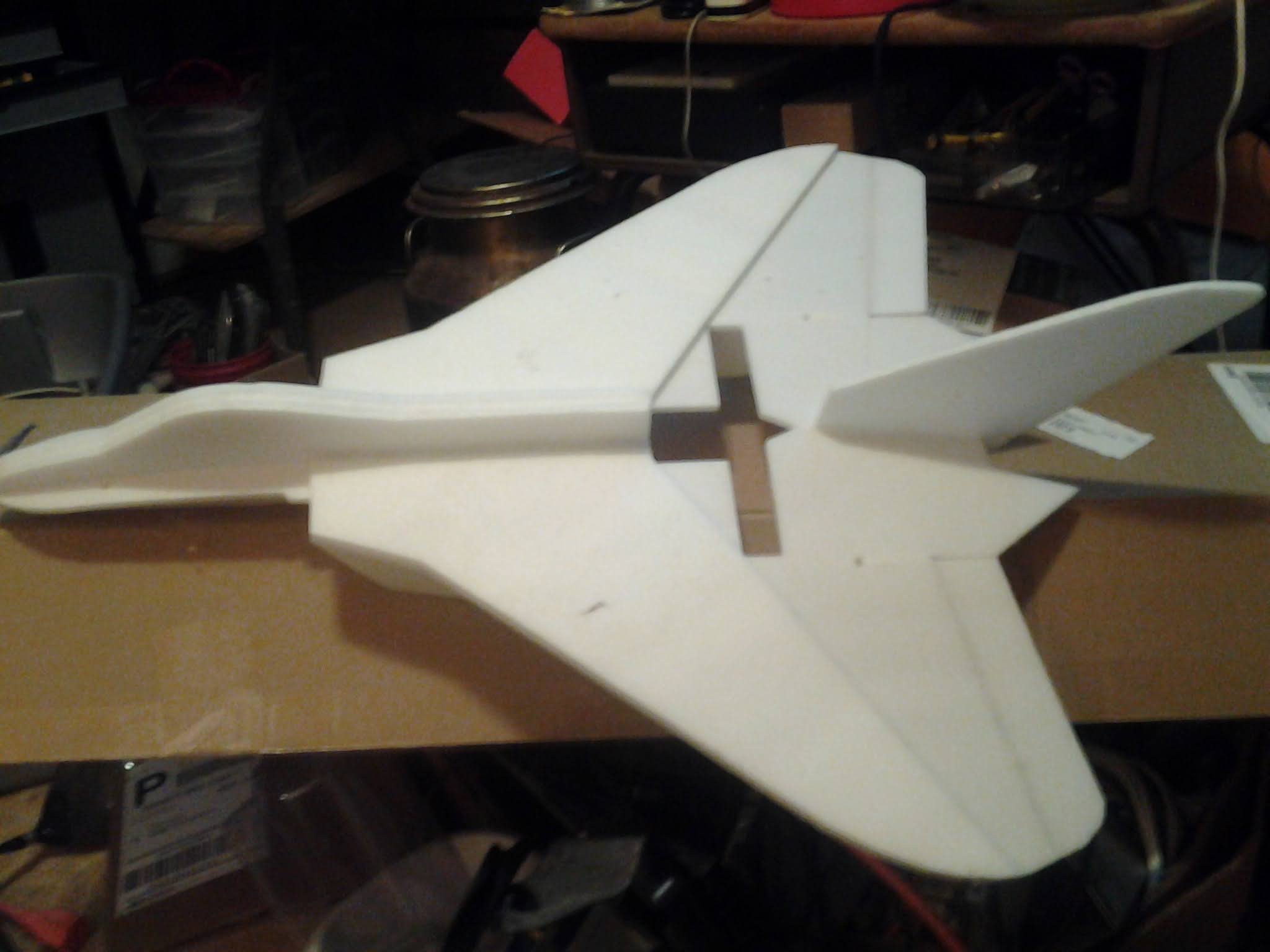

One of our favorites – and sweetest-flying – was an adaptation of the F4D Skyray that had an ~16" wingspan and used a little 3000k BW motor and a 2-cell LIPO battery…

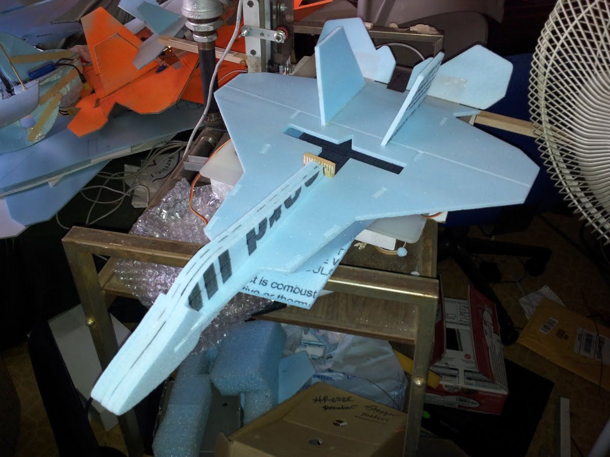

Another favorite was a F-22 Raptor foamy with 16" wingspan and same electrics…
Both these designs were easy to build and flew very nicely with our “standard” motor and electrics setup. As my buddy and I were new to RC late in life, we both found it great fun to learn… and these foamy designs were inexpensive enough to remove all the apprehension and fear of crashing. We’d fly “demolition-derby” style and field repair our planes with tape, craft sticks, skewers, hot glue, zip-ties, etc… crashing, repairing, and re-launching again – until there simply wasn’t enough “airplane” left to fly anymore. Overnight, we could then needle-cut and assemble a new one and go at it again the next day. It was indeed great fun!

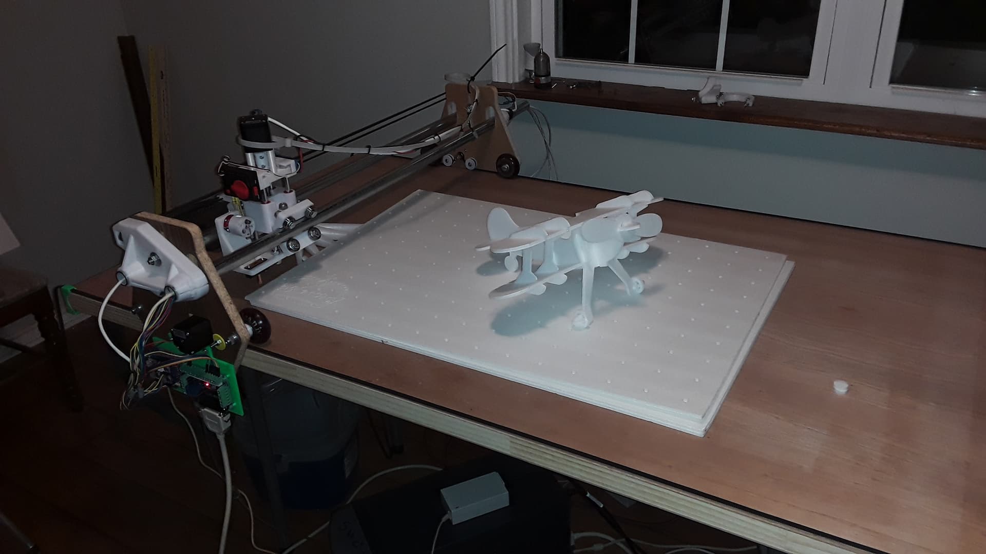

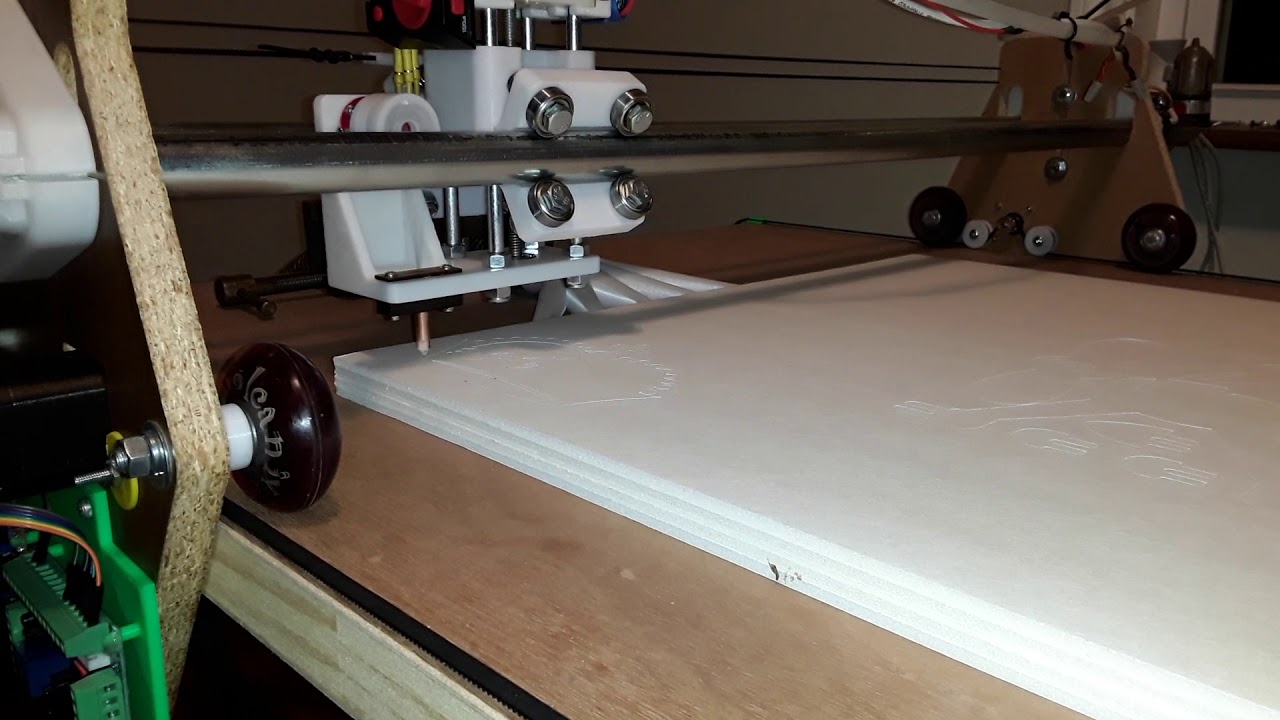

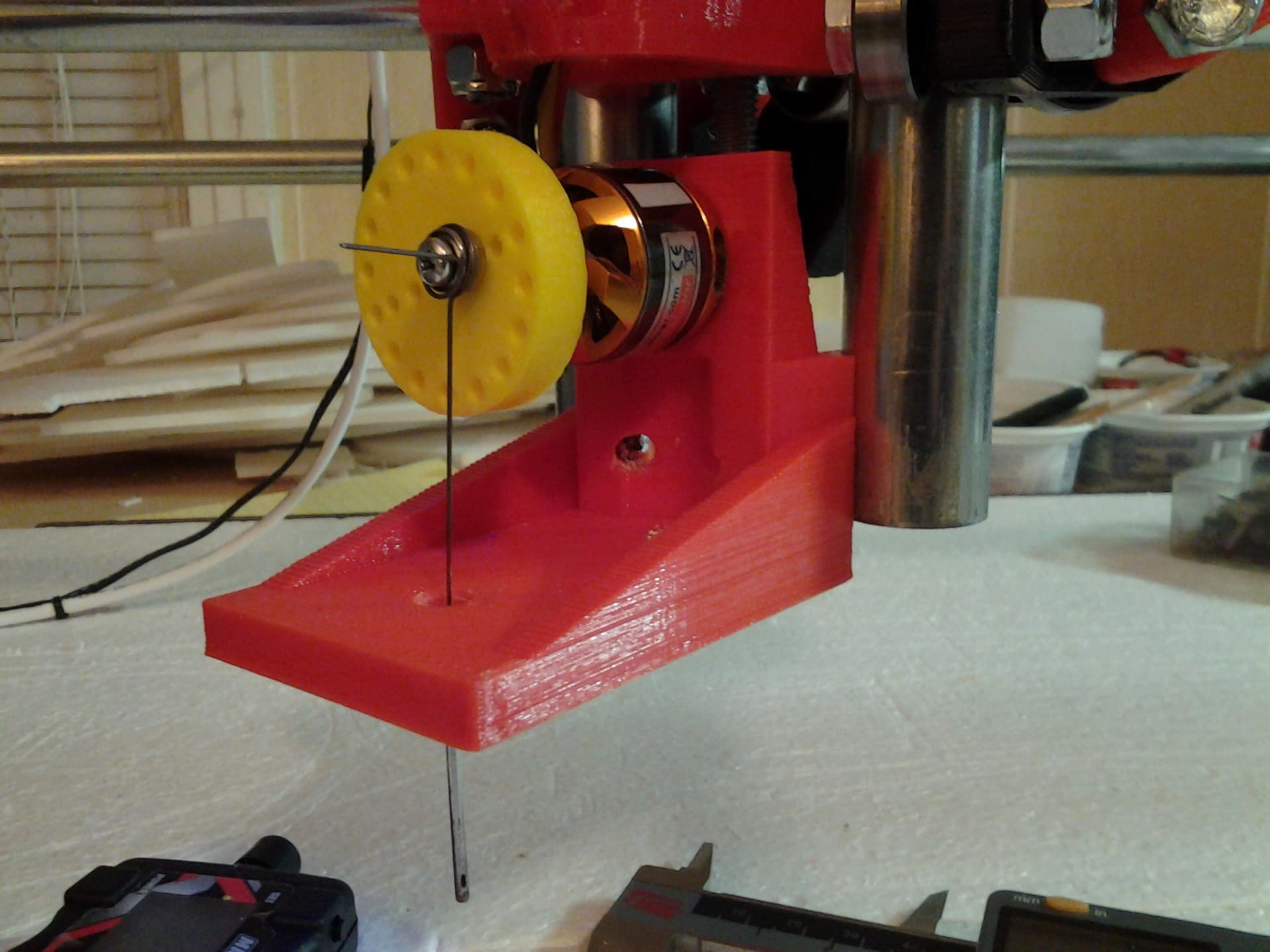

IF I was working on [a needle cutter] currently…
I would begin with my last and smoothest running “slip-on flywheel” design shown here cutting a small biplane…
and the V1 test crown…
This needle cutter is detailed here in my long-running thread over on the FliteTest forum. I built and tested numerous needle cutter designs over the years… but ultimately kept coming back to the same basic design layout (with no extra bearing guides) that I started with.

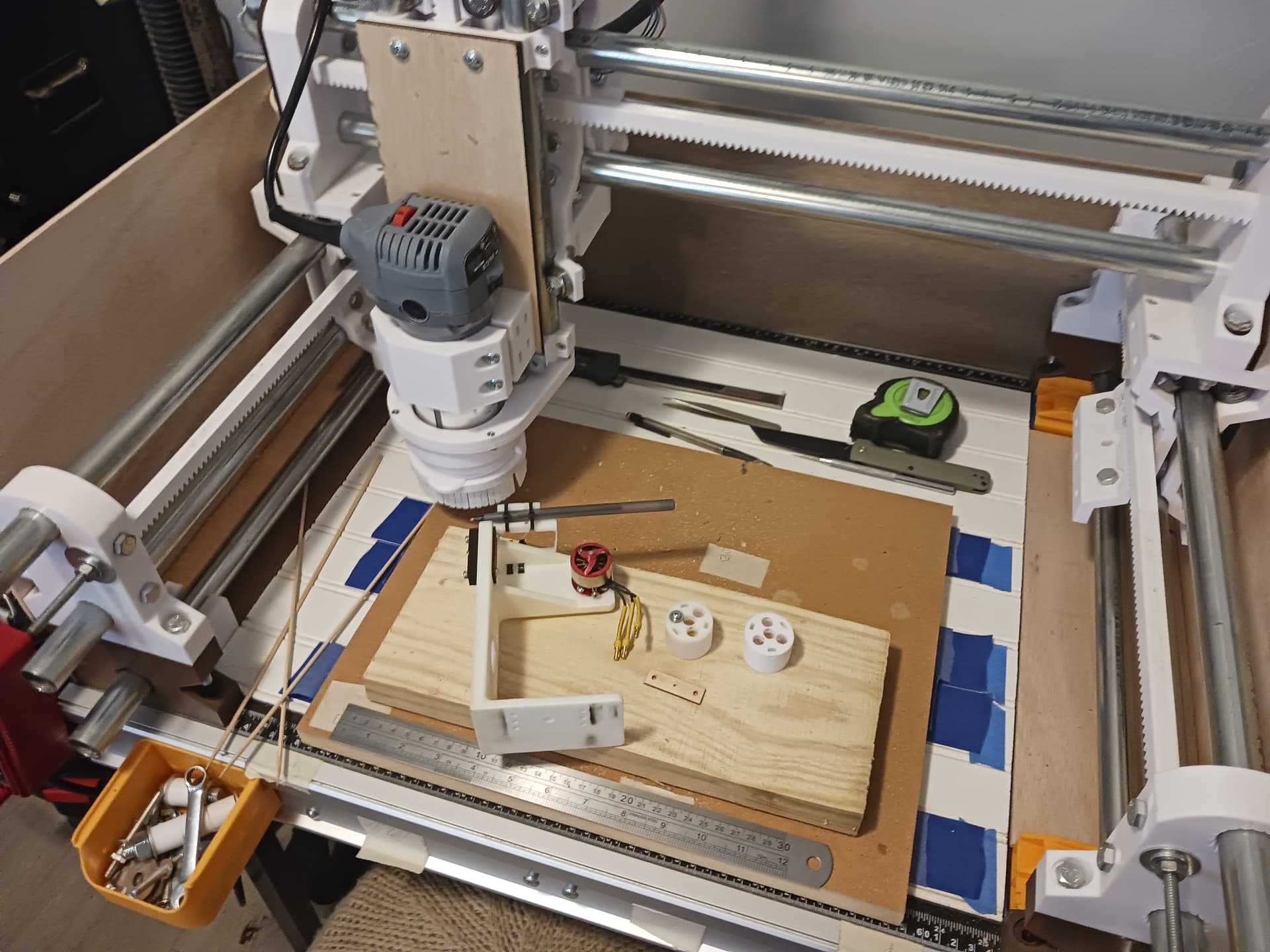

I’ve nearly built a needle cutter several times, because I would like to make these foamie planes (I’ve not yet.). It may yet show up as a topic in the random category. I need to finish a few other projects first. A portable MPR&P with a needle cutter making giveaway foam fliers would be sweet for a maker event demonstration.
Interesting that you would mention that. I’ve been rummaging through my junkboxes for the last hour or so, gathering up the old needle cutter parts to see what I need… to possibly bolt it onto the MPR&P…
Does that qualify as what I’m currently working on?

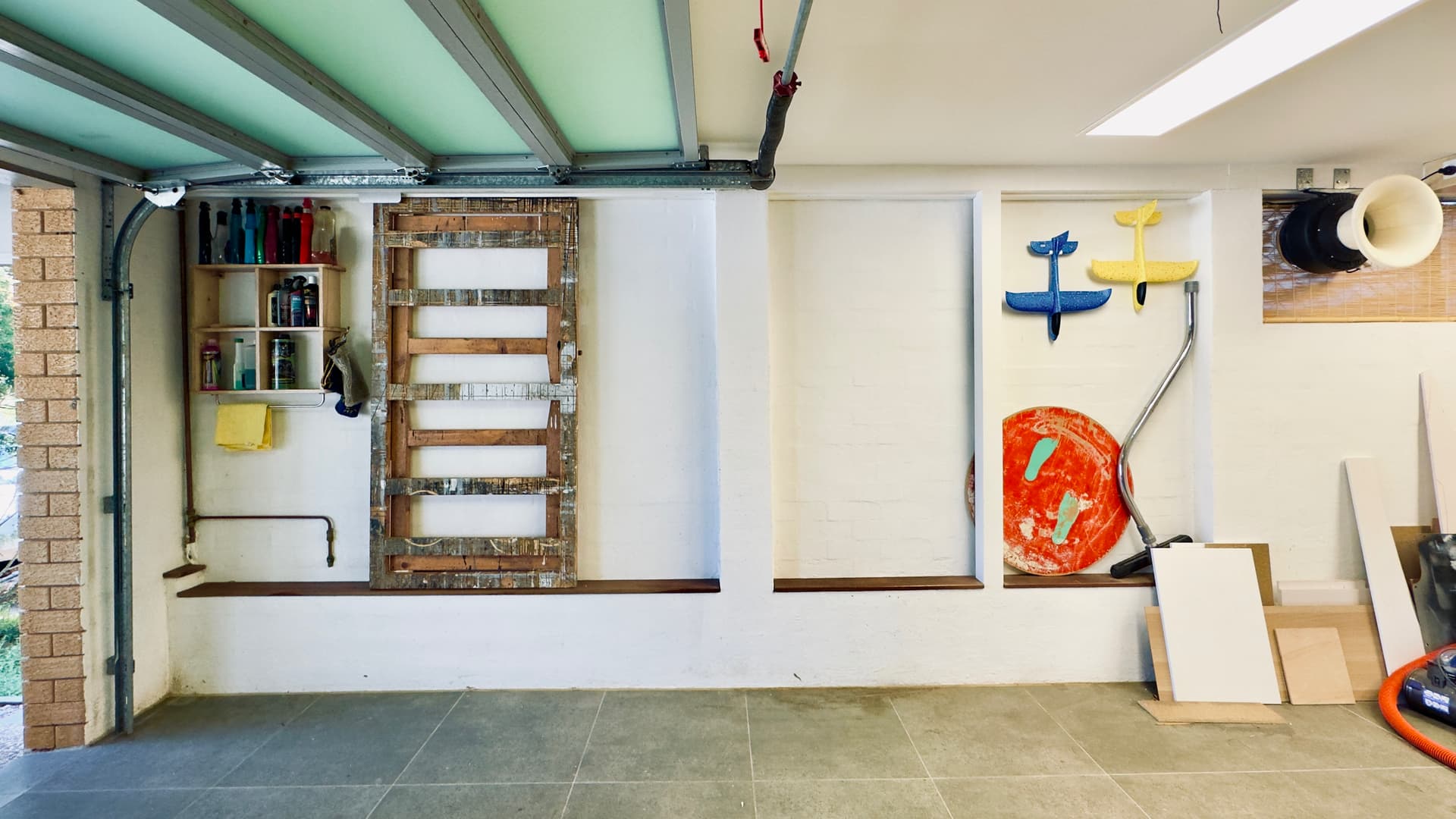

I know if I’d started the big tidy of 2025 at the other end of the garage, I’d have been able to make this with the LR, but I also know that I’d bury myself in some other distraction.

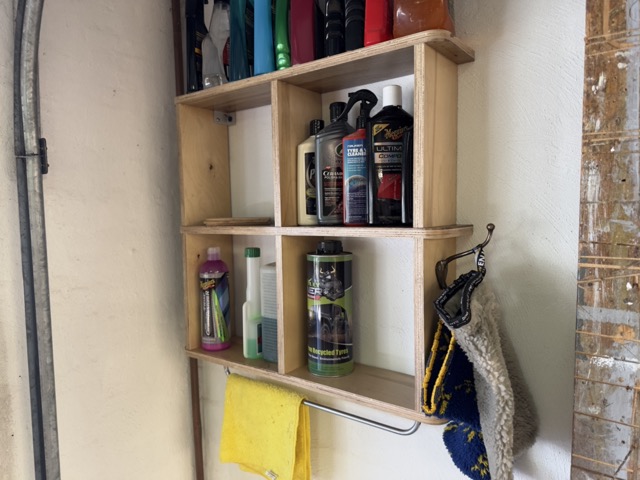

:white_check_mark:Shelf for the car cleaning gear and other odds and sods.
That’s the last of the left over flooring ply. Time to plan <ten years, time to make and dispose of the rubbish stacked against the wall - a few hours over a couple of days, and suddenly almost 20% of my wall space is clear!

I like it! The last part with the white background, makes the clear poly plate hard to see though.
