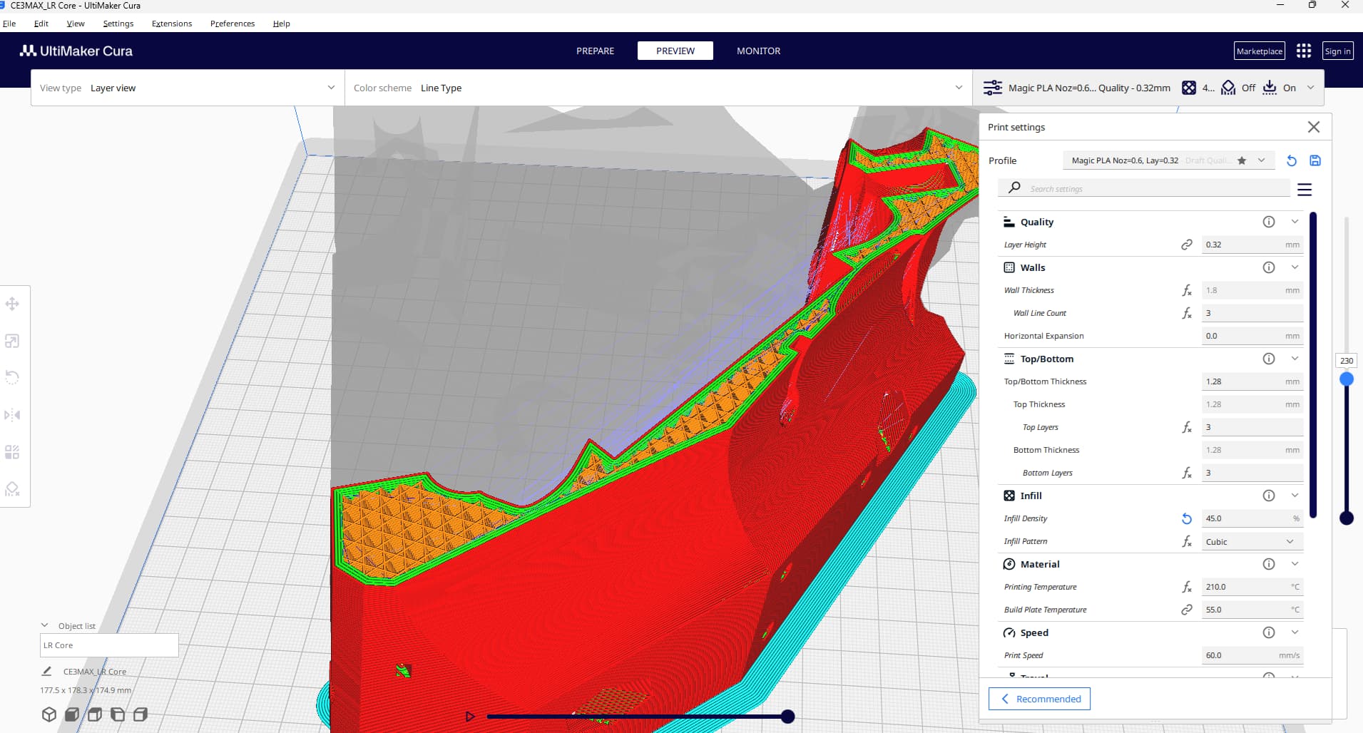

If you’d like extra eyes/thoughts on slicer settings, then consider sharing filament type, Nozzle size, temperature, layer width, layer height, number of walls, using alternative layer infill wall, etc…

Many of us have Ender 3. What slicer do you use? Personally would use 0.6mm nozzle. I’ve not seen many people use 0.8mm. I don’t know why anyone uses 0.4mm for these parts.
For LR3, used Overture PLA, Cura slicer, 0.6mm nozzle, 0.32mm layer height, 3 walls, spec + 10% extra infill. Brim support.
Hope that helps.
Ender 3 doesn’t have near the hot end needed for a .8mm But you should do fine with a .6 like @azab2c said. Might just have to slow it down some.
I used cura before as well. Now I try to use orca, as Ryan said cura not gut :wink:
But, ok - I will use 0.6 and cura this time as well. Thank you for settings, Aza.
and thanks, Jon.

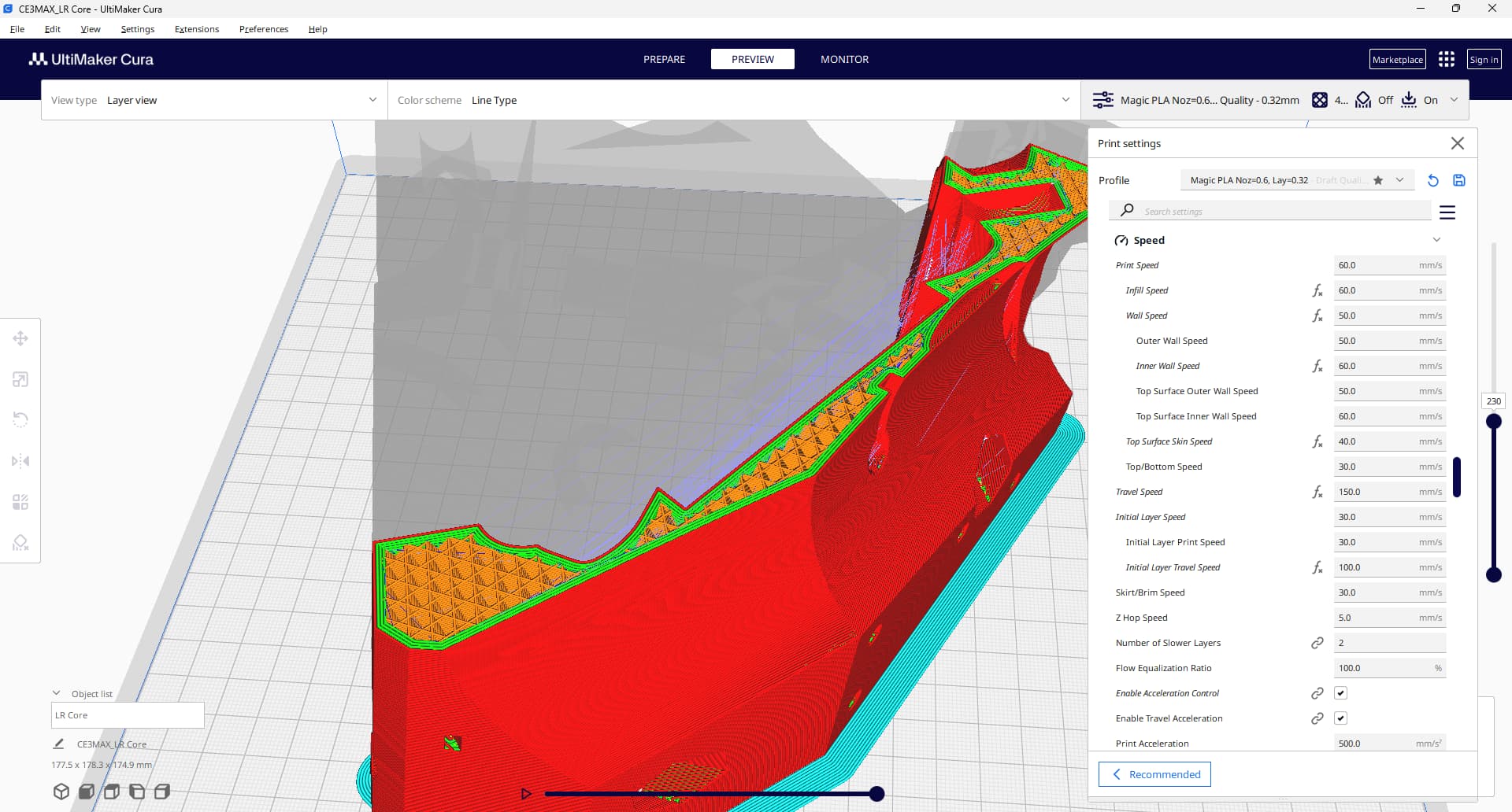

What speed then?
what hot end do you have on it? stock?
If so, you need to cap your flow at like 10-11mm3/s. That’s going to be a bigger issue than speed on a normal Ender 3
Yes, it’s Ender 3 S1 with no upgrades.
I can only see flow settings in cura, and these are in percents. What is the setting to cap flow?
This has been working for my 2021 Ender 3 Max. Mostly stock except for dual gear extruder and slightly better tensioner.
Already used tools like https://teachingtechyt.github.io/ and CaliLantern to help calibrate your printers extrusion and dimension accuracy? Time consuming up front, but you’ll waste less time and filament in the long run.
ah ok, I’m speaking in Ender 3 Pro lol.. you’d have to do a flow test on that one to know the cap.
I only know PrusaSlicer and Orca, but it should have a way to limit the amount of plastic it tries to push out, so it doesn’t go beyond it’s limits. Usually called “Max Volumetric Speed” or something along those lines

A little research says that Cura doesn’t have a max volumetric flow rate setting like other slicers…
That alone would be enough for me to switch lol
Edit:
Looks like someone made a plugin.
The Cura developers have been ignoring this request for more than 6 years…
