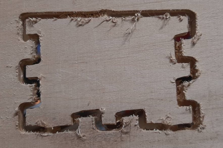

just few days ago I was cutting oak, and today I wanted to try finger joints for the first time and I have no idea what has happened!
This was 1/8 downcut bit, 3.5mm DOC, 1000mm/min, plywood.
Is plywood tricky?
I found some core wiggle, but it must have been there before. While trying to tighten it, one of the screws seem to go round and not tighten at all - like it’s turning in it’s seat on the other side? Possible?
I so hate idea of taking whole machine apart again :frowning:
Can you please throw some ideas my way?

Loose core can cause that for sure. And yes, plywood can be tricky for sure.
Is there any tightening tutorial/process like dos and donts. Order of tightening or anything?
When I was tightening I could hear core to make noise, not like “bang” but plastic taking tension. I assume it’s normal?
If I will have to reprint core should I consider upgrading to LR4?
Ahh I missed that. You are on LR3 I assume? If so check the back of your core for cracks. Overtightening can cause that for sure. I speak from experience unfortunately. I cracked 2 of them. Once you crack the back it will never get tight and stay tight again.

Back to topic though, that doesn’t look like grub screws to me. Grub screws would be more likely in my mind to end up with shapes that aren’t closed, not just sloppy corners like that. That looks like a loose core, or failed material hold-down.
Assuming that the photo is taken where the X axis is horizontal and the Y axis is vertical, the Y axis looks reasonably straight. There aren’t visible deviations where the machine is cutting in pure Y axis direction, but there is a variance when cutting in the X axis, particularly when the tool is making a clockwise turn.
My money is on the core being a bit loose on the rails.

The problem is core wiggle. I don’t know why it was working fine till now - maybe I have been using smaller DOC and it didn’t show? However… both screws are spinning in their seats. I tried sticking something there to stop them, but to no avail. They are also loctited, so it does not help…
Did you print the parts yourself? As far as I can tell, at the crack the wall is only one layer thick. if the wall is several layers thick it is much stonger.
