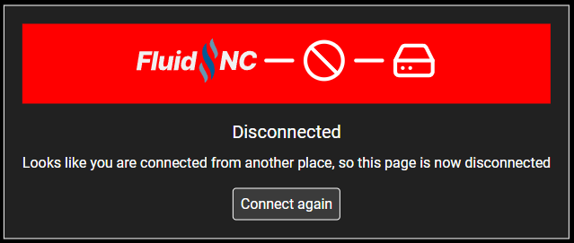

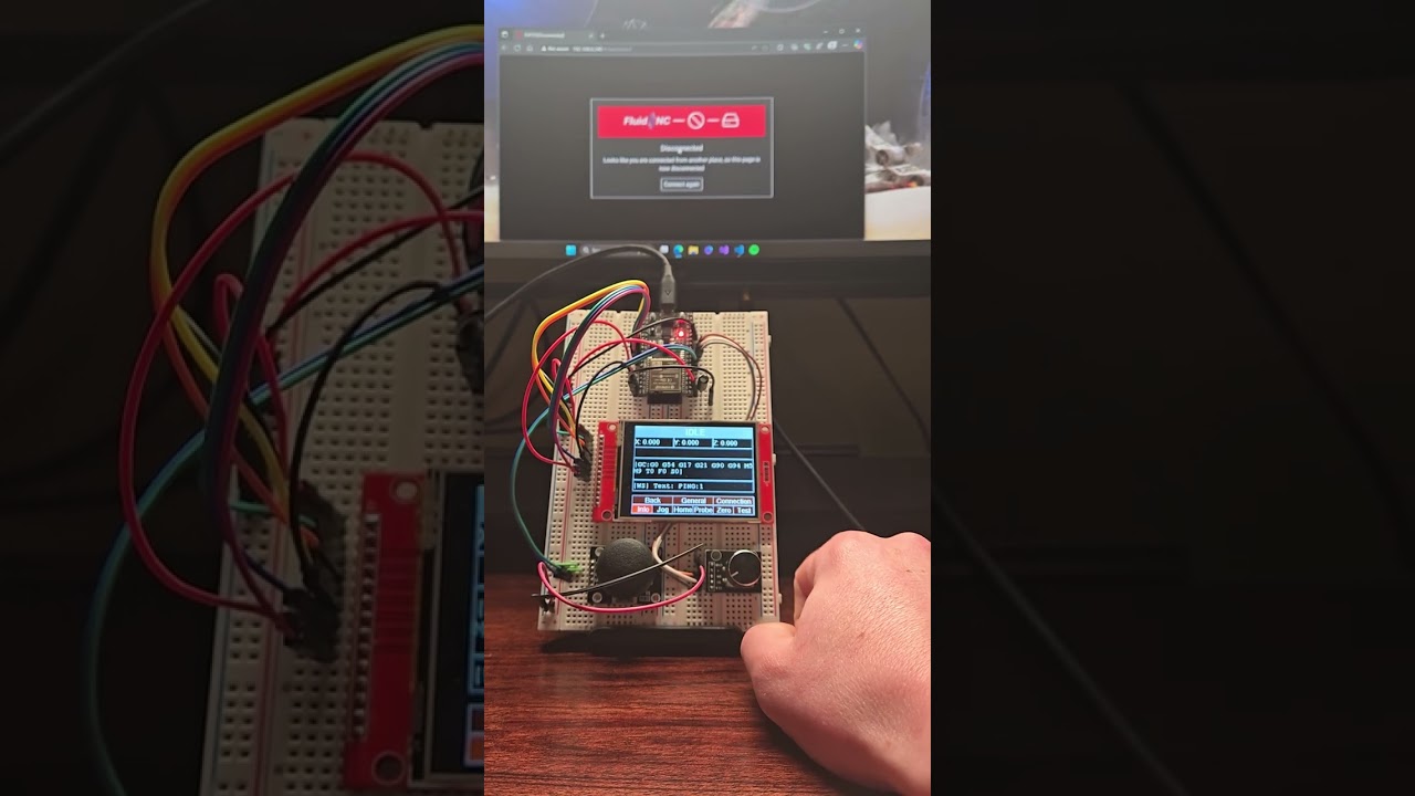

I don’t know how it would behave with WebUI v2 since that already has issues with multiple connections. However, for WebUI v3, as long as I use the same websocket port that the WebUI uses (default is 82 instead of normal 81), it will automatically disconnect the WebUI page when my device connects just like if you opened another instance. When you reload the WebUI page, it automatically disconnects my device. I just had to tell it not to automatically reconnect, otherwise it would continuously just keep disconnecting you from the WebUI page. So, I’ll just need to provide a button or something to reconnect.

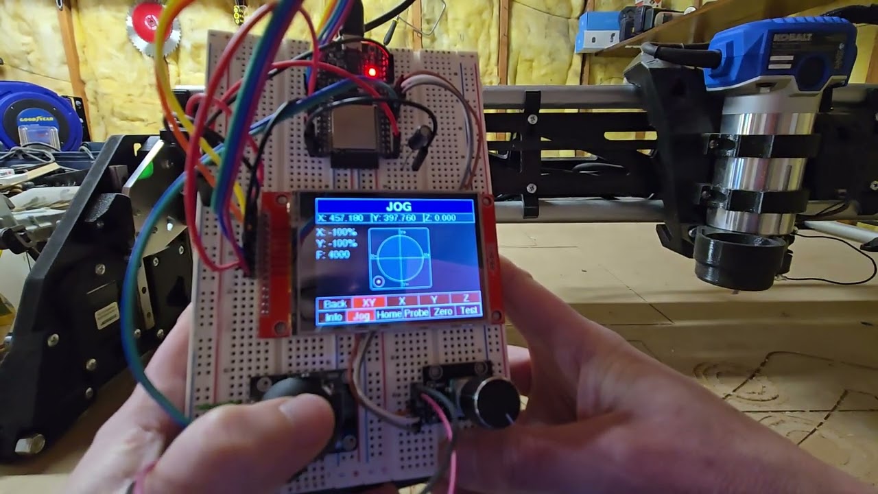

Lots of stuff to sort out with this but getting there slowly. For some reason, after homing is complete, it throws it into alarm. I haven’t gotten around to debugging that one. I’ve been switching around some libraries and trying to get ideas for a UI, specifically a menu, that is not messy code. It won’t have all those menu items, just getting ideas. This is a way different kind of development but it’s interesting. I want something simple and intuitive.

So i have a few esp32s. I would need a display, joy stick, and selector? What are you using for code?
I wouldn’t go buy anything yet. It’s going to be awhile until it’s ready for sharing. Once the code is done, I probably need to sort out some kind of PCB (which I’ve never done). And make a case for it.
But this is what I’m using currently. Some of that might change a bit for a PCB.
ESP32 - same as Jackpot
Display - Amazon.com
Rotary Encoder - Amazon.com
Joystick - Amazon.com
For putting on a breadboard, I had to desolder the angled pin headers on the encoder and joystick and replace with straight pin headers.
There’s also a 10 uF capacitor but that’s only so I don’t have to press the boot button when flashing.
This is C++ code using PlatformIO. So, flashing it is just like if you were flashing FluidNC from source.
I’ve got some UI stuff to sort out but this is really starting to come together. I changed the rotary encoder library and the menu feels so much smoother. I also got auto-reporting working which I couldn’t figure out before. I tested out displaying a hold message and resuming. I implemented homing all, X, Y, Z. It’s pretty wild how a little screen, a joystick, and a rotary encoder can make an efficient interface.
