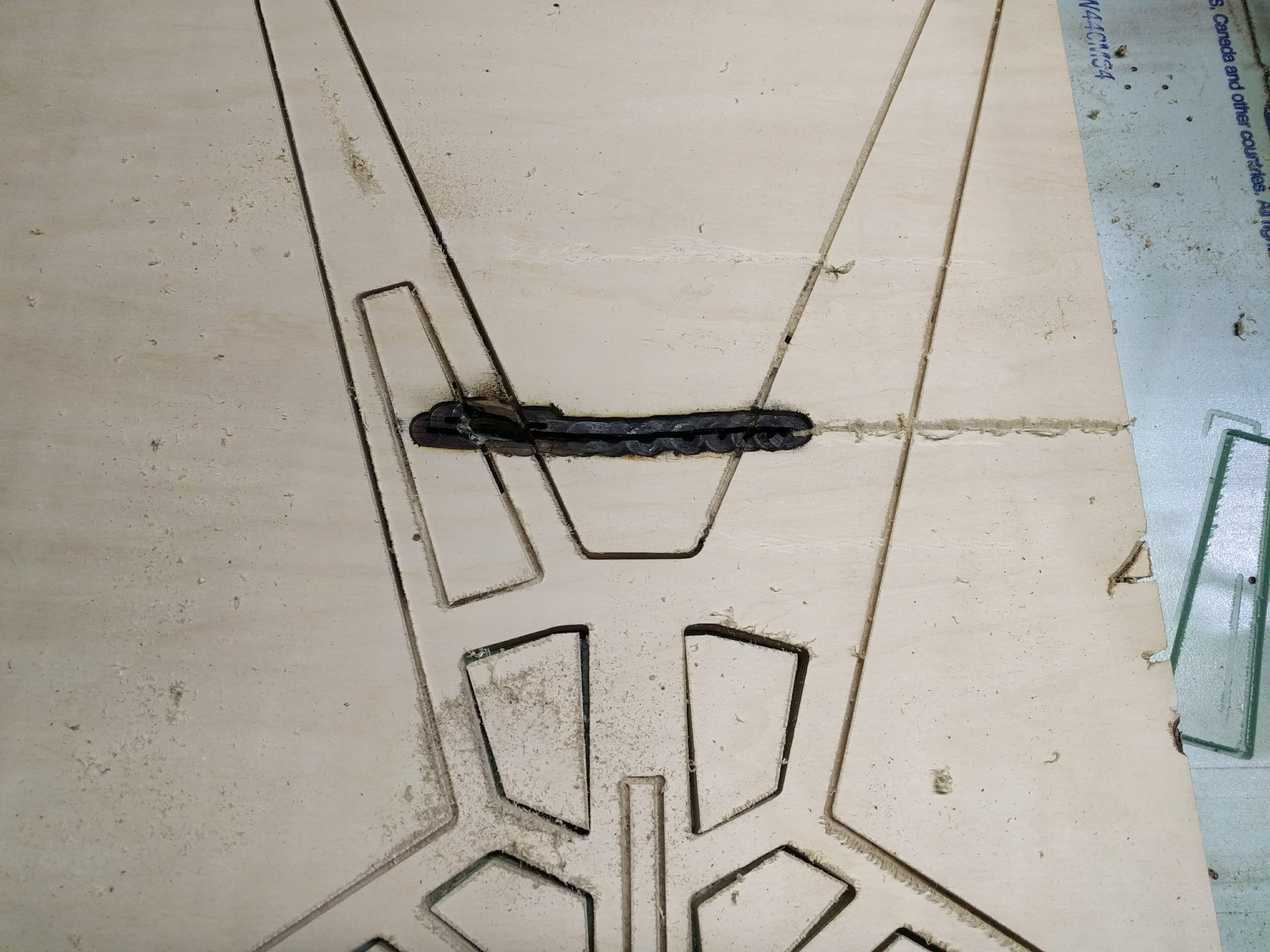

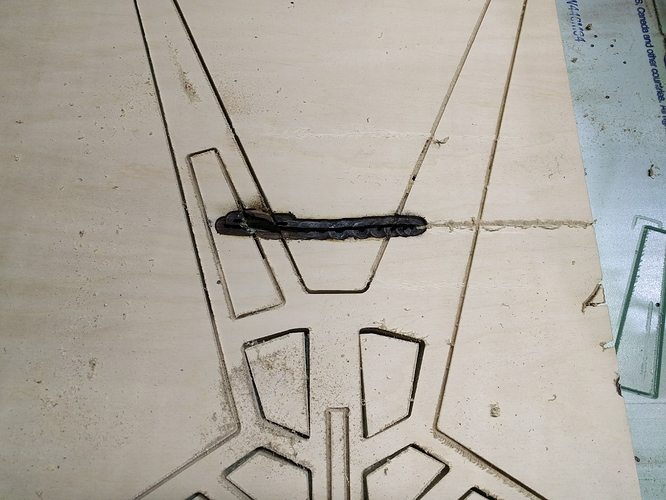

Don’t. Iv had 2 neat fires static charge resetting board and letting router drop and I was in the room doing laundry 10 feet away
Tim is totally right. It is much easier to start a fire with the router than with a 3D printer. I strongly advise you not to do this. More than the video, the sound will be the biggest clue, and I don’t think you can easily get the same sense of panic through a speaker.
In my near fire moment, I was installing a smoke detector in the garage, for this very reason. It was on, with the battery installed, and I was on a ladder, installing it in the ceiling. The CNC dug in, and I smelled the smoke first. Then my brain processed the sounds, and I could see it had dug deep into my spoil board and the collet was smoking on the surface of the workpiece. In a few more seconds, the workpiece would have been in flames, then the spoil board, table, it is all unfinished, dry wood. I would not have been able to stop it. But I was there, and I turned off the router and unplugged the machine with my power strip. The smoke alarm never made a peep.
