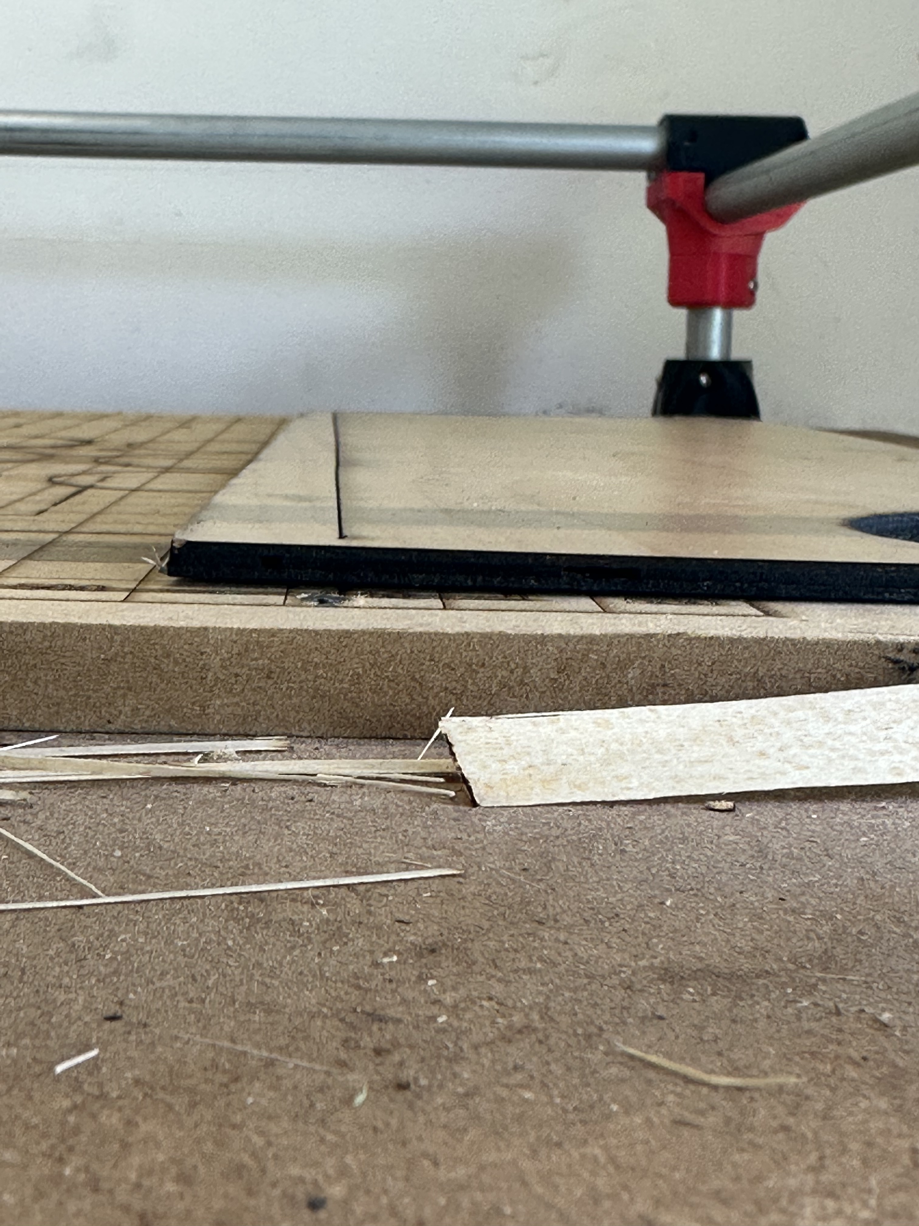

I’ve recently rebuilt my old burly machine and converted it to Primo, reusing the conduit and bearings. I’ve attached a laser module to the core, and trammed the laser module with a machinist square to my work bed. Now I’m trying to cut out a rectangle from (0,0 to 175,525) that will act as a reference point at 0,0 and 0.525 for my workpieces. The goal here to experiment with flipping workpieces over and engrave on both sides or cut thicker materials by flipping. I’m having some success but as you can see in the picture my y axis appears to wave.
My assumption is that the conduit is likely wavy, but would like to hear other opinions before i decide to tear out the rails and install new ones. I’ve checked square a dozen times and made some tweaks the best I can. my base measures square within 1/32, and i am using dual end stops that to my tape measure appear to be adjusted dead on.

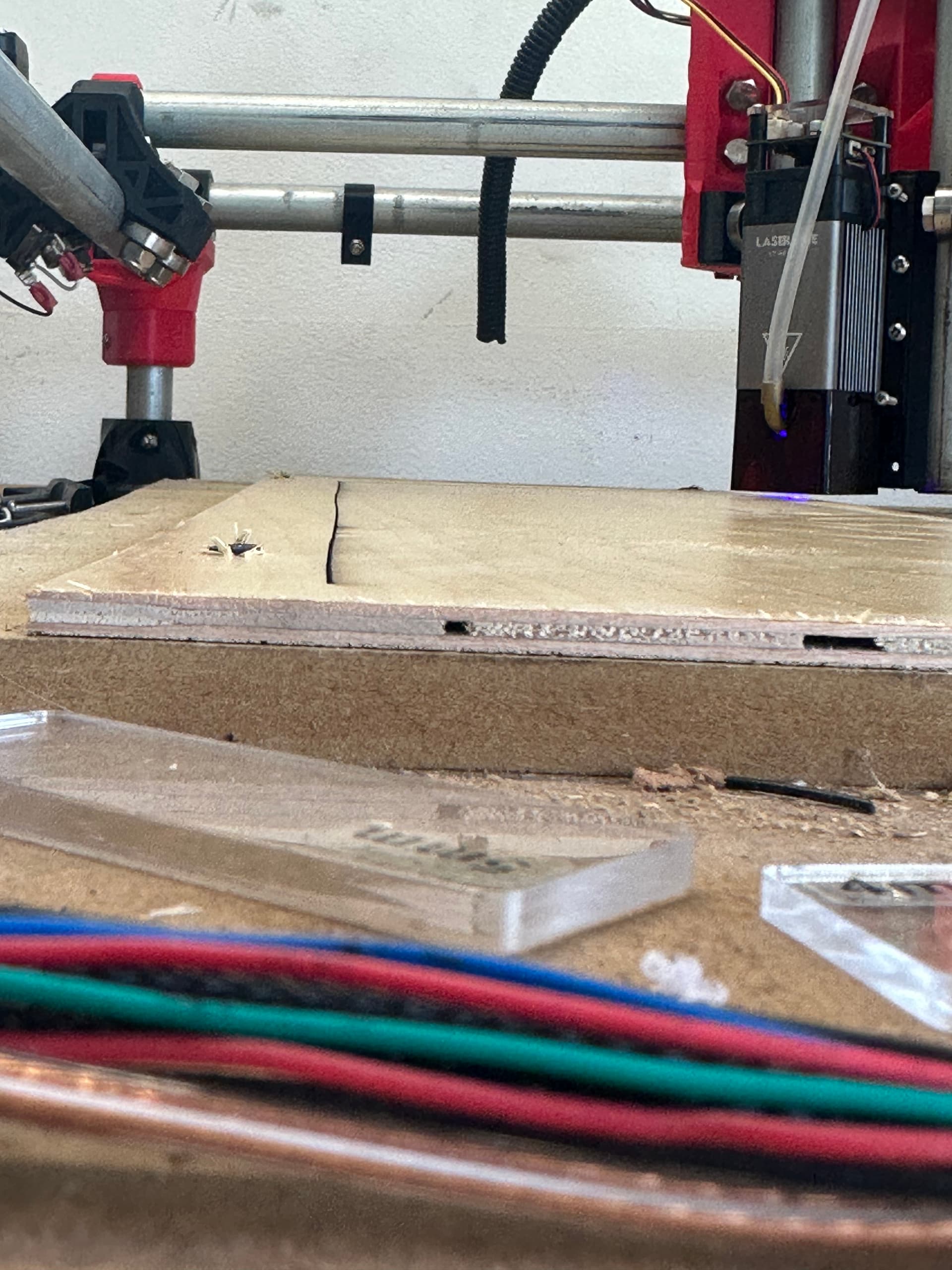

Results after tightening up the core bearings and clamps. First pass was on the opposite side of the x axis to check if the pattern was similar. It seems mostly straight. I don’t know what it was before tightening up the core

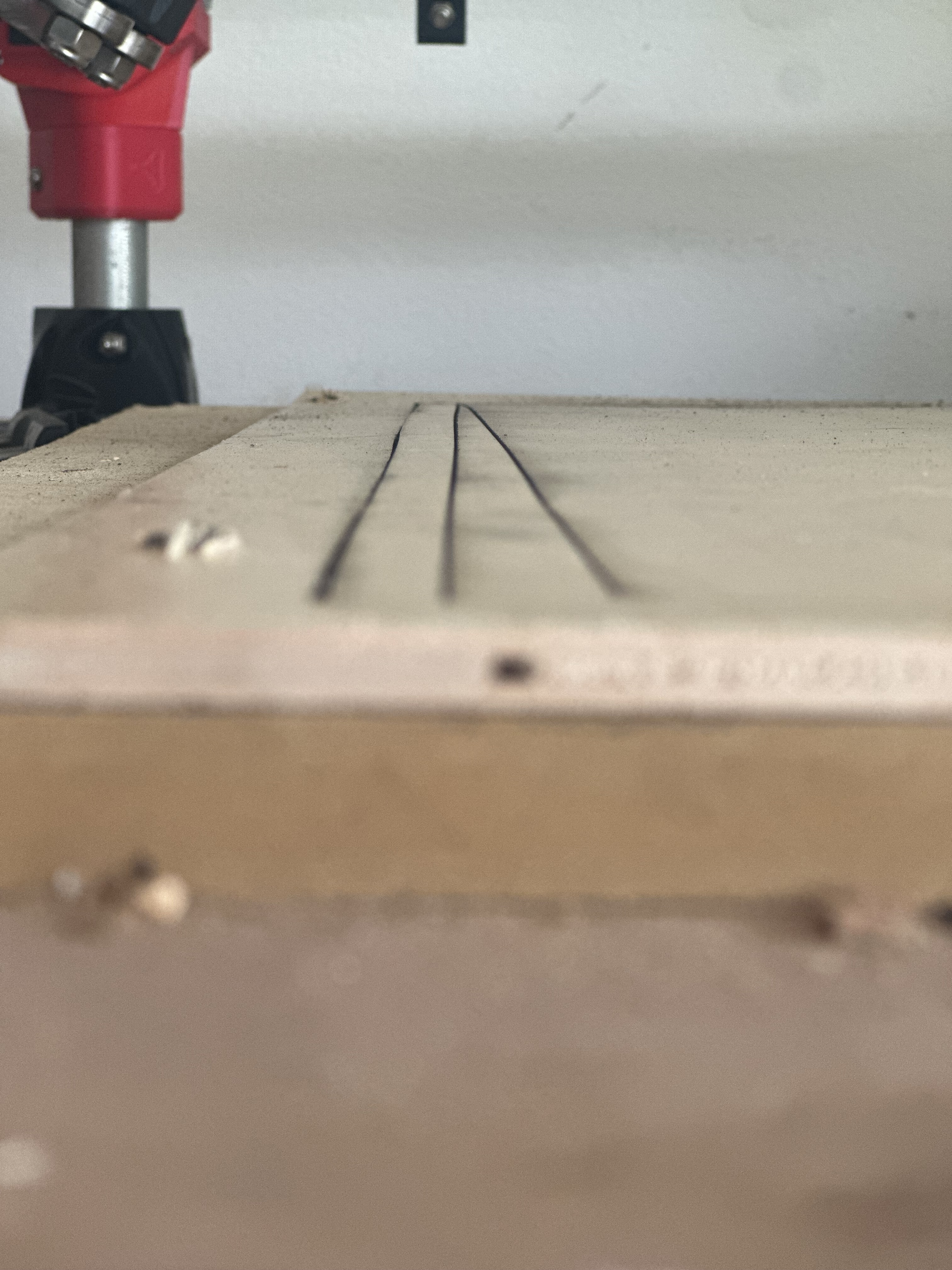

This next picture is back at the original problem spot. Line on the left is at 0,0 and line on the right is from testing at 0,500. You can see how much the original problem line straightened out.
One interesting thing I’m noticing is that while running the cut from 0,0 I can hear the y x axis limit switches disengaging about half way. Then on the return to 0,0 they audibly re engage in the same spot. Makes me thing there has to be wobble in the y rail. I don’t think the gantry rail could cause that. I’m going to rotate the left side y axis rail 90 degrees and see what happens.
