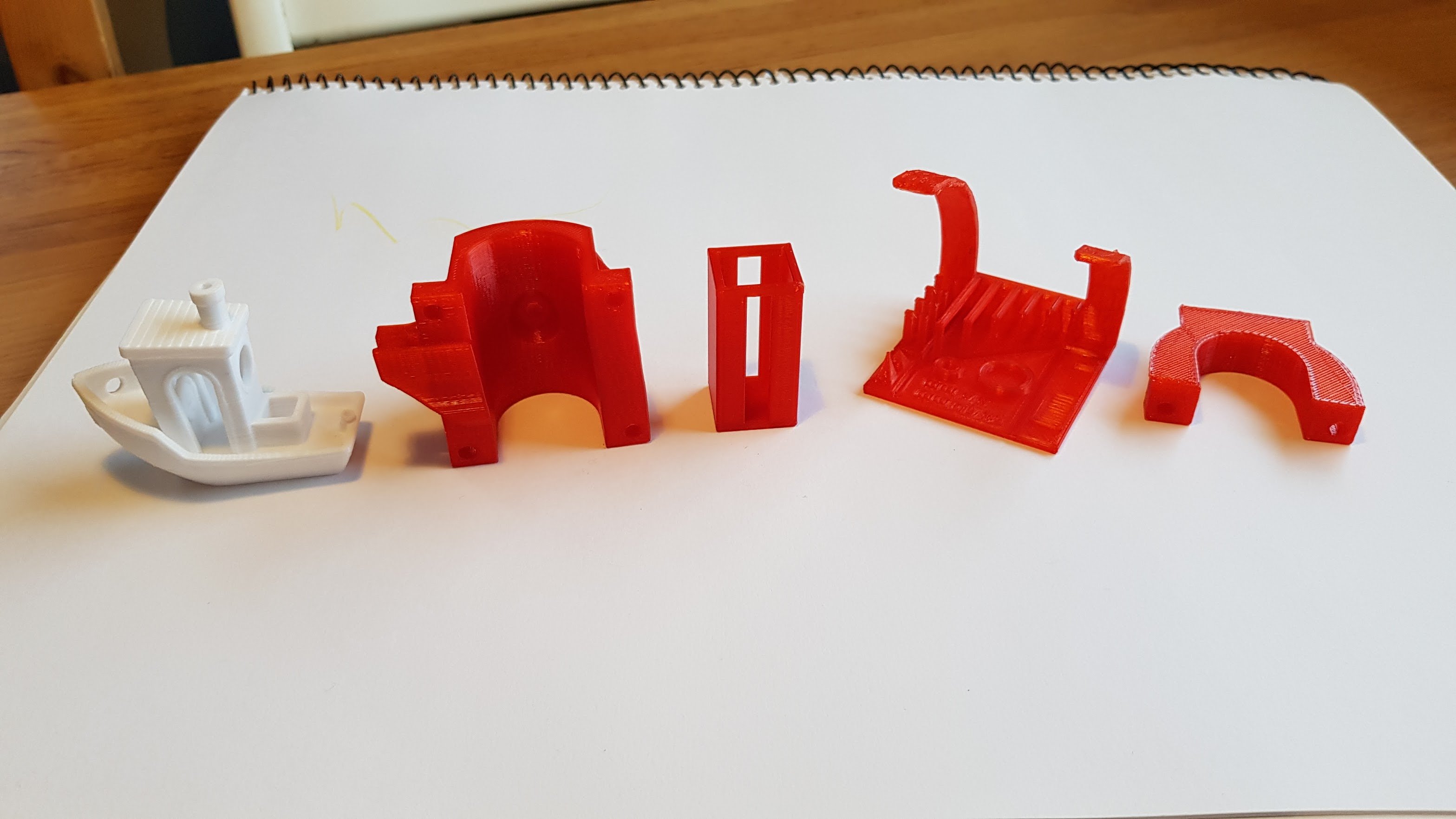

Hi all. I got myself an Ender 3 PRO to print the MPCNC parts. I bought it used, not having had any 3d printing experience from before. I’ve spent a week getting it to run smoothly. I seemed to have figured out most of its quirks and personality traits, and I was eager to start producing parts. The dress reharsal (Benchy) went very well.

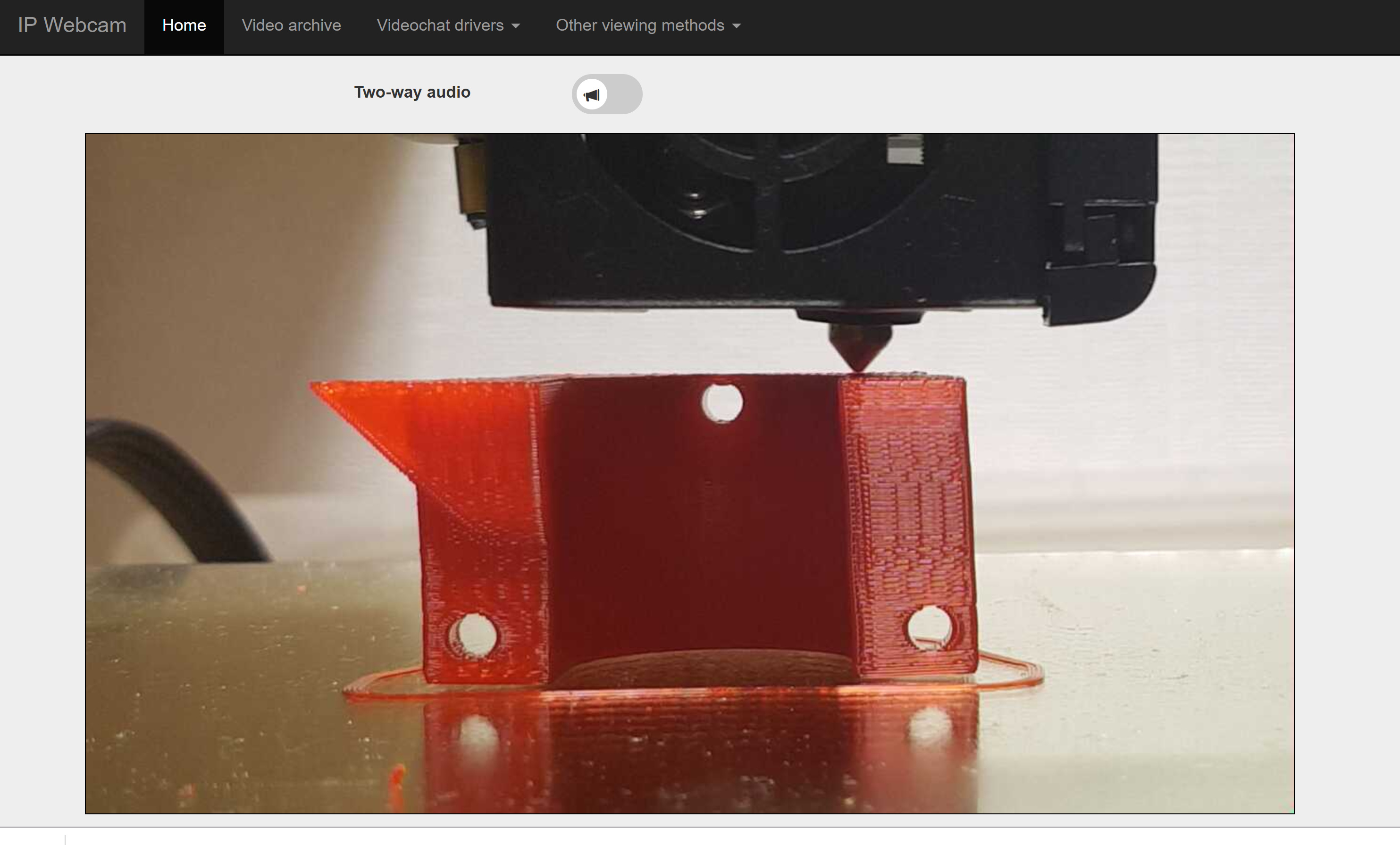

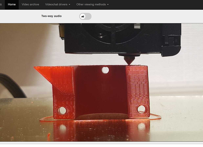

BUT ALAS! When printing the bottom corner, the whole thing seemed skewed! No straight angles or sides. I oiled the z-screw, further stabilized the bench it stands on (screwed it even more into the wall), added more adhesive (hairspray) to the bed, and reviewed my settings. I used 0.26mm layer height (0.4 nozzle), 30 mm/s speed, 100mm/s travel speed and infill as instructed.

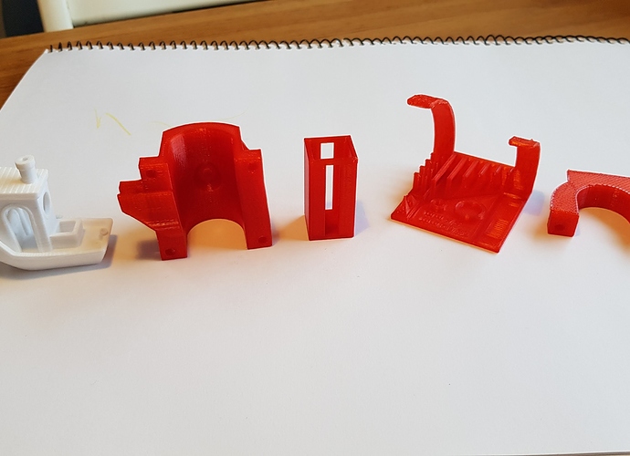

Having tried all these minor ways of improving the print, I tried printing a new type of testing piece. It all seemed relatively fine. Then I made a little tower, to see if any shifts/warps occured - nothing. So now I’ve tried yet again - but the piece seems to warp from the board - even though I have added yet more adhesive. It seems that this piece has a shape that makes my print prone to warping. How can I prevent this? 1/4 parts glue/water? I’ve been hesitating with bothering you with this issue, but now I feel like I’m hitting my head at the wall…

Make sure the tension on the X arm belt is not too tight or too loose, I think skipping steps in the X direction could cause the layer shift shown in your picture.

Thanks for all the helpful input! Unfortunately, I don’t follow Ryans rule of life - to exclude only one variable at a time… the print on the raft turned out perfect! (apart from the minor cosmetical traces of the raft)

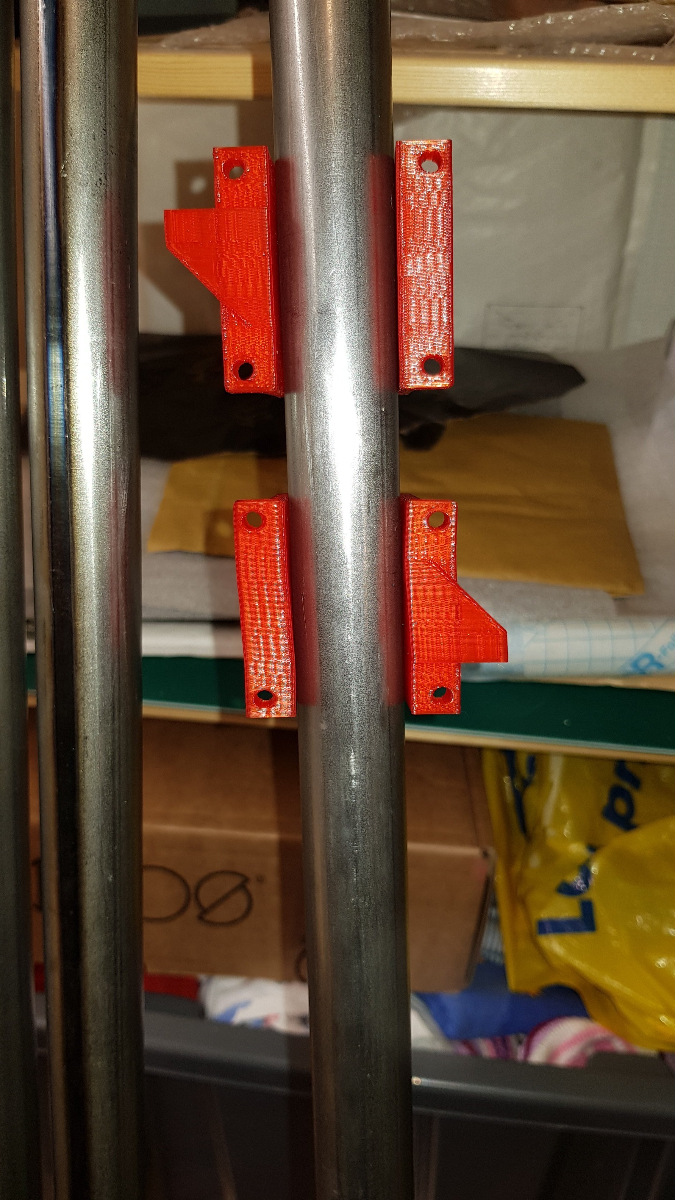

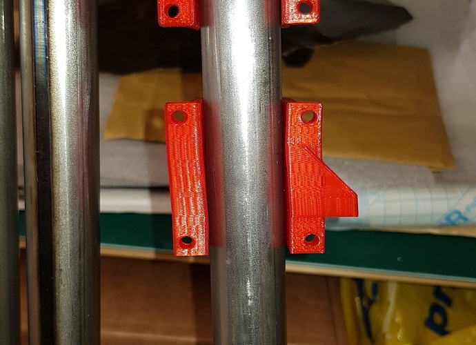

I tried the skewed print on the rail, and it actually fitted well enough. But I’ll not use it, I think that the mechanical stress can break it too easily. The warped piece is the lowest, and the one printed on the raft is on top.[attachment file=104134]
