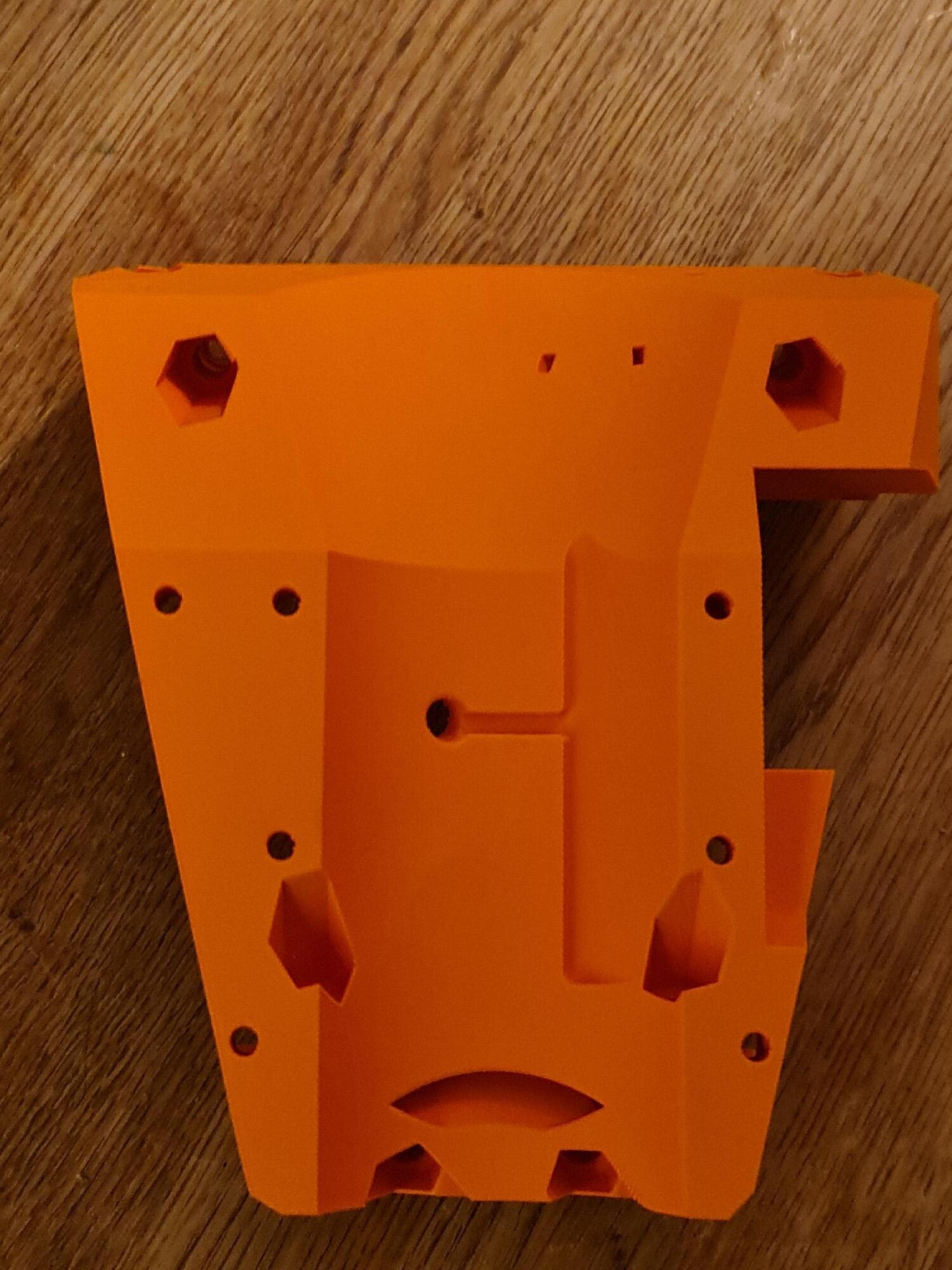

Getting some nice first layer for the core, printing in orange pla. I did a testprint and the bed was off in one of the corners so I am glad that I cought that uneven bed with my testprint.
Now 17h to go before the core hopefully is printed in good quality in 0.3mm layer height. Seems to take around 125m of filament.

This is by far the longest print I have done, 17 hours and 125m of filament.
I am letting the build plate cool so I haven’t inspected the core yet.

That looks solid!

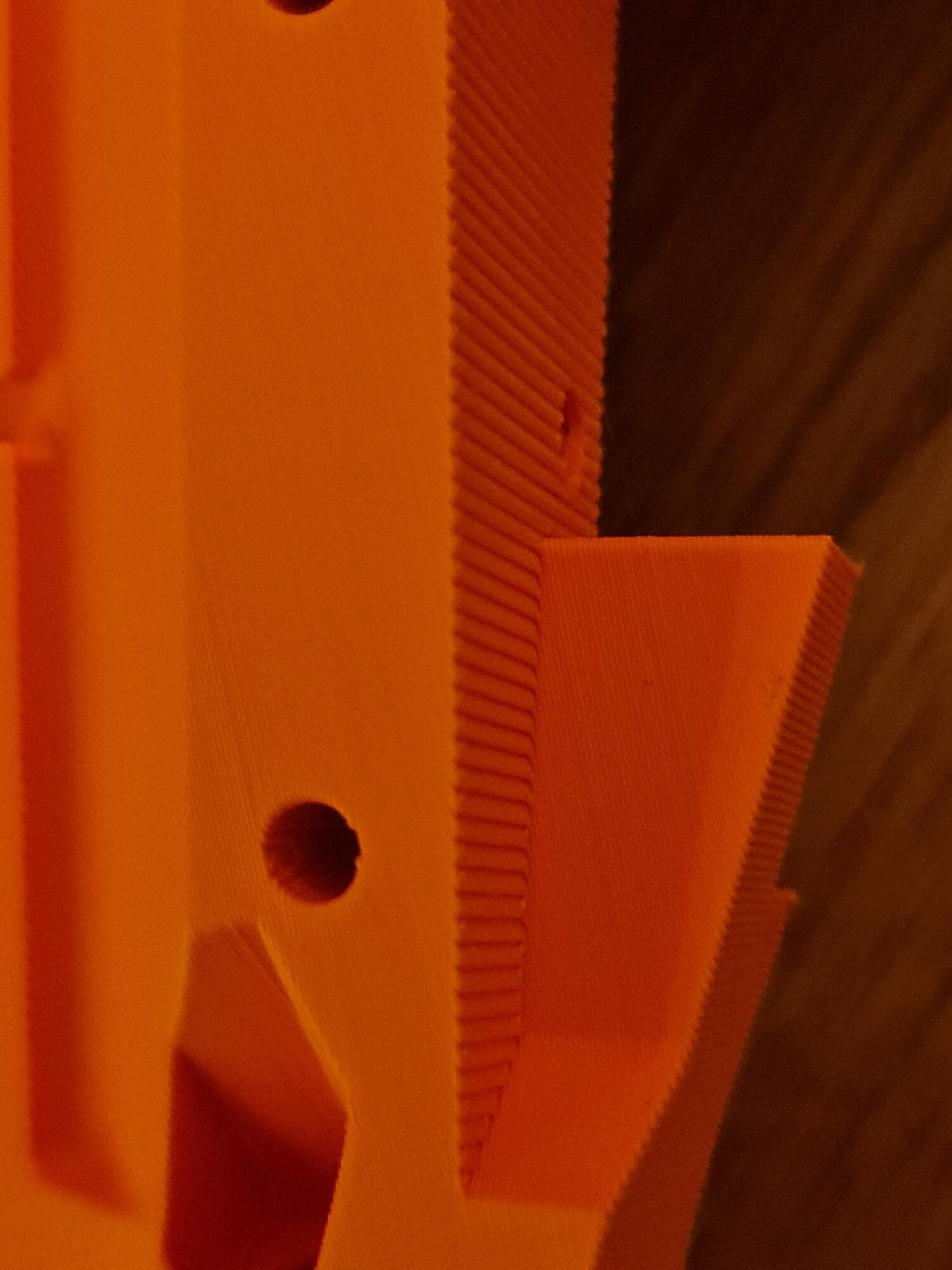

Would you be able to take a pic with the focus on the part and the layering? I don’t think we’re getting prints that clean but would like to see a clear comparison since you’ve been doing a lot of fine tuning for this.
Hi,
of course I can do that. I would rate the print a 8/10. There were some underextrusion on the backside and some blits, also on the backside. Overall, I am happy with the print and with the ender 5 plus. It´s proving to be a workhorse.
The core is printed in 0.3mm layer height and I think between 70 and 80mm/s. If I would reprint it, I would go for 60mm/s.
