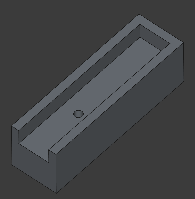

Designed a holder for a fountain pen this morning.
Gravity feed pen problem… solved!
Need for a special toolbin… created!
Pen is a Pilot Kakuno

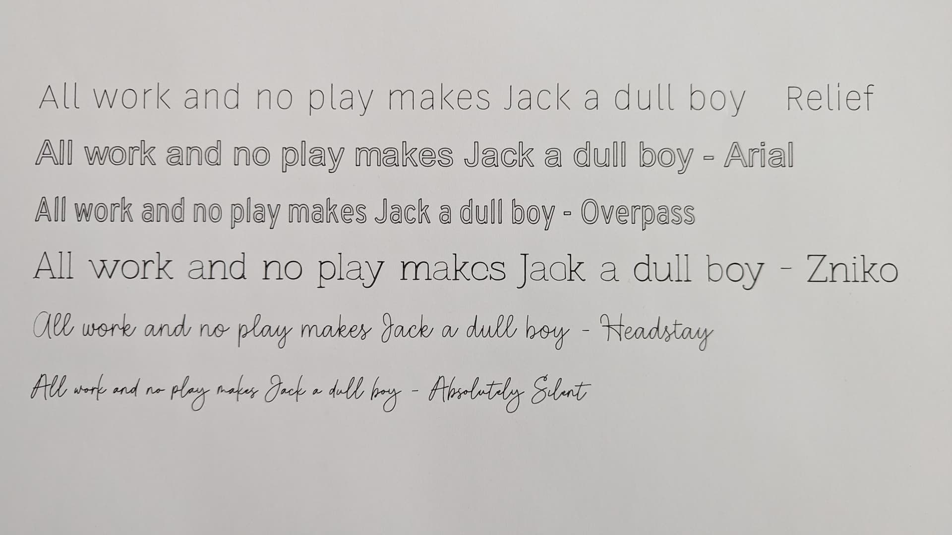

What font is that? It looks great.
The font is called Headstay. I bought it for a few bucks on Etsy. They have a free download but the numeric characters aren’t included.
For anyone curious about fonts and pen plotters, I know way more than I care to. Basically, there are very few fonts out there that are easy to pen plot without lots of manipulation with code or a font editor. In a nutshell, all the paths (vector definitions) that make up a font’s glyphs must be closed (start and end at the same point). That doesn’t translate very well to a pen on paper. The reason I chose this font is that it is a true “single line” font, meaning that it defines each glyph as a series of lines and curves and when it gets to the end, it retraces itself (exactly) back to the beginning. That way, it adheres to the font standards of having a closed path, but the appearance is a single line. I still had to write the code that detects when the glyph starts retracing itself and omit that part from the tool path so every line isn’t drawn twice. I worked on this for quite a while and I only wound up with 4 or 5 fonts that work correctly on the plotter.
That makes sense. I know Bob did some tricks to take the line segments from the fancy text in sandify and break them into line segments and then order the segments to reduce redrawing.
Writing text with a pen plotter appears to be quite the rabbit hole.

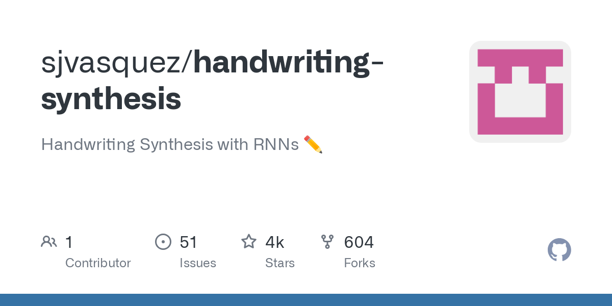

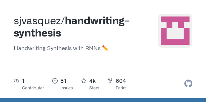

I stumbled across “handwriting synthesis” which seems like it could allow for more natural writing. I saw another project generating gcode from this output.
There’s a demo here. Slow the speed down and you can watch it.

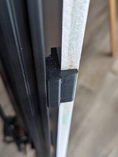

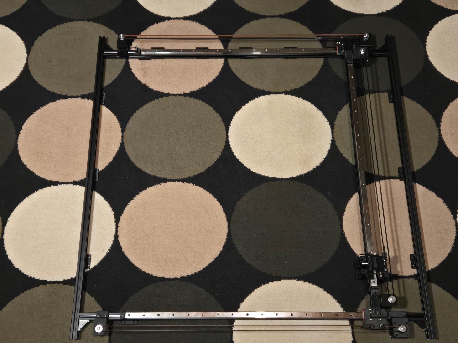

I got the 2020 extrusion, rails, and some other hardware so I’m wrapping my head around some things before I get started. I think this is mostly because I’m downsizing it so I’m not working to a factory 49" width.
I printed one of each A and B so it’s helpful for me to visualize how this works. My plan for now is to print everything in PLA with a 0.4mm nozzle, 0.2 mm layer height, 3 walls, 75% infill, 6 top and bottom layers. I’ll adjust settings/filament types as needed along the way. At least for these pieces that’s more than strong enough.

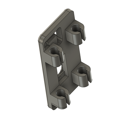

On the frame, it seems that with part A, there’s not really any wiggle room with having the board width exactly correct. I suppose as long as the vertical sides of the back board are at least parallel (which I’m confident I can do with my table saw), it should be fine, and I could measure the X gap before cutting those extrusions.
Alternatively, I think I could just use part B instead of A. This would mean the back board should be about a half inch wider since they offset by about a quarter inch as shown in that second picture. Part A and B appear to be the same other than the lip that goes along the edge of the board.
I’m somewhat inclined to leave the back board oversized until the frame is attached, and then size it against the extrusion with a flush trim bit on my router table. I have to buy a whole sheet of MDF either way even though I only need roughly 3 feet by 3 feet.
I’m in no hurry here. I expect it to be a couple months until I have a functioning machine.
That all sounds good. Print settings should be fine. As long as the frame is square and you’ve got it mounted firmly to the back board, either A or B will work. MDF likes to tear, so predrill the holes.
The blind extrusion joints don’t always want to seat up perfectly square so they might need some help from the mounts.
That Calligrapher AI project is very interesting. I must admit I got lost pretty quick trying to read Alex Graves paper but the demo is cool. This is as far as I got with the fonts.
The first one (Relief) is a nice generic single line that works well (although I see I didn’t get around to editting the dash (-). The next two (Arial and Overpass) are examples of unmodified tt fonts. They are great as long as you want the double line look and you don’t mind the extra time it takes to draw. I started modifying Zniko but lost interest. You can see how some lines are darker (drawn twice) and the e and c are not right (that is common). And the last two are true single line fonts that I already mentioned. Although I still had to modify a character or two because the “backtrace” definitions had an error.

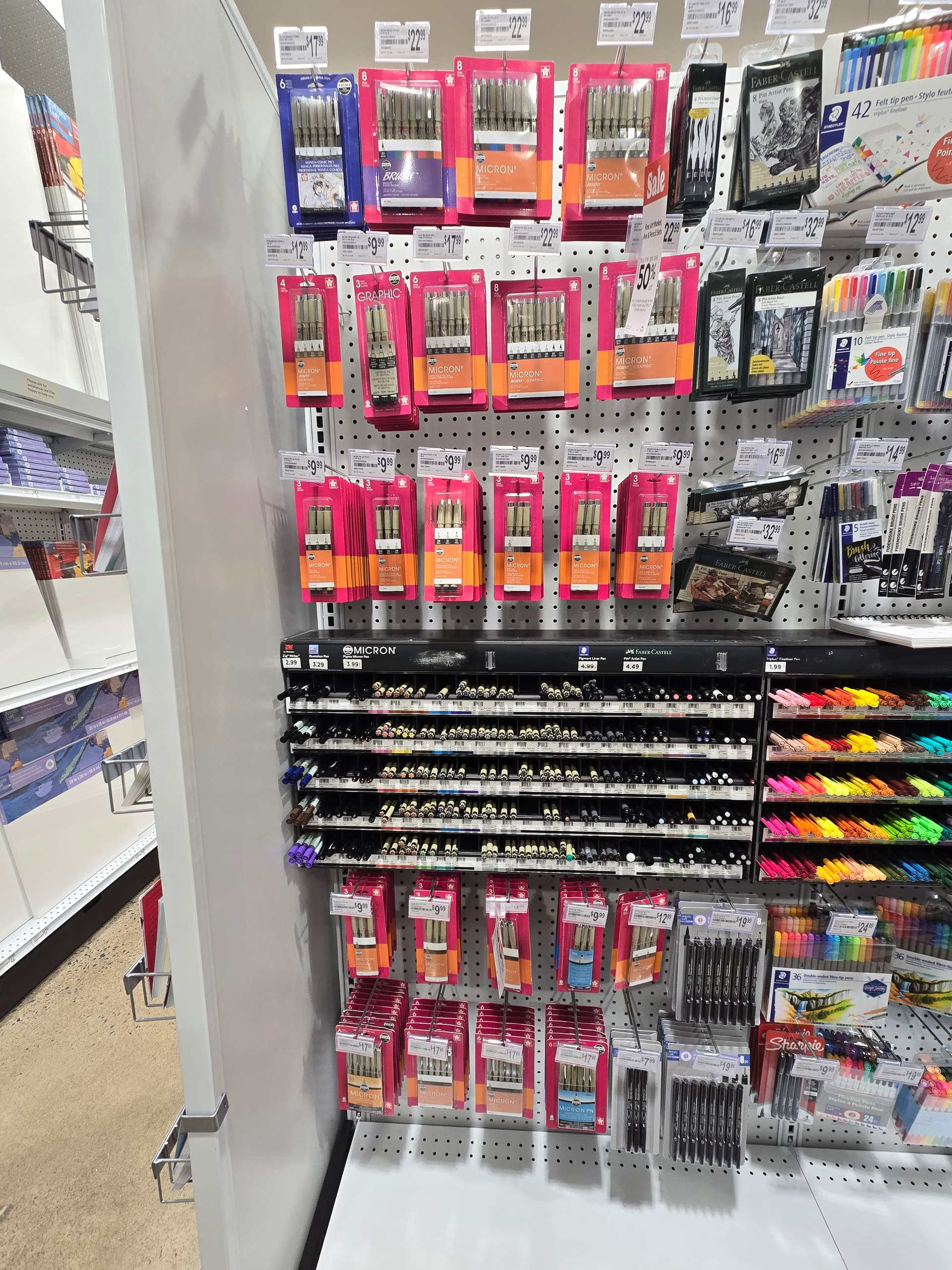

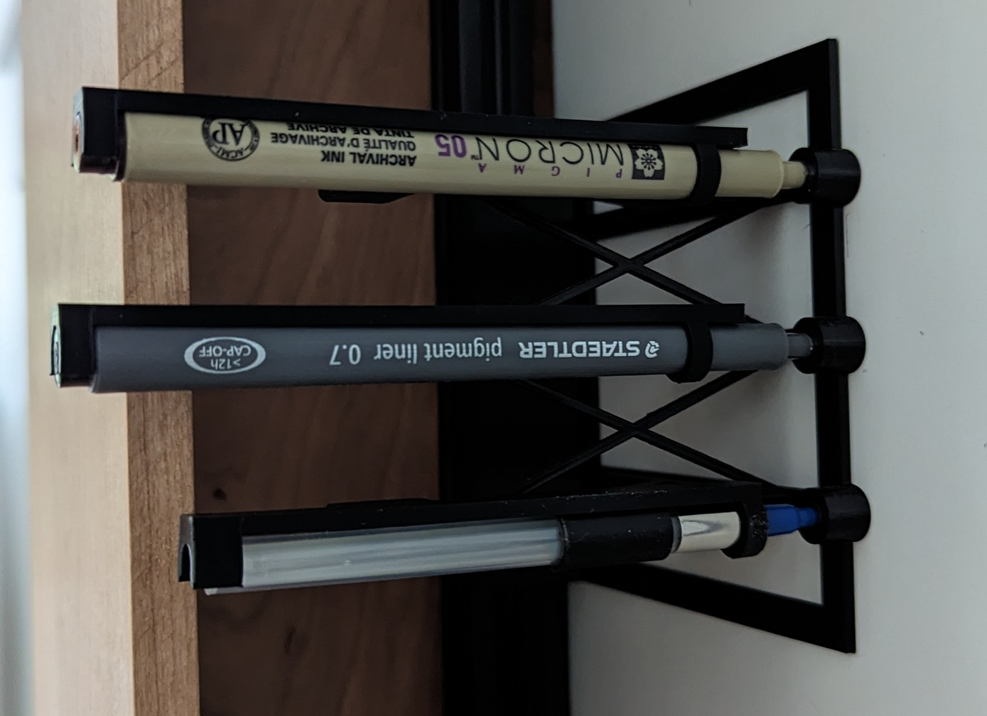

Wow. Stopped at Michael’s for a different reason and was looking at pens. Didn’t realize there were so many options in just Pigma Micron, not to mention the rest of the aisle. I see the Staedler Pigment Liner pens too.
Any suggestions on tip type/size?
Edit: I see this shows the size. Obviously, there’s some room for experimentation here but I imagine going too fine could be an issue. I guess it could be interesting using different tip sizes on the same drawing, even if it’s the same pen.
I go with the Pigma Micron Fine Liner 05 (.45mm) for most stuff.
You can get the black ones on Amazon for under $2 when you buy a 12 pack. Same with an 8 pack of assorted colors. If you are looking for a specific color, the pricing is nothing short of insanity. At one point, Michaels had a decent online price for Sepia pens, less than $3 each, but then you look the next week and they want $8. It’s insane.
The Uni-ball Powertank cartridges can be had for less then $1.50 each on Amazon. I’ve found it cheaper to buy a set of 12 (complete pens) and remove the cartridge. Again - insanity pricing. You’d think you could get a box of refills for less, but no, cheaper to buy 12 and throw away the housings. Make sure you get the retractable style (they have a metal ring towards the drawing end as seen in the above pic just above the blue plastic tip).
For a cheap alternative, I do have a holder for the “Mr. Pen” knockoffs found on Amazon, but they run out much quicker than the Pigma Microns, so I abandoned them as an option.

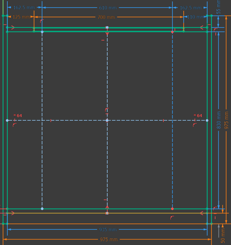

I’m looking for a couple measurements to validate my resizing. I have some time this weekend to work on the frame anyway.
What’s the distance from the right end of the rail to the inside of the right vertical frame extrusion?
What’s the distance from the top end of the extrusion to the rail?
I’m using 24" paper, with 700mm rails, and have 1000mm extrusion. These are my calculations currently. I’ll be making some slight tweaks. I’ve done some rounding and conversion so everything is in mm. My intent is to have the Y-axis extrusions reflect the full height of the backboard with it providing some protection at the top similar to the bottom. I don’t show it here but the Y-Axis extrusion length is 49mm longer (we’ll call it 50) than the inside distance between the top and bottom horizontal extrusions.
On my 36" plotter it is 100mm
On my 30" plotter it is 95mm
The 5mm difference is simply due to the length I cut the rails on the 30". With 95mm, the X-Axis motors have 35mm of wiggle room before they hit the right vertical frame extrusion. I don’t know where your rails fall in the equation, but you should be good down to 70mm (distance from the right end of the rail to the inside of the right vertical frame extrusion) if you want to avoid cutting them. At 70mm, the gantry is over the Jackpot, which is fine as long as the wires connected to the stop switches are arranged so they don’t interfere with the underside of the gantry,
If my math is correct - a 700mm rail should land you around 100mm, which is perfect.
Edit: I see now that you came up with 110mm. Even better.
105mm
It all checks out. Thanks!

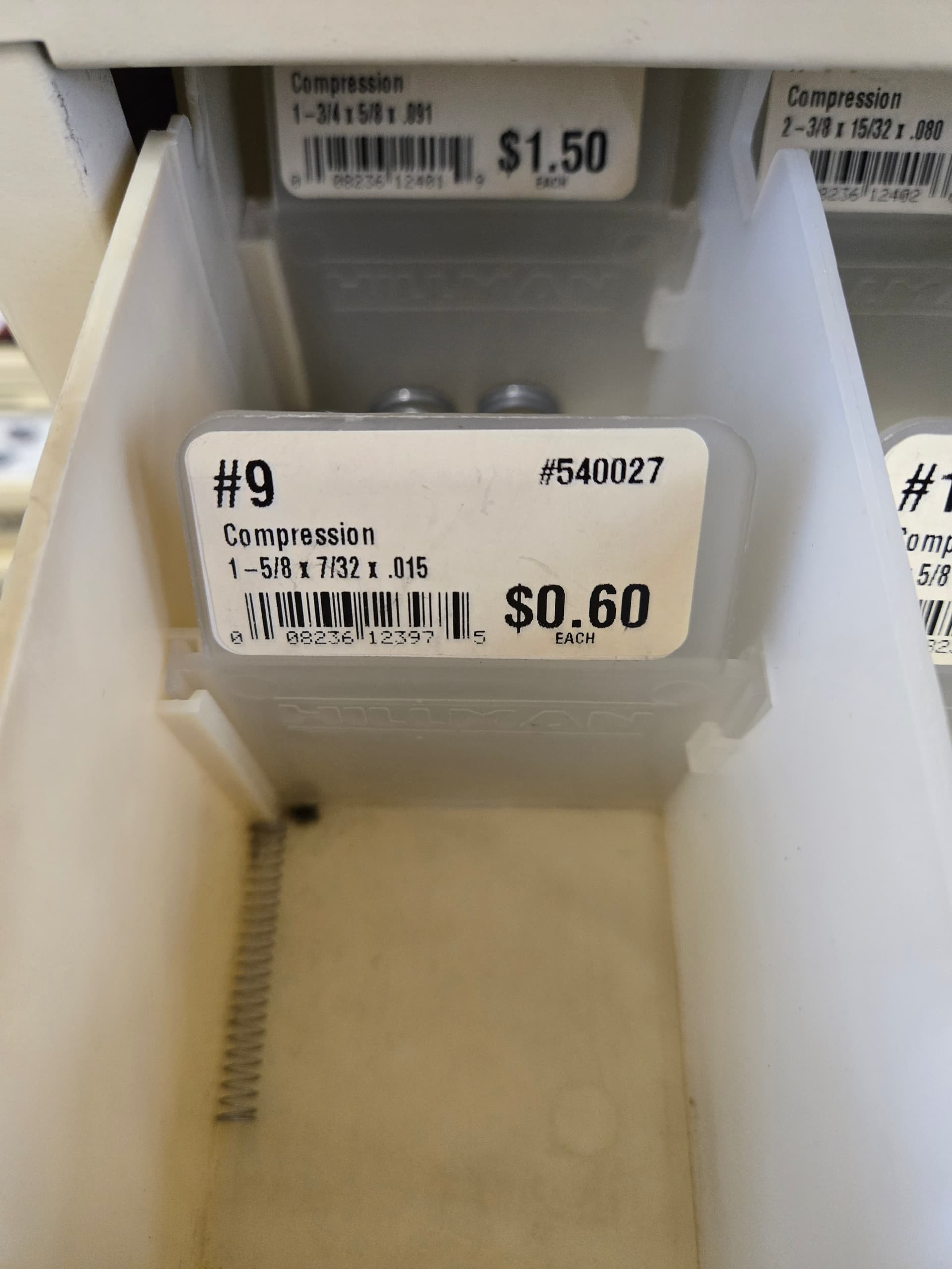

For anyone trying to source this, I found it at my local Ace Hardware store. It’s a Hillman #9 compression spring (SKU 540027). I feel like this is probably the trickiest item in the BOM to find.
shop.hillmangroup.com/ccrz__ProductDetails?sku=540027&cclcl=en_US
I was originally going to use a 1-1/2" x 7/32" spring that I found in my spring assortment kit, but the intended spring is significantly easier to compress than that one.
Just wanted to say my build is going smoothly and it’s been an enjoyable experience. Here are a few notes I wanted to make while I was thinking about it:
I agree with waiting on attaching to the backboard. There have been times where it’s been helpful to have access.
Just a BOM note that you need 3 M5 locknuts. I got those at my local hardware store.
I had to do this for the 3 larger steppers. I just put some bubble wrap on the shaft and used a file. It only took a few minutes per stepper.
Another BOM note. At the moment I’m using some M5 lock washers but they are a bit too big. I think I might replace them with M4 lock nuts. Either way you need 6.
When I put the belts on, I first attached the belt mount in the non-slotted hole. Then when I wrapped it around, I adjusted the belt so that proper tension (or what I think is proper tension) was at the end of the slot. I’m not sure if this is easier or not, but I felt like it gave me good control on adjusting the tension, since I could adjust it one notch at a time.
I ran into this same exact thing. I bought ReliaBot branded rails on Amazon that came with MGN15H blocks and got a MGN15C separately. When I put the MGN15C block on, it was too tight and didn’t slide smoothly. After replacing the balls, it slides great. I thought this was going to be a pain, but it was easy. You just slide it off the end carefully, and there’s a wire that holds the balls in place. I used a pair of tweezers. It was interesting to see how they worked. I didn’t realize there was a loop of balls on both sides.
My only experience prior to this using aluminum extrusion was putting together my Ender 3. Wow, these are so much easier to use than the standard T nuts. The extrusion I bought included some corner brackets which I added since I had them. They used the standard type and they’re a pain.
Another BOM note is that you need some M3x8 socket head screws. The kit listed in the BOM doesn’t include that size.
Glad to hear the build is going well and thanks for the feedback. Was curious how the 3d printed parts were working out. As I mentioned, I printed all the frame mounts, trucks and motor mounts in ABS and I assume you are using PLA. There can be a slight size difference between the two and I was wondering how things like the motor mount holes and the trucks (to MGN15 blocks) holes are lining up. Also, the belt mounts and idler mounts?
Edit: Good call on those extrusion brackets. Much easier than blind mounts. Are those 3d printed? You might want to upload models or link to parts for future makers.
I haven’t had any issues. Yes, I’ve printed everything in PLA. It all lined up perfectly.
The only thing I modified were the holes for the brass nut inserts. Note I have never used these before and I did a bit of practice on those Mod 1 X-Axis Stop Bracket for Homing Switch. They were a quick print. The small end of the insert didn’t fit in the hole, so I drilled them bigger with a 4.5mm bit. I also slightly chamfered the hole on both sides with a larger drill bit. This kept the plastic contained yet I think the hole was still small enough to have good strength. Without doing this it made a bit of a mess and got plastic inside on the threads. I wasn’t able to use the tip that came to put them in, but just used the regular tip on my Pinecil soldering iron. Setting it to 240 C seemed to give me time to position it without melting too fast.
Oh I actually did blind joints first and just added them since I had them. The brackets were aluminum and came with the extrusion I bought. While the M6 tap and 5mm hole was appropriate for the extrusion I got, it sounds like some extrusion would use an M5 tap.
I was pretty careful to try and make everything as square as possible. So, when drilling the holes to access the screw, I did make some quick jigs to make sure I drilled the hole in the right spot with my cordless drill.
