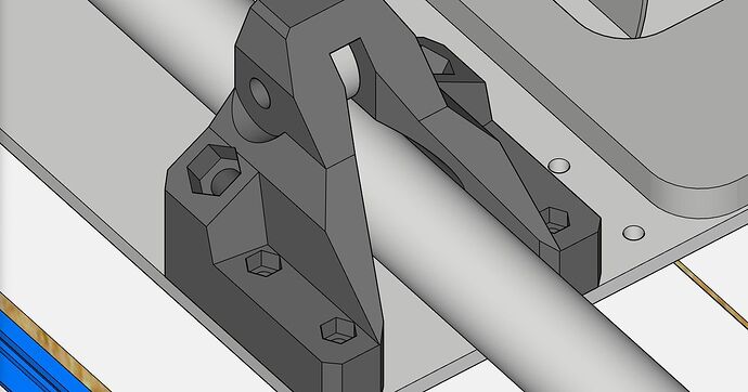

[DIY Panel Saw] Z mount (v7a) by Design8Studio
https://www.thingiverse.com/thing:5345250
Below is the text from the posting:
These 3D-printed Z Mounts, which are inspired by the LowRider 2 X Mounts, can be used in combination with 608zz bearings to grip a steel pipe or tube from three sides per mount, providing a sliding mechanism which can be applied many ways, and in my case here, for making a sliding saw sled for a type of panel saw.

Printing notes:
No supports needed. Be sure your slicer’s “bridging” supports are enabled. In Cura that is located under Experimental. Because this part is structural and needs a lot of strength, print at 3-4 exterior walls and 50% infill. I have my slicer set to have my .4 nozzle emulate a .6 nozzle, so for me, 3 walls is as thick as 4.5 walls.
There is no great need to print a mirrored version for two of the four needed mounts, but I did it so the top bolt head would always be facing toward the outside, to ease tightening and loosening of it.
Mounting notes:
The holes for the bolts to hold 608zz bearings are made for M8 bolts. The capture slots for them are intended to hold M8 nylock nuts. The mounting holes and capture slots for attaching each mount to the base plate are intended for M5 x 25 mm bolts and M5 nylock nuts.
Note that tightening the top M8 bolt is intended increase the mount’s grip on the pipe, and loosening it will reduce the grip. Accordingly, if you mount the M5 screws very tightly, and/or if the M5 clearance holes in the base plate are too small to allow a little wiggle room, this will thwart the ability to tighten and loosen the mount’s grip on the pipe. If you tighten and nothing happens (pipe still slides too freely or there is slop in the mount), loosen your M5 screws and then retighten them after tightening the top M8 bolts.

@olijouve If you are interested in building this version, I could perhaps redo the 3d-printed parts I designed (what I’m calling the Z mount and the pipe inner endcaps) so they are made for 25 mm instead of 26.67 mm (1.05").
One thing to bear in mind: the Z mount is based on O.D., but the pipe inner endcaps are based on I.D. so I would need to know the exact inside diameter of whatever tube you plan to use.
I am using mine in the Z axis, and am using the LR2 X mounts. I have had no trouble with that setup. These have a little wider base, but mine is plenty for the circular saw I use.
@SupraGuy That’s good to know. Mine would then seem to be a bit over-engineered, but I am OK with that.
@SupraGuy One thing I had considered, is this multi-material saw is beefy. The thing is hefty. I think (based only on feel) that it weighs a little bit more than my Skilsaw Classic saw. I might have been OK with the the skinnier “feet” on the mounts, but I feel a little better with the wider feet, which have 4 base plate screws per mount instead of two.
I can see how that would be.
I just used the LR2 mounts because I had them. I printed them in PETg as an experiment, and was looking at them trying to think of what to do with them, after I had bought a complete set of printed parts as a part of the LR2 kit. (Before it arrived.) I thought that I could use them for a panel saw, and so I did.
I am using a classic skilsaw, but I haven’t had any trouble with using it for anything that it can cut. I think that if it was good for the cut loads on the LowRider, it should be OK for the loads on the circular saw. The bearing mounts take the brunt of it all, if I understand the loading correctly.
Still, a stronger mount isn’t a waste. I used what I had, and it seems to have lasted a reasonable length of time so far, but I wouldn’t say it has been exhaustively tested.
Yes, that’s how I am looking at it. Unless an engineer does stress calculations, my approach is basically make it overly strong enough to trust.

I would say so. 1.05 (my conduit) and 1.06 (your conduit) are pretty close. You should be OK. Remember that the four mounting screws (that attach the Z mount to the base plate) have to be slightly loose in order for the M8 bolt at the top of the mount to tighten the bearings onto the conduit. Once the bearings are gripping the conduit well enough, the base mount screws can be tightened up.
