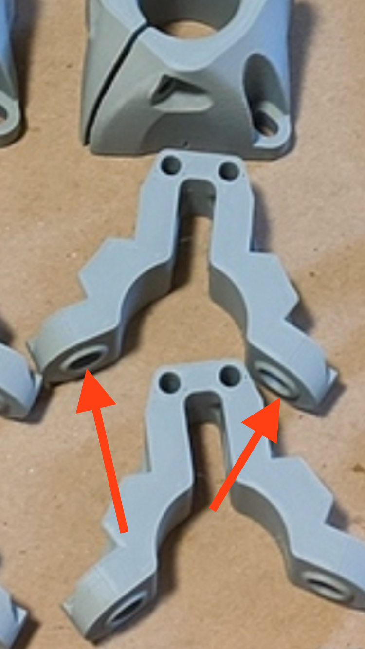

I don’t think you need to remove the core. I tend to stay away from these wrench and bolt type problem solving, because I am all thumbs. But I would just loosen the top and bottom bolts on those clamps (by a half turn), then tighten the spine bolt a quarter turn, and then put the half turn back on the top and bottom bolts. Then check the looseness again.

I noticed it was loose when I put the rails into the core, but I wanted to get it all together and get some pictures taken.
Pulled the core back of the machine over lunch and went through the process of adjusting its clamps. I think the confusing part in the instructions was this:
  • Slide the rail in the assembly.
  • The rail should have slight tension and feel good with no nuts in place.
  • All the bearings should be making contact.
    • If your rail is loose or too tight there could be other issues.
This implies that it should be basically right one I slip the tube in, but mine were really loose. I had to fix it by repeatedly loosening the bolts holding the clamp to the core, tightening the tension nut slightly, then retightening the other nuts. It took about 20 minutes of this to get all four of the clamps to hold the tube without allowing it to wiggle around. All told, I didn’t put more then about 1/4 turn on the tension bolts to get everything to fit snug; I just put it on in about 1/16 turn increments, testing after each adjustment.
I’m curious if this is a side-effect of the 5/16" bolts vs 8mm bolts? Does the extra slop on the bearings due to the slightly smaller size of the 5/16" bolts cause this issue? If I had any M8 bolts and nuts, I suppose I could investigate.
No I test with 5/16. I rebuilt/printed mine many many times and every time they were slightly too tight. I am not sure what could be the issue. That is why I have not done a full release. You are basically the third person building it and you are having drastically different results from me. So design issue or print issue, tubing size issue?
Ok. Weird. I haven’t done any calibration on my 3D printer since I assembled the kit, but I trust Prusa to have done a good job before it left the factory.
Maybe worth a note on the build page about how to slowly inch up on tightening them if they are loose: release bolts, tighten tension bolt slightly, retighten to core, retest.
I have to look at it after shipping. I only ever accounted for too tight. I am not sure how this is going to work now. We’ll see how the rest of your build goes and wait for a few more. It is designed as a interference fit, so you having to add to it might not let you properly square it.
All four of your clamps were loose?

I had to clamps that were loose, one on each access. The other two clamps were fine.
And yes, it was all printed in MH Build Series PLA.
Which two fit? Something seems fishy here. I would expect all to either fit or not.

Did you put in one bolt at a time or both at once?
Just trying to figure out how this could be this way.
45% infill?
I put in both bolts, then tightened one then the other. Prints are 45% infill on the clamps and 30/70/30 on the Core.
30/70/30 or 70/30/70 as recommended for varying infill?
Yeah, that. Got the numbers backward.

Would sanding a tad bit off of each of these bearing surfaces be an acceptable fix for his issue?
Try tightening each bolt a bit at a time instead of one then the other. Any tradie will know this as you risk cracking when you fully tighten one and then other, especially plastic boxes.
I’m well aware of that, which is why I worked my way up to the proper tightness on the tubs in such small increments. But the instructions for installing the clamps say: “Insert the top bearing and bolt first, then the bottom.”
First movement! With the tension issue resolved, I hooked up the steppers and endstops and gave the motion control a try. And everything worked on the first try!
