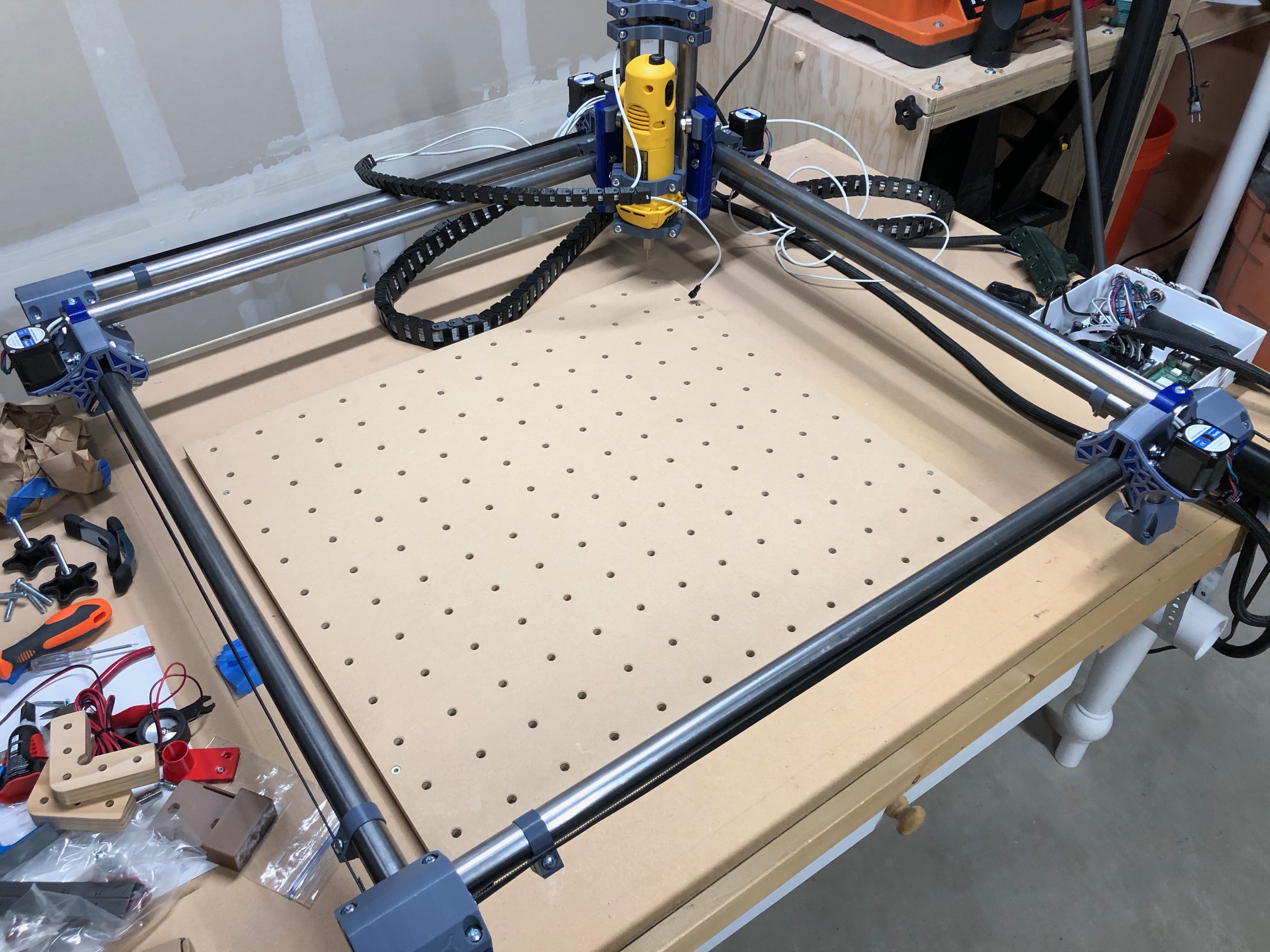

Tightened the tension bolts a little at a time like I described above. It eventually reached a good feel and I went with it. Everything seems to be moving smoothly, but I haven’t run it through any serious paces yet to try it out. That will have to wait until after dinner.
With all the electronics hooked up, I went through the process of setting up the endstops and determining the offsets to square up the cuts. After tweaking the end stop locations, I was able to get the full 24"x24" range of motion. Final step for the night was mounting the new spoil board. With this, I should be ready to make sawdust tomorrow night!
Obviously cable management is still an issue. But I have to figure out how/if the cable chains can be attached and still function with the limited space.

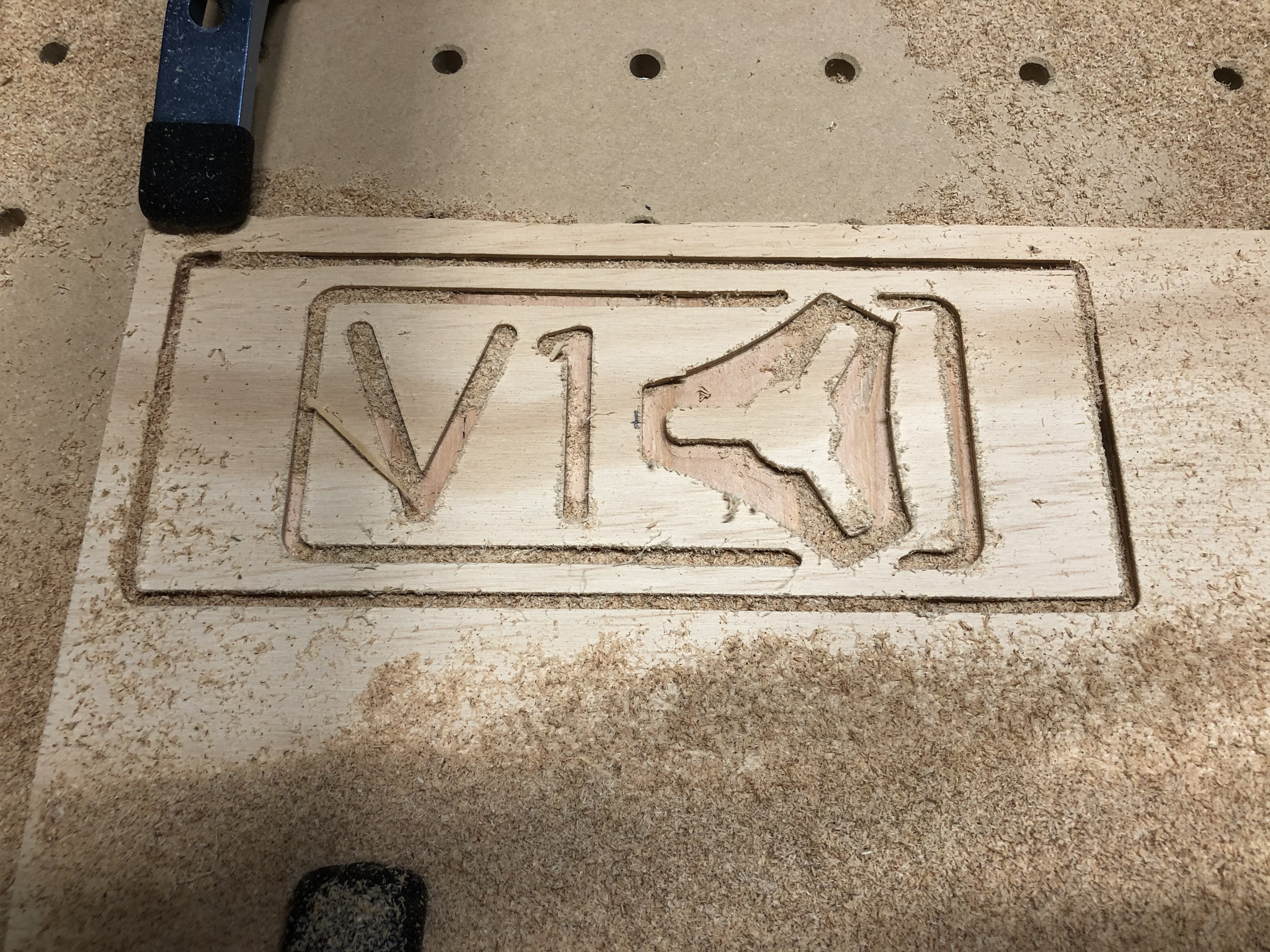

First Cuts! Made up a quick cutting job in some 1/4" plywood I had left over. The machine cut through it like butter, and now I have a sign I can mount next to my Primo so everyone knows who is responsible for this beautiful machine.

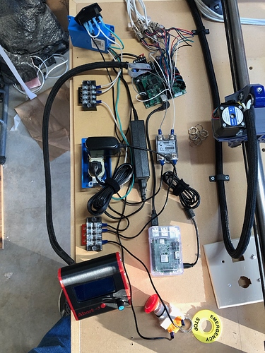

After proving that everything works, and getting a few production cuts done, I decided it was time to redo the wiring for everything. I unplugged everything, took the Rambo and RPi out of there case, and started wiring everything up on a piece of MDF. The goal is to ultimately build a case around all of the parts to keep the dust away, but first I needed to get the wiring sorted.
Finally used to the power inlet switch I bought from Ryan for the original MPCNC build and wired it along with the e-stop and Solid-State-Relay (SSR) into the outlets. One outlet is inside the box and wired to provide a place to plug in the Rambo and RPi power supplies. The other is at the box of the box and faces outside for the Router/Vacuum. It is wired through the SSR to allow the Rambo to turn the router on and off as needed.
I still need to design and print a stand off to hold the Rambo up off the board, and make a clip to hold the power supply in place. I have the case design in progress. Will need to use the MPCNC to cut out parts so that the aircraft connectors I used for the steppers and endstops can be attached. But I’m hoping to have the entires enclosure done by the end of the week.
Steps 2 and 3 of the re-wiring process are complete. Got the relay hooked up so that it will activate with an M3 and deactivate on the M5. Using pins 2 and 4 (ground and enable signal) of the Motex2 connector on the Rambo. Took a few tries to get the marlin settings eight so that the signaling was correct. Initially it was turning on on M5 and off on M3.

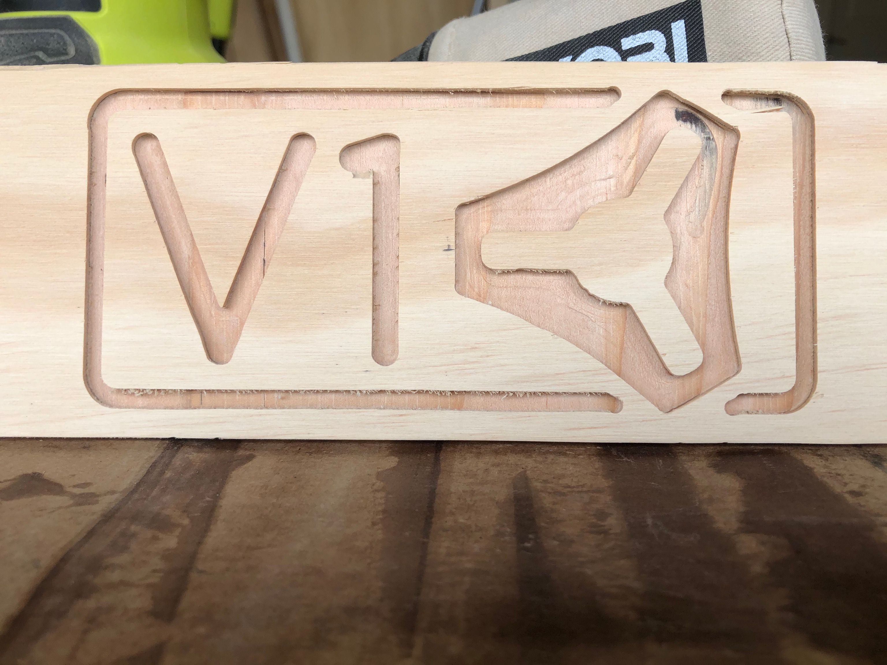

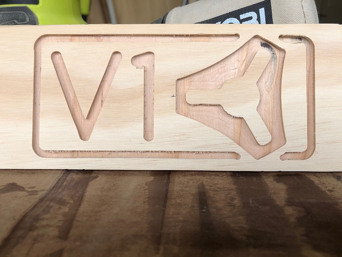

Spent the day finishing up the control box. Had some spacing issue on the backplate between the power inlet switch and the outlet box, so I rebuilt the back end of the box. Moved the outlet close to the middle, and left more room for the inlet and switch. And, since I tightened up all the belts and re-tensioned the core, the result was way better than the previous attempts.
This job took about 13 minutes to cut, and only about 10 minutes of sanding to cleanup all the fuzzies. Aviation connectors fit like a glove this time, and the opening for the electrical box only needed minor adjustment with the box cutter to clear out some cut cut pieces.
For anyone keeping score, I have fusion setup to use the 3mm (not 1/8" like it claims on the package) bit and run it at 1000mm/min (~16mm/sec) with a 6mm DOC. The trochoidal clearing of the connector recess isn’t nearly that fast because of all the ups and downs of the Z-axis, but once it starts cutting the holes for the outlet, switch, and the outside cutout, it flies. Only artifacts of that speed are the slight divots where it stops to leave the tabs.
