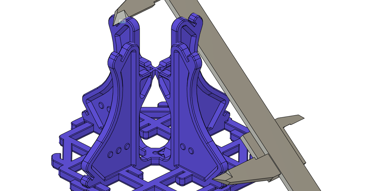

For your concern over Z, I’d recommend not the califlower print test, but rather the (for-purchase) one called calilantern.
Here are two links for where you can get it:
Yes i did that one. Thanks
