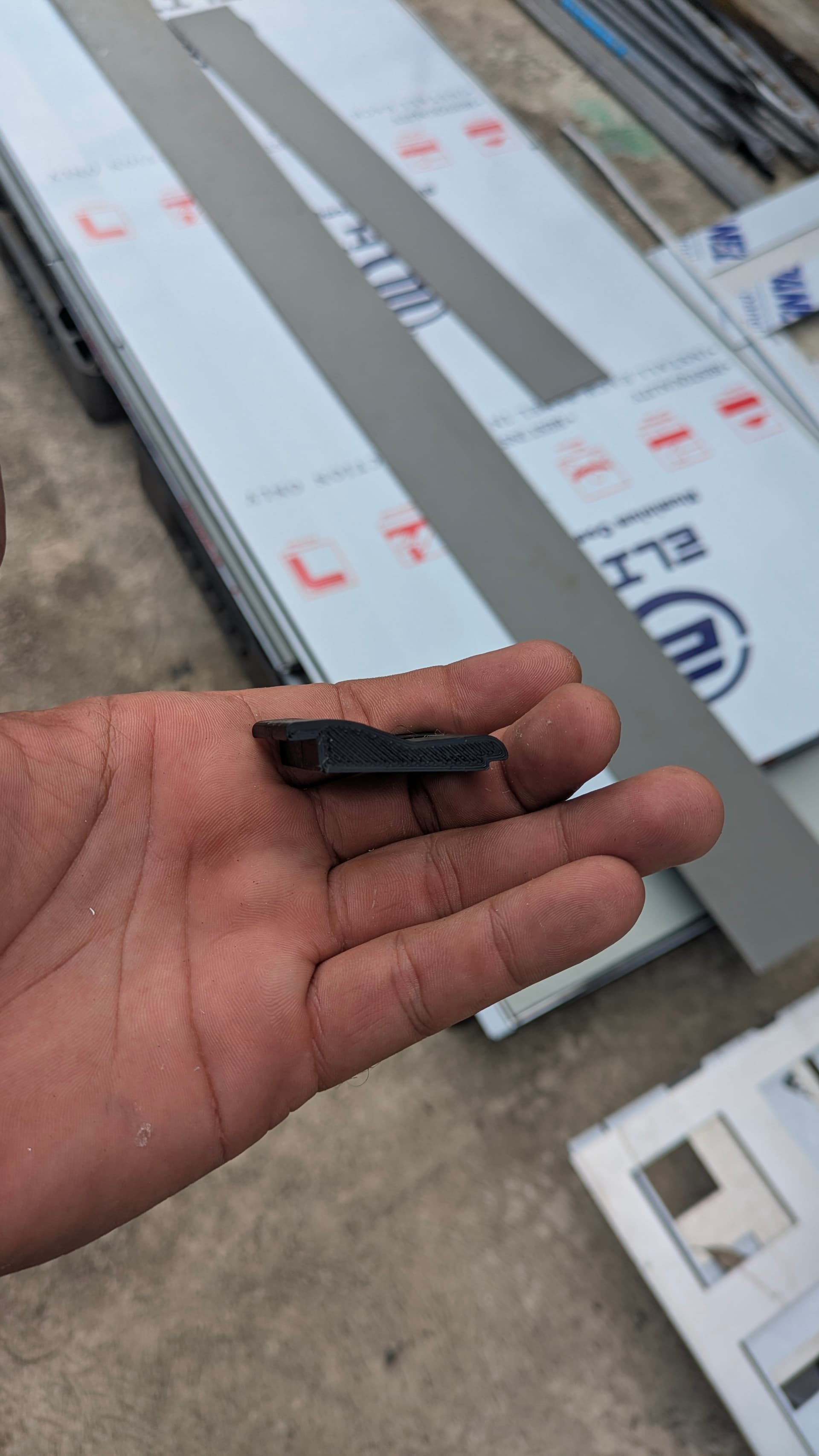

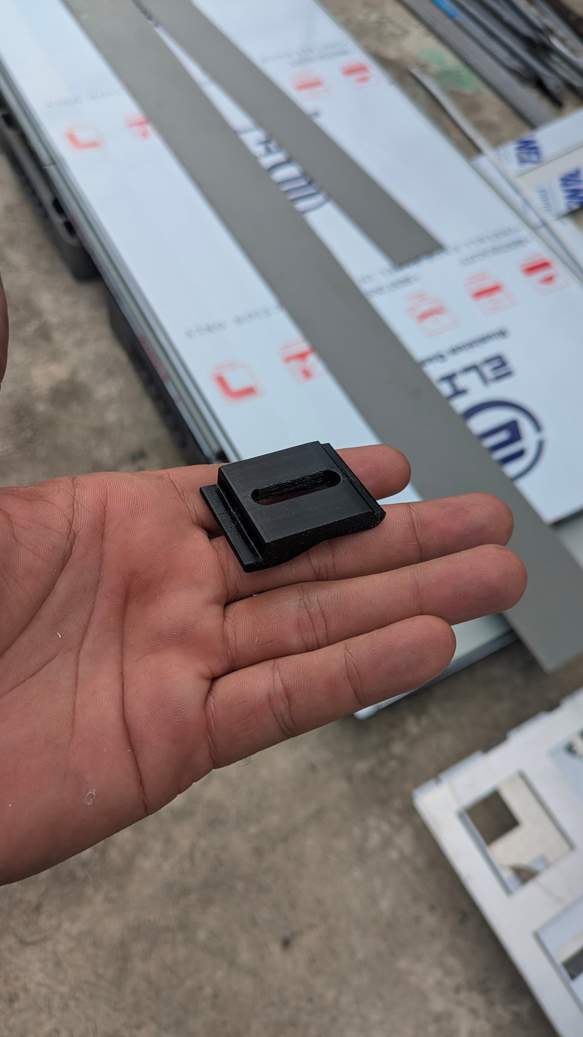

Yes, tools today uses one on a vacuum table too. Just keep the table well sealed and have some toeclamps available, with a shopvac you are going to loose vacuum really fast. (I use 3d printed -bit safe- clamps). Usually not needed but at the acm pricing, its better to be safe
Are you using 8x4 ACM sheets? if so how large is your bed so that you can use toe clamps?
I made some plastic ones
My table has 2.5 inches extra all the way around
