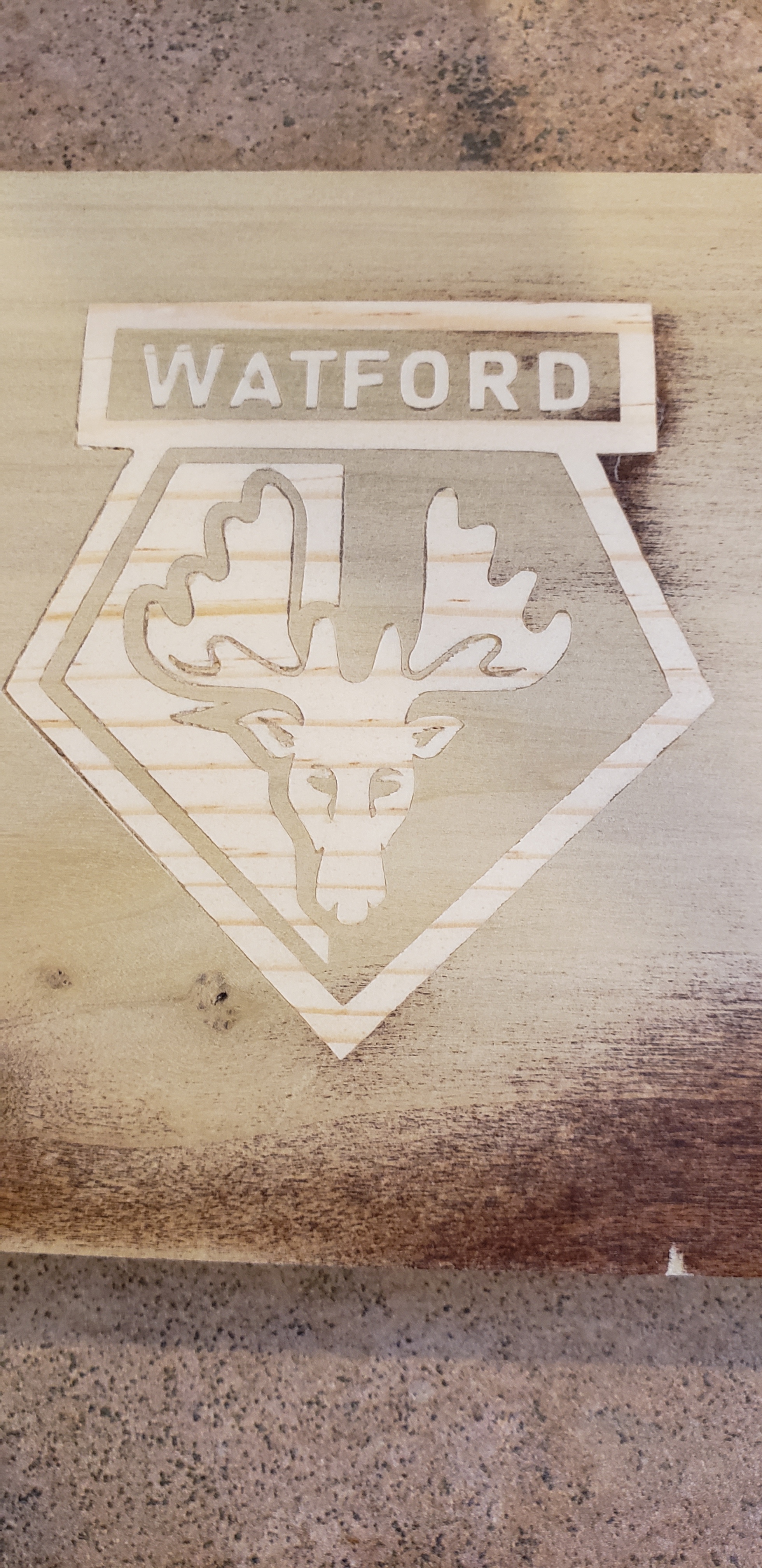

Concatenating a file at the beginning wouldn’t be difficult. I usually don’t start the file until after I have set everything up. I use have the dual end-stops, I zero x-y then I have a known stop where my work piece is placed. I have created buttons in Octoprint that move the head to the know x and y then
zero there. Depending on where I want my start I may index out from that point. I also use a zprobe, again I have a button that I press in Octoprint that zeros and sets the z height (19.3 in my case). Once I have done that then I start the gcode.
It does already do a tool change between the v-clean and the clean files. I didn’t create a separate file for it but there is a line you can put in there. I created a pause in the code. If you look at the output from finished gcode file, if you have specified a “clean” file there will be a tool change too.

Thanks. Your second order(start-main-vclean-tool-clean w/optional end if it is not too difficult) is what I’m looking for.
I’m thinking the “end” code would just display something like “done” on the LCD for those w/o octoprint.
I guess sometimes it takes a different perspective: I’m not sure why I thought it had to be main then clean, then v-clean last order (maybe the scorchworks video?), but I have been changing tools after the main, then changing back for v-clean. Your way is better because there is only 1 tool change vs. 2 and it clearly works great. So… I feel a little silly.

OK Alex, give that a go. I replaced the first version with the new one that allows for beginning and end file to be added.
Let me know what you think.
I have finally redone this one. Now using my script to prepare the files it works like a champ.
I am pretty happy with the final result.

Here’s a quick view of what I am working on Inlay overview
