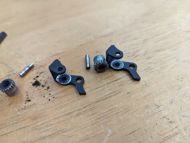

Both of my H2 extruders crapped out. Emailed BTT, pulled the extruders from the shop.
If you saw the printer at RMRRF this is what was causing the extrusion issues.
Jim, I should I cancel your order or just remove the H2? Wanna wait on the order to see what is going on?
That’s crazy! One of my H2 V2S Lites is starting to make some not so happy sounds every so often as well. Scared to take it apart and see what’s wrong lol.

Every time I wiped the bed on #1 it had black dust on it, I was going nuts trying to figure out why…now I know.

Looks like that filament drive gear could use some needle bearings on either side. Yikes!
