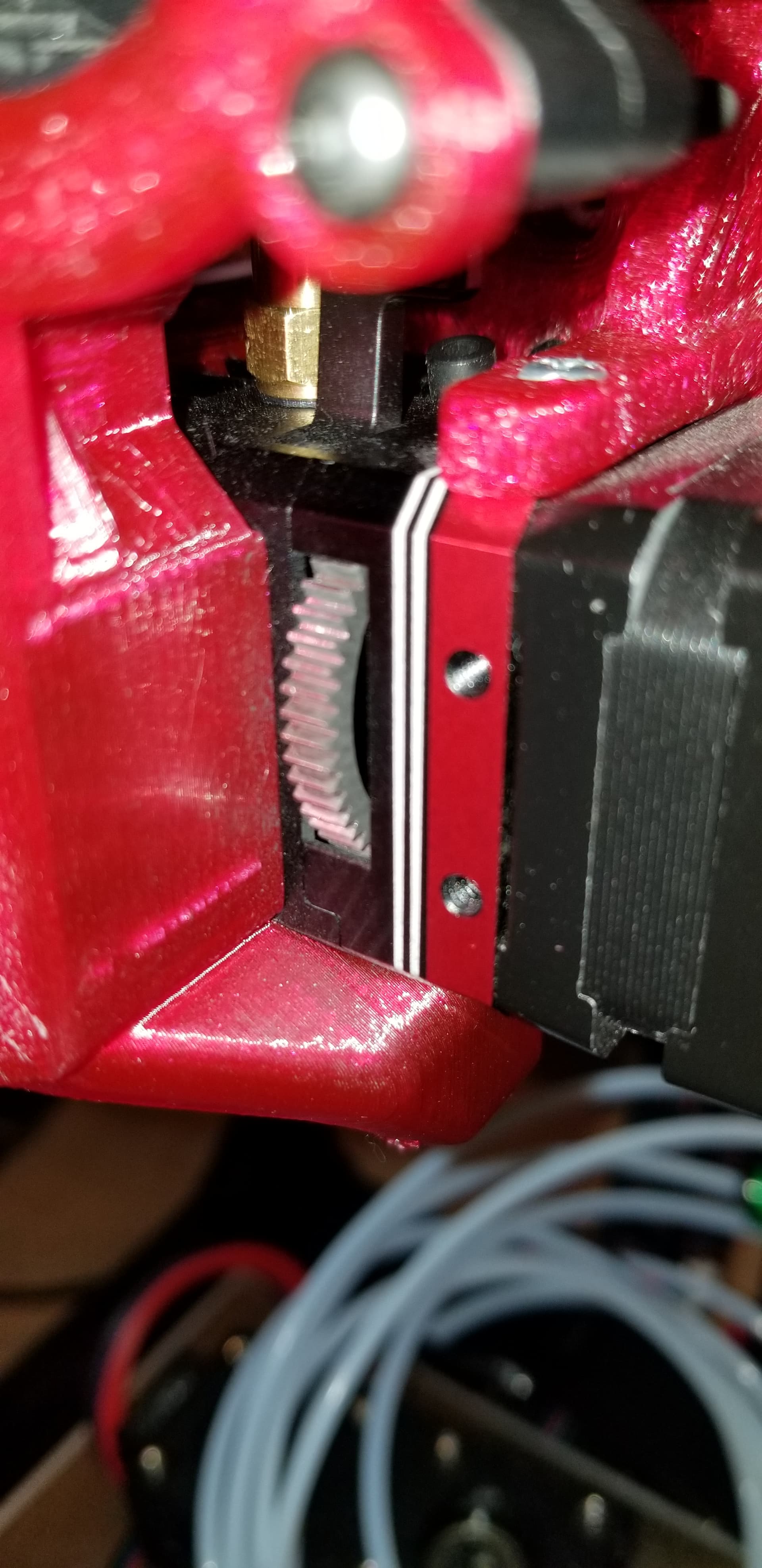

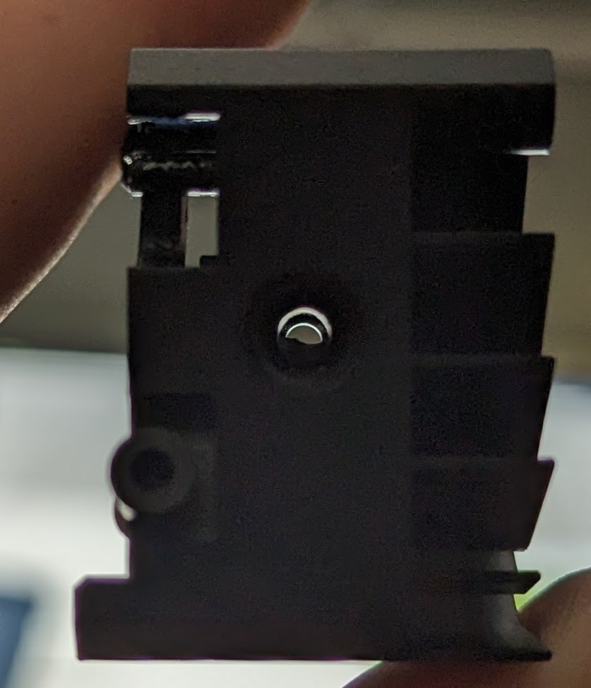

Yeah, the gear has a nice needle bearing it, but there is nothing on the outside. The odd part is why is it pushing so hard into the lever/holder, the filament groove should keep it centered so it must not be in the center. My guess is it is a bad design and BTT does not have a fix. I should get a response later this evening.
Oh, I was ASSuming black dust was filament debris.
Will tear down and lube stuff I guess.
I just pulled apart a new one, no lube whatsoever on this needle bearing at all, the other bearings are lubed. I am going to put it together with some fancy lube and see if either lasts a little longer while I wait to see what BTT says.
Well, that will never work. The issue is explained. Unless they have a new internal part these will never last long. With a little fiddling, I think it stays centered now. Not sure what is going on here.

Had this same thing happen on my Revo H2. They sent me replacement parts with the exception of the pin (save that!). I figured out that I had adjusted the tension too far and put some side strain on the lever.
That is crazy, yours has worked ever since? Both my tensions are set at the loosest position.
That’s how its been set since new?
Yup, it said pre-set, and the steppers skipped before the filament so I never added any.
Then too tight shouldn’t have been an issue for what you ended up with that’s for sure. I have never adjusted either of my Lite’s I need to pull the one on the V4 apart and see what it looks like inside. That’s the one making the noise.
Yeah I thought my rail bearing were crapping out, nope that noise was the grindage.
